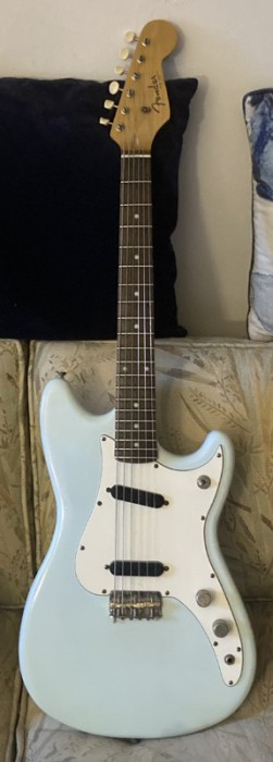

well, the annoying finish problems are almost sorted. some gentle and careful polishing toned down the aging tint on the Duo Sonic made it more realistic, and feel better to the touch as well. matching the blue didn't work, but i was able to get the added paint off with careful use of swabs and rubbing compound. so it's as done as it's going to get.

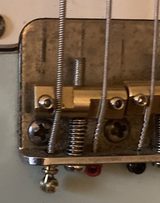

worked on the Duo Sonic some more. it needed heavier strings so i went out to the local shop and wound up with D'Addarios .012-.052 with a plain .020 G string. i'm generally not a fan of their strings which i find a bit too hi-fi, but they sound absolutely wonderful on the DS. perhaps due to the short scale, the sounds of the pickups are less drastically different than on longer-scale guitars...the transitions from one position to another or from bridge to neck are much smoother. the guitar's oddly mellow sound and switch-position consonance ironically would make it perfect for jazz, and it makes me look forward to getting the Byrdland done. the one hang-up is that the distance from the mounting hole to the saddle of the low E string is shorter than the amount of extra winding at the ball end, so that string was impossible to intonate. i solved this using a trick i'd used on acoustics before, placing a trimmed-off ball end over the string at the ballend, creating that extra 1/8" of room needed for the wraps to stay safely behind the saddle. it doesn't look too stupid. here you can see how the finish was brightened up a bit by polishing out some of the aging tint.
