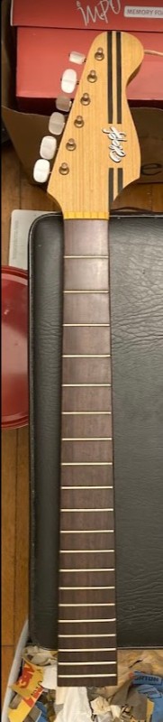

i’m halfway done with the Hopf fingerboard. it’s coming along quite nicely. interestingly, the lower frets go more quickly than the small ones at the high end. maybe it’s easier to get a consistent surface when there’s more room to work. there’s seven frets left, so everything should be ready this weekend at which point i’ll mount the neck to the body. i could string it up at that point and try to
adjust the truss rod and intonate it, at least to the extent possible with a bridge with no individual saddles to adjust . when i need to do the electronics i’ll just have to loosen the strings enough to pop them out of the tailpiece. i think. if not i’ll wait to string it until the pickguard is finished. i admit that i’m really hot to see it as a whole guitar rather than parts and pieces.

i finished the Hopf neck. i'm happy with the result. next i'm going to do the Höfner neck while i have my chops up, alternating with changing the autoharp strings. i'm really pleased that i got it done before i intended to. tomorrow i'll mount the neck to the body so we can see it as a whole guitar.

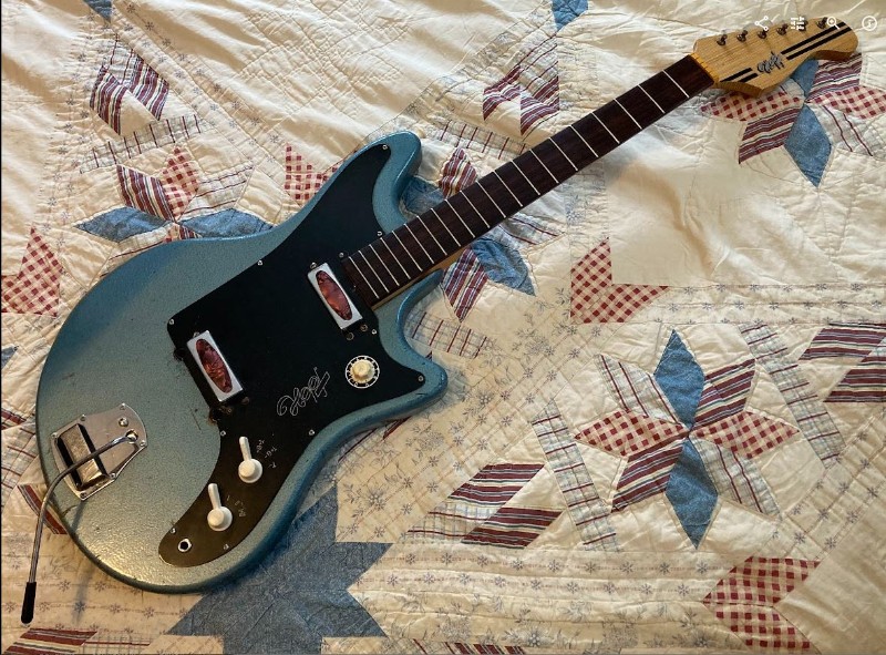

Hopf with the neck on. the original mount was a 3-bolt design, which i filled and redrilled for a standard Fender-sized 4-bolt neck plate when i had the Höfner neck on. in retrospect the reason i couldn’t kludge by with that neck wasn’t just scale, it was that the Hopf is a 20-fret neck while the Höfner is 22 frets. there was absolutely no ambiguity about the neck position, with a straight edge on the pickguard that the flat butt of the neck rests against. you can see scratches in the pickguard where the neck was adjusted via a hex key in the heel. next the guard comes off and i figure out how to transfer over the Jupiter 62 pickups. removed the bad photo; a better one appears below.
Posts: 14972
currently restringing the autoharp, which is a whole other adventure.
Posts: 14972
as promised, here's a better view of the Hopf made back into a guitar. i'd forgotten how utterly trashed the hammertone metallic blue finish is. i'm ordering brush-on clear coat from StewMac to tip into the big scrapes. it's an odd feeling, holding a guitar with a body that's apparently been to the Ostfront and a neck that's NOS. is this what those over-thought Fender and Fender-esque relic guitar jobs feel like?
the bridge studs for the tunomatic i put on are still there. they're countersunk to the top surface so they won't interfere with placing the correct bridge. they stuck out like a sore thumb, though, due to the BRIGHT chrome finish so i dug deep in the parts box and found some enamel hobbyist paints i'd bought in 2013 as part of early Kondor fun. surprisingly, 10 years in storage doesn't seem to have affected the paint in any way, and they pretty much blend into the pickguard which is also black now that they're painted.
i swapped the paddle switch selectors from the Jupiter 62 guard which are in much better condition that the ones on the Twisty. the volume knob will be a bit tricky...the one from the Jupiter is design correct while the one on the Twisty is so wrong that the numbers around the edge run anti-clockwise to the labelling on the guard. i assume a previous owner put a Framus knob on because it was available. the problem is that the Jupiter knob accepts D-shaped shafts, but the volume control on the Twisty has a round shaft so i'll need to file a flat side onto that shaft to accept the knob. aluminum, no big whoop.
the tricky part will be replacing the pickups since the barkier Schaller pickups from the Planets series are a good bit larger (well, a few mm anyway) so some judicious filing is in the works. i believe these guards use a typical German pickup-wiring approach with a single hot conductor from each pickup inside a shielded braid that shunts signal to ground, so it should be simple to splice the control harness from the Twisty to the Jupiter pickups. "should be." write that on my fuckin' urn.
but given the amount left to do and the fact that i can't order finishing supplies until Friday, the rest could very well be done by the end of the weekend, though there's a Valentines' festivity and picking up Becky's adorable new bulldog puppy that will eat some of my "free" time. i have to balance my need to Have Stuff Finished with the need to take care with all this. waiting for the clear coat to dry will drive me batshit.
having checked because it seems so small, the Twisty will not fit the Mustang/Jaguar flat cases only because the upper horn is too long and i'd have to take out a piece of the divider. so Strat case it is! an important milestone in the life of a guitar project is when it's put together enough to get its own hard case.
fan note: yes, that is the quilt from the 2012-13 photos. the present-day artist refuses to needlessly replace stuff!
