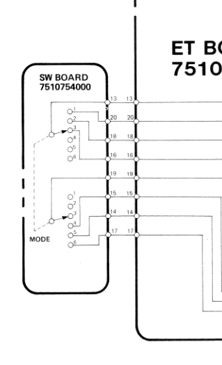

Don't worry, the PS-2 has a real mechanical switch for the six modes, not this resistor value dependent switching system. This is from the PS-2 service manual:
Screenshot 2025-01-25 at 00-55-51 roland_ps-2_ET.pdf.png (44.69 KiB) Viewed 1160 times
