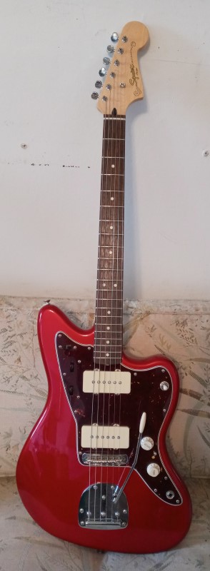

here's the Jazzmaster after various types of tweaking, adjustment, and replacement of the plastic parts. you can see how much better the tortoise pattern shows up with the lighter parts. i did a mod on the rhythm circuit so it works with all three toggle switch positions. i'm probably going to buy the set of 1965 Jazzmaster knobs, because cool knobs. it's now at the point where i can stop monkeying around with it and start getting to know it. doesn't it look happier now?
before.
before.
after.
after.

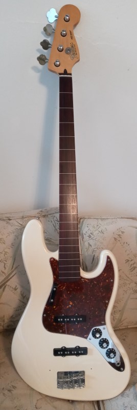

so in the meanwhile, feeling too tired to do the filing of the nut and saddle for the Epiphone, i turned to working on my Jazz Bass. it's a MIM fretless of indeterminate age, and acquired a nasty bow in the neck because i was using super-heavy flatwounds...i think the G was .060. so i took the neck off, let the truss rod all the way out, and let it settle for a few days, then tightened it up as far as it would go to try and get things straight, and finally let the truss rod out about 1-1/2 turns, which gives some room to adjust. it's pretty straight now. i ordered LaBella "low tension" flats, which seem like a good compromise between heavier sets and the .040-.090 sets Ernie Ball sells. only 135 lb. of string tension, which really isn't a lot.
the nut was broken and cut way too low, so much so that there are little grooves in front of the nut where the strings were in contact with the fingerboard. happily, Jazz Bass nuts are quick and easy compared to guitar nuts. once i string it up i'll fine-tune the slots. yet again i have to wait for parts...as i was about to string it up i noticed that the bushing was missing from the G-string tuner and since they don't sell individual ones i had to order a new set which allegedly will be here by Saturday.
i swapped the knobs for Fender amp-style knobs. they're far easier to read, and i felt like the bass needed some 1970s ghetto bling. when everything's together it will have the bridge cover and the cover that goes over the neck-ier pickup. i originally put them on trying to recreate the sense memory of the fretless JB i learned on in the City College of SF Jazz Improvisation Workshop, and then discovered that they serve as useful shielding from RF interference with the pickups.
i'm trying to figure out how to make a stand-up extension like the old Gibson EB-2 which had what i always called a "pool cue-stick," a dowel about 12"-16" long that screwed into a thread-tapped strap button. i love to play electric bass vertically, especially fretless...i sometimes use a milk crate. the fingering, sustain, and decay are totally different.

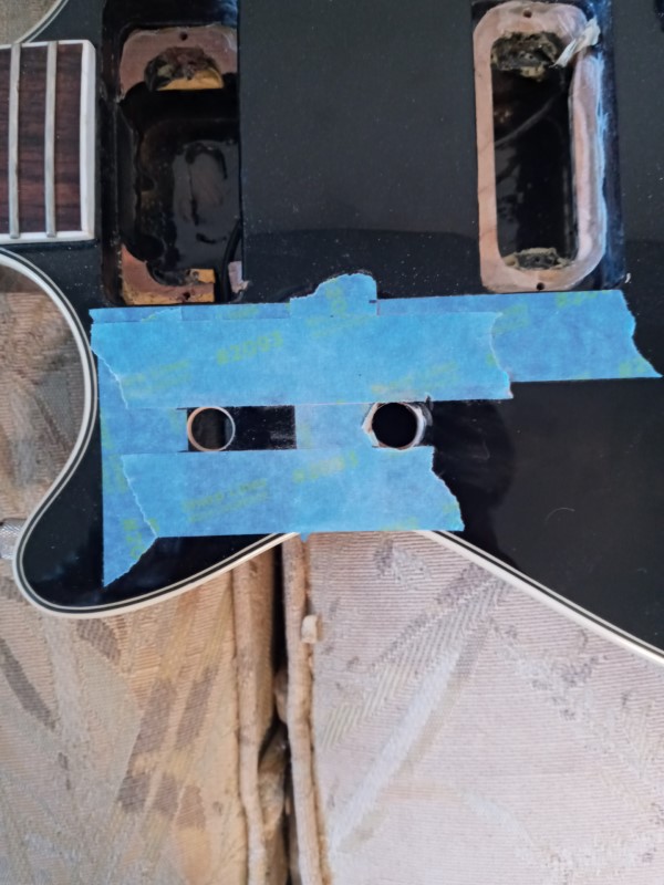

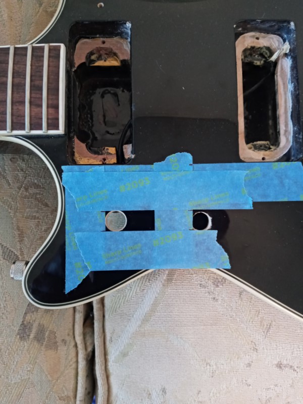

i started on the Double Jet again on the premise that all the parts had arrived. the first order of business was to finish the hole in the top for the tone switch. as i had feared, the hole migrated to the outside as i tried to ream it out by hand:
i had a go with one of the grinding bits on the Dremel and got it close, but not quite right. followed that up with the 1/2" drill bit and it's ugly, but effective:
see here that the washers are aligned with the general N/S orientation of the guitar:
remember, kids, washers cover a multitude of sins.
