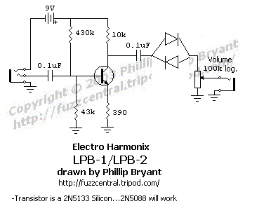

I think it would be difficult to achieve as a standalone gate as it is not really a noise gate in the usual sense; It is tied to the distortion circuit and I suspect it is achieved by rectifying the signal into heavy crossover distortion. Doing so is a trick used to reduce noise in high-gain designs such as the HM-2, it doesn't let signal below a certain voltage through so background noise is killed but with heavy artifacts (the crumbly sound you want). I think it would be totally doable "clean" though if you took a clean boost and just added a rectifier and maybe a second recovery stage afterwards. I'm just pulling this out of my ass but I think this is how it would work:

Yeah, I checked mine and my guesses were wrong, it seems to be changing a limiting resistor at the non-inverting input of the first op amp (this is a thing on muffs too http://www.kitrae.net/music/Big_Muff_Mo ... _Page.html) so that's why it is unique for this circuit. I'm not knowledgeable in how TL072 behave so I can't telly you why this happens. One idea may be a Demon without clippers and the tone shaping in the gain stage feedback loops removed or reduced to basically flat. You could even remove half the circuit and have a TL071 distortion+ without clippers made

Update, its not the resistor I thought it was, I checked. It may be more difficult to achieve as a standalone effect
