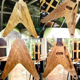

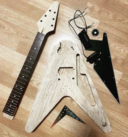

As I mentioned above I decided on building another Precision Guitar Kits project.
In stead of going custom I went with one of their stock kit deals on a 58 Korinia Flying V https://precisionguitarkits.com/product/v-type
What I got was way nicer grain-figure-wise than I expected, the body has all the curl and flaming on the edges where it looks like oak :thumb: Before it arrived I had thought about finishing it in charred black stain but once it arrived I just wanted to oil it.
It's in the curing stage ATM with 3 coats try-oil and one of Tried and True Old Fashion polymerized beeswax as a sealer coat.
So the plan is black pickguard, chrome hardware and knobs, so the "look" is like a 70s fender/musicman :lol: I've also ordered a fender style decal that says Groovy [for extra 70's + Evildead vibe] that I might use if it turns out..
Electronics: I took the Black Winders out of my epiphany Sheridan II [and put the stock pickups back] and am planning on having VVT but jazz bass wiring instead of gibson with both volumes as push/pull for series/parallel with a normal 3 way toggle

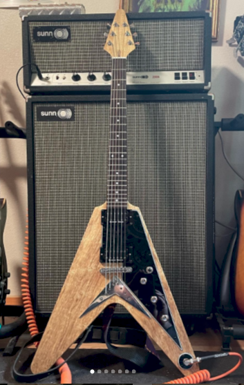

Still haven't received my decal.. don't know if I'll use once it show up.. I'm too happy with how this turned out
I went with a more standard wiring layout of a Jazzbass with a switch. The thing resonates so much! and the neck pickup is usable in this guitar where the same pickup in another was too sludgy for most things..

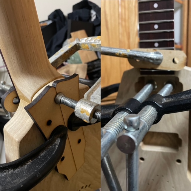

How hard is it to glue in a neck if you have zero woodworking skills/experience? Did the body & neck come mated well enough that's it's just like, apply glue, clamp, wait? These kits look pretty nice.
Blackened Soul
Posts: 4768
Re: Precision Guitar Kits Are Awesome Thread
Post by Blackened Soul »
the_carl wrote:How hard is it to glue in a neck if you have zero woodworking skills/experience? Did the body & neck come mated well enough that's it's just like, apply glue, clamp, wait? These kits look pretty nice.
Fit was very good, I wouldn't say any working was needed on with either of the 2. You do want good metal clamps to get enough pressure.
You might have to do some sanding if you want the heal to be seamless, if you don't on models like the V, X maybe SG they don't bring the edges of the body where the neck heal meets to a feather, I think they expect you to do that if you want. I didn't see a need for my needs... Still you don't really need to sand the things depending on the finish type you use, I pretty much just used a ultra fine scotchbite [similar to 0000 steel wool] but.. I wanted this to have where it feel like wood..
Here is a picture of the glue up

Yeah, that really doesn't seem too bad. Will definitely keep these guys in mind - thanks for putting them on my radar!
