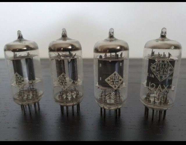

Blood_mountain
Posts: 1051
Re: 12ax7 Tube Question
Post by Blood_mountain »
These are them:
Dandolin
Posts: 11125
Location: On the pharm in PA
Post by Dandolin »
purty
60 bux a piece, or for the quartet?

Blood_mountain wrote:These are them:
Those look like clean ribbed plate tubes, typically very decent and a joy to listen to. If they haven't been completely worked over.
I assume the $60 CAD is for one, if it's for the quartet you should probably just fucking buy them.
Preamp tubes do typically enjoy much better longevity than tubes that have to work hard. That said, they can go microphonic (via abuse while hot) or suffer filament failure, in addition to more visible failure modes.
Blood_mountain
Posts: 1051
It's $60 CAD per tube, and he just has two left. He said they've been tested with a pal's tube tester and they tested very strong with no gas or shorts. What should I ask specific to testing? I've read things like 59/60 but I don't really know what those numbers mean
crochambeau
Posts: 2219
Location: Cascadia
Post by crochambeau »
Blood_mountain wrote:He said they've been tested with a pal's tube tester and they tested very strong with no gas or shorts. What should I ask specific to testing? I've read things like 59/60 but I don't really know what those numbers mean
It's probably an emission rating. 59/60 is pretty even on both sides, so the tube is fairly balanced between the halves (again, probably not a concern in a pedal, but nice to know if you're planting this in the front end of a tubed integrated amplifier).
Test fine with no gas or shorts is about all I would concern myself with. You will not get meaningful characteristics from numbers (just my opinion), just like saying "yeah, the tires hold air just fine, and have a decent amount of tread" does not equate to mounting the tires to your car or bike and then finding a fun road to drive.
The type of tube under question is one I have experienced and found to be a decent one for my applications. I probably wouldn't plant a Telefunken in a pedal (my only tube pedal is nothing to write home about though) but only because I would prefer slotting that into a bigger fixed piece of furniture. Is that the same as saying these are a better use of the funds than two or three more pedestrian oldies? Hard to say. I would think that if you're comfortable swinging the money at it, they are a fine example of a vintage part. (assuming working order and honesty on part of the seller)
One of these years I really should do an extensive shoot out with older stuff and newer stuff and veer speculation closer to raw experience. I understand there are decent tubes enjoying current manufacture...
