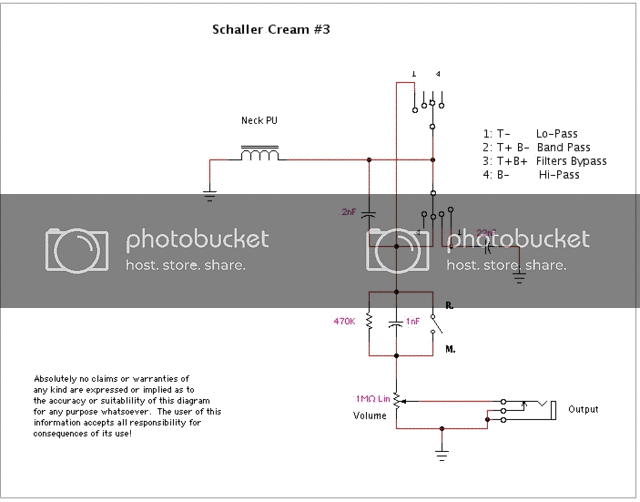

Schaller schematic--the value obscured by the Photobucket logo is 22uF:

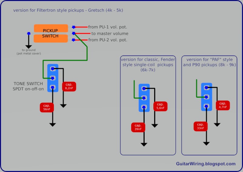

Gretsch schematic--includes alternate values for hotter pickups than FilterTrons:

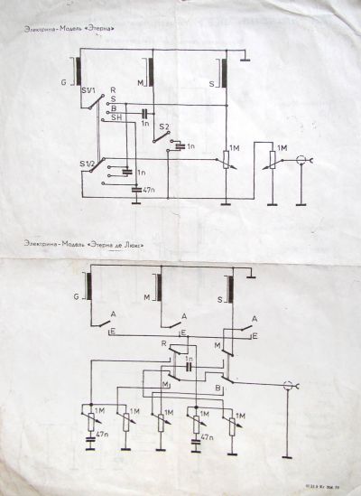

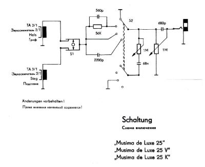

Musima schematics:
this is the circuit from the De Luxe 25 like the one i have that's in pieces:
this is the circuit for their archtops:

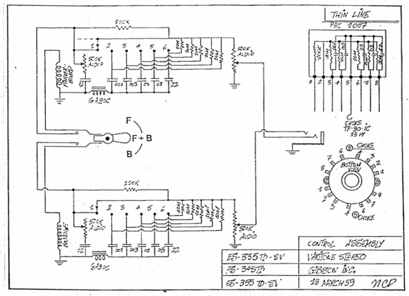

and finally, this is the Varitone. it's hard to read, so i found the component values on another site:
which are:
BYPASS
0.001 µF
0.003 µF
0.01 µF
0.03 µF
0.22 µF
plus a 15 uH inductor (labeled "choke") which apparently makes it into more of a notch filter.

i'm having a hard time finding videos of Musima guitars with the tone switch, and for guitars with the Schaller circuit. i KNOW i saw a Musima clip. from what i've seen that circuit is quite good. i think the 22uF cap in the Schaller circuit is waaaaay too big...when i engage the T- position on my Hopf it sounds like you're at the bottom of the sea, and not in a good way.
