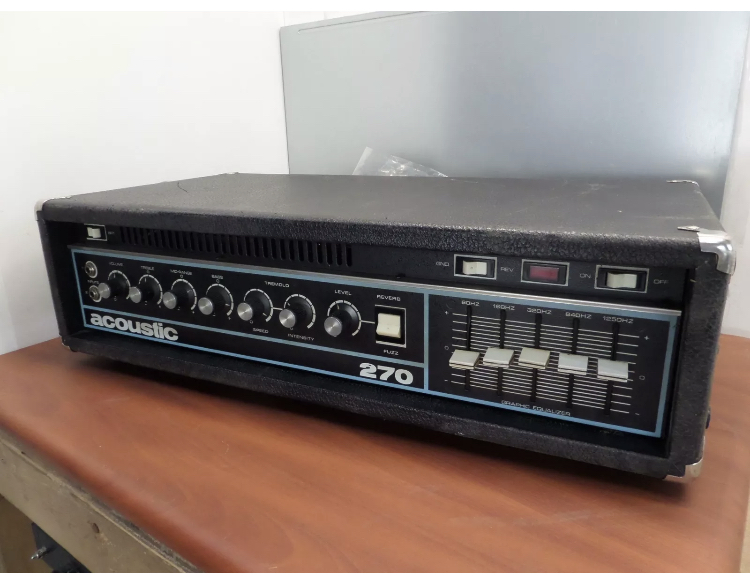

I got this vintage beast today, and when doing a bit of reading about it, came across this info: "Designed to run comfortably at 375 watts at 2 ohms".
Holy shit.
Am I going to blow everything up with this thing? Anyone have any experience or tips pairing it with a cab?

Two 4-ohm cabs is the equivalent of 2 ohms! And running the amp through cabs with higher impedances won't hurt anything. It'll be less efficient at 4 ohms, but still probably plenty loud enough. You won't blow anything up! I have one, and it sounds great through a typical 4-ohm 4x12. That said, Acoustic cabs can be found really cheaply all over the place, if you just want to track down a matching 2-ohm cab.

That's just marketing talk meant to say that it's designed with two ohms in mind, you don't need a 2Ω cabinet to make it work.
Furthermore, while I understand Acoustic amplifiers are highly regarded, at least in some circles, I would not take that to mean that the amp prefers working into 2Ω loads, especially for low frequencies. Just run the cab you've got without rewiring it. I'm a fan of sticking with 8Ω when running solid state, so those times you decide to live it up and hang two cabs off your amp you're still only loading the amp up to 4 which will sidestep thermal cut-out or actual failure in the output sections (and be warned, a lot of Acoustic amplifiers are NOT well documented on the schematic side of things and are therefore more challenging to your neighborhood shade-tree tech).

Thanks for the responses everyone! I took it to a local music shop and ran it through a 4 ohm cab. I bought this thing as-is for super cheap, knowing only that it powered on, so I was happy that it seems like everything is in working order minus some scratchy pots.
So that said, I'm planning to give it a good internal cleaning, but having a quick look at it last night it wasn't immediately evident how to get it apart. Tips?

I never opened it though, and could only find one picture of the guts. From what I can see, the screws holding the inside to the outside are on the sides, so probably remove those and carefully slide the amp chassis out forwards or backwards.
