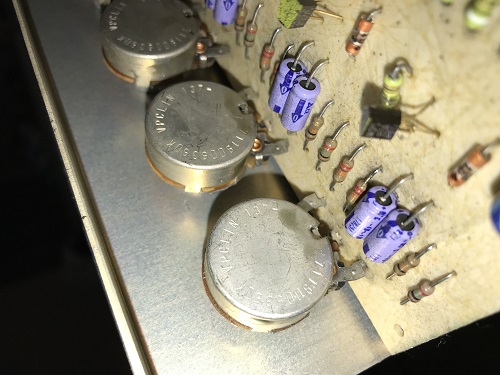

by JonnyAngle
I have a Peavey PA 100 that needs new pots. The old pots are huge and hold part of the PCB in place. I can't find the proper replacement pots, so I'm going to use jumpers. Any suggestions on holding the PCB down?
Looking at the pic they seem normal, but there is a 1/2" spacer that's part of the pot. The actuators are green plastic. Funky!

Do all the pots need replacing?
Can some of them just be cleaned?

DRodriguez wrote:Do all the pots need replacing?
I used a can of spray and it’s 50% better. Uneven tension, grindy, still staticky.

I recently had to offset another mounting point inside of a build, and to do so utilized the pots as mounting points for structural members. You could do something similar with a hole punch and some old beer cans.

crochambeau wrote:I recently had to offset another mounting point inside of a build, and to do so utilized the pots as mounting points for structural members. You could do something similar with a hole punch and some old beer cans.
I think this is how it’ll go down.

I thought those parts were five leg with the outer two being just structural? Hard to see in the pic, but that fullcompass part didn't look like what I had envisioned.

You're thinking of the peavey spider pots, those had the structural 4th leg.

For potentiometers you have to use TUNER SPRAY! :success:

Yeah, I always assume this is known, but pots want the stuff that leaves a lubricating film (and modern pot composition can offer up compatibility issues) and switches/tube sockets want "contact cleaner" which evaporates residue free.
Pots have finite lifespans though, eventually they wear out. Crunchy pots blow goats for anything other than harsh noise.

I cleaned a more than 45 years old ultra scratchy potentiometer of my dad's old Grundig HiFi amplifier with tuner spray. This was more than 5 years ago. It works like new ever since then without the slightest crackle. In the last 10 years I haven't had the need to replace a potentiometer, except it was really broken due to high pressure or other accidents (that have happened to the previous owners).

Pepe wrote:I cleaned a more than 45 years old ultra scratchy potentiometer of my dad's old Grundig HiFi amplifier with tuner spray. This was more than 5 years ago. It works like new ever since then without the slightest crackle. In the last 10 years I haven't had the need to replace a potentiometer, except it was really broken due to high pressure or other accidents (that have happened to the previous owners).
I'll see if I can get some more cleaner and keep going at it.
Full compass says they can get the exact pots. Peavey says they can't, so we'll see if I ever get an order confirmation email!>!>!>!

Whatever they have at the hardware store. CDC qd contact cleaner was what I used
