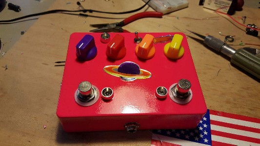

Colin from experimentalists anonymous has a pedal called the Parallel Universe 2..
http://www.parasitstudio.se/uploads/2/4 ... iverse.png
Layout by Fredrick Lyxzén - Which is basically that. It's a 386 and a Tl072 with some extra goodies. I built one and it rips. Lots if fun
But yeah, just buy a commander. It's dope in its own right.
