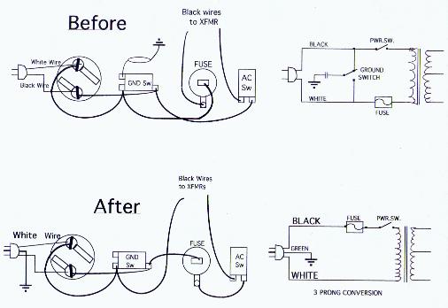

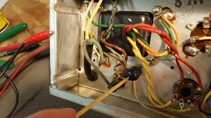

Now that the disclaimer is out of the way, this is the death cap. I think its a .48 if memory serves.. this is a 74 Fender Champ. Stock, the cap goes from the fuse to chassis, and also on some amps the hot wire (black) goes to the switch, then the trans, then the fuse...which is bad news bears.
You want to make the circuit look like the "after" in the diagram (botom right). If it has a courtesy outlet and/or ground switch, you can leave them in or remove them from the circuit. A Champ has neither, but when I did a Vibrolux I had, I left both in place physically in the amp, but neither were wired to anything, totally bypassed.

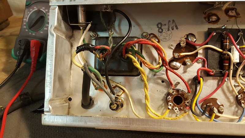

This is when it was done. ground wire to chassis at the transformer mounting bolt, hot to fuse, fuse to switch, switch to trans, and trans to neutral (white). All said, from start to finish it takes about an hour. Just be careful and take your time.
This is good practice on an amp, but that said, if your amp has never been serviced, it could still hum afterwards and need to have a cap job. But start here first.
