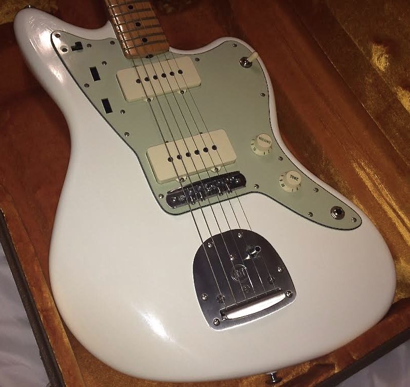

I've used a Mastery for several years and I love it. Extremely solid/stable bridge and setup is simple. I don't notice much change in sonic character, still sounds and plays like a Jazzy imo. I also added the Mastery tremolo last year, very smooth and looks fantastic but probably overkill for me.
The Staytrem is great too, have one on my Bass VI. It's a little less expensive than Mastery as well.
As far as price goes, both are generally direct ordered from the manufacturers so not much flexibility there.

Yep, it's a direct replacement. Check out the Mastery site for a breakdown of the design tweaks. There's no lock mechanism on the Mastery but I never really use that feature anyway and it def has a smoother feel than the stock Fender trem. You can get them polished or brushed but I went with brushed as it matched my bridge and my guitar has a little older look to the finish overall. Brushed just looked right.

Holy Schnikes wrote: Image
I forgot how sexy that guitar is. Makes me want to put a mint guard on my cij mustang bass.
