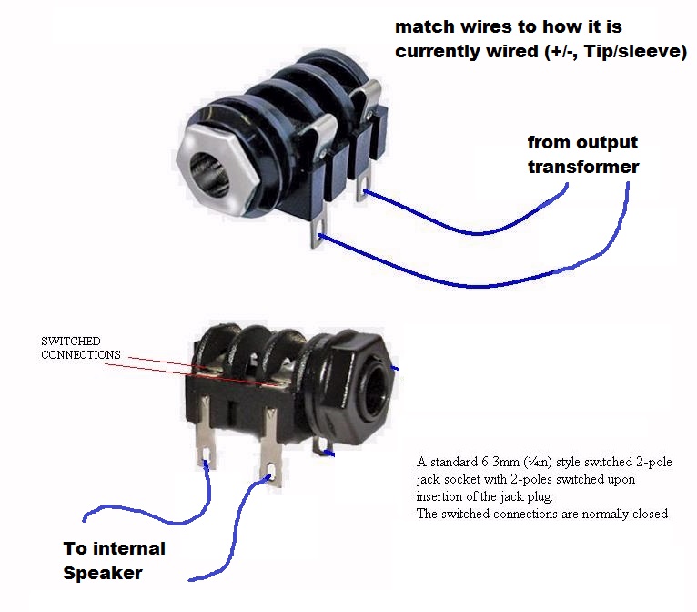

To make one that disables the internal speaker All you need is a mono normally closed switching jack and wire it in after the output transformer/before the speaker such that the when you insert the speaker cable into the jack it breaks the contact to the internal speakers and bypasses it to your cable. If you want to use both speakers you need to take the parallel or series impedance into consideration or you'll have an uh oh but it's same concept different wiring.
You Could also just wire the output transformer output directly to a speaker jack on the back panel and then add a 1/4" plug to the internal speaker wires and just plug it into the new jack and then swap when you want to use a cabinet. But via this method if you forget to plug a speaker in, poppp
