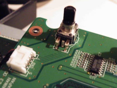

what if it is like a board mounted pot tho?
like this…sorry should have been more specific!

Oof. IDK :(
Maybe someone else can chime in with better insight...you might be doing the best you can with that particular type of assembly.
I am not a fan of such pots. Look for any notches, or slots as previously described, but I think those little guys are sealed. Ultimately it may actually be more practical to just replace the pot :idk:

might try to take the unit apart, and see whats good.
