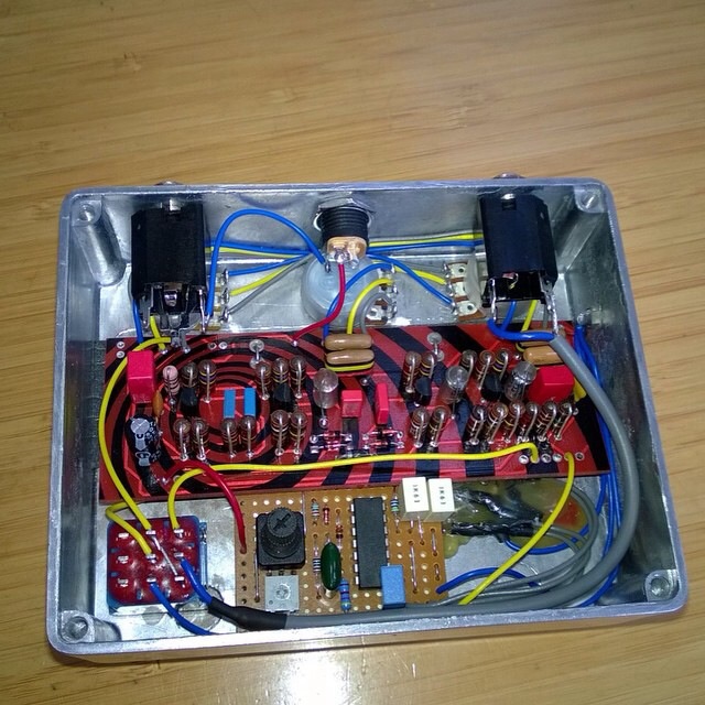

One of my latest custom orders is a Muff style effect. The guy wanted an etched chimney graphic, where the chimney has a couple of bricks missing. He wants the "fire" to glow through the missing bricks when he plays. Not always on, but to light up depending on when and how hard he plays.
I'll cut the bricks out after etching the chimney. Then I'll fix red, orange and yellow behind the holes.
As it's a BMP style effect, I first thought that I would try using red LEDs as one of the pair of clipping diodes, which would shine through the holes. Would be an elegant solution.
However, while this can produce a nice sounding distortion (see EQD Hoof), the LEDs don't have enough current through them to light up very brightly.
Onto Plan B.
I stipboarded a very simple circuit that splits and buffers the input, sending the signal to the Muff and also through a side chain that boosts and rectifies the guitar signal (an envelope follower) and then feeds LEDs. This works perfectly! The LEDs don't just turn quickly on and off; they vary in brightness depending on how hard you play. They flicker just like fire!
I found a bonus too. The rectifier circuit requires a couple of diodes. These can be LEDs! So the circuit want just drive the LEDs, it actually contains two within itself, that have the same flickering effect. So I think I'm going to use 4 LEDs in total to produce the fire effect.
I hope it looks as cool as I think it will. :thumb:
Pics and maybe vid to follow when I've built it :)

I decided against the above way of lighting. It got unnecessarily complicated. It wasn't lighting the LEDs very brightly because, while the envelope follower was good at voltage following the input, there was only enough current to dimly light them. The word Transconductance went though my head. Then I realised that when thinks start to get too "clever" it usually means I'm doing something the hard way.
So, the better solution was to have the LEDs powered from the rail, but have the envelope follower switch them on and off.
One quad op amp. Two to buffer each split path, one as a precision rectifier, and one as a comparator. When the rectified voltage goes higher than wherever I set the trimmer, the LEDs get the full 9V (actually about 5V I think) and all the current they need to glow brightly.
There's a second trimmer to set the sensitivity of the trigger.
https://instagram.com/p/2lVRmHM3a-/
https://instagram.com/p/2lUOfeM3Y-/
I'm pretty happy with that. And the little stripboard firemaker can be fitted to any pedal (as long as you're happy for the input to be buffered).

Guts:
https://instagram.com/p/2lUTM5s3ZI/

jwar wrote:Love it dude!! Super cool! Also your PCB look is fucking amazing!
That's a Wilson Effects "Dirty Beaver" board. I designed it and kept a few for cheeky BMP builds. :)
