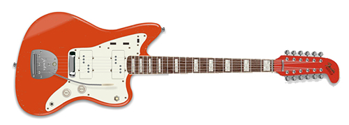

Here's my mockup:
I ordered the Warmoth 65 12 string neck, basic rosewood maple normal pearl dots. I went with the neck that was the cheapest in the Warmoth pre-made section. Never been a big fan of blocks/binding and this one had everything that I needed.
For the body, I wanted it to be a straight Jazzmaster. No electric xii controls or anything but the full Jazzmaster with rhythm circuit etc. I decided to go with an MJT body and get the whole thing a cool aged Fiesta Red. I gave them this image as a colour guide, apparently MJT sticks really close to images and I'm excited cause that Fiesta Red has faded awesomely.
I am also getting a matching headstock and an aged one ply white pickguard.

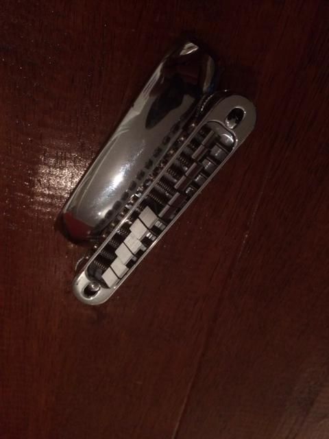

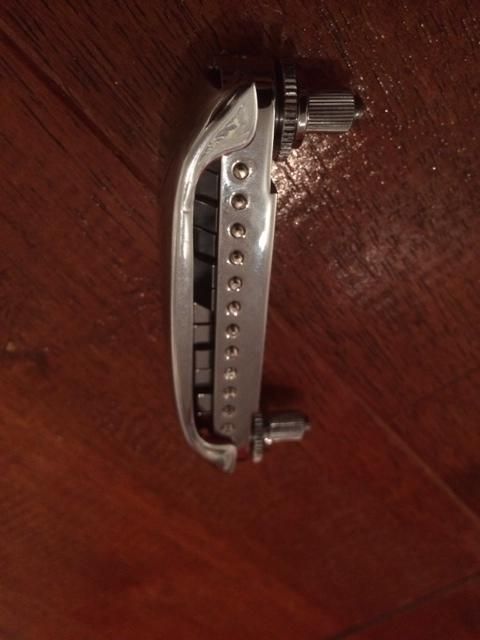

I ended up going for this one:
It's by ABM fits a standard tune-o-matic spacing so I don't need to drill the ric plate or anything. Bought direct from ABM and it was way cheaper than Allparts cause I didn't have to pay 20% VAT

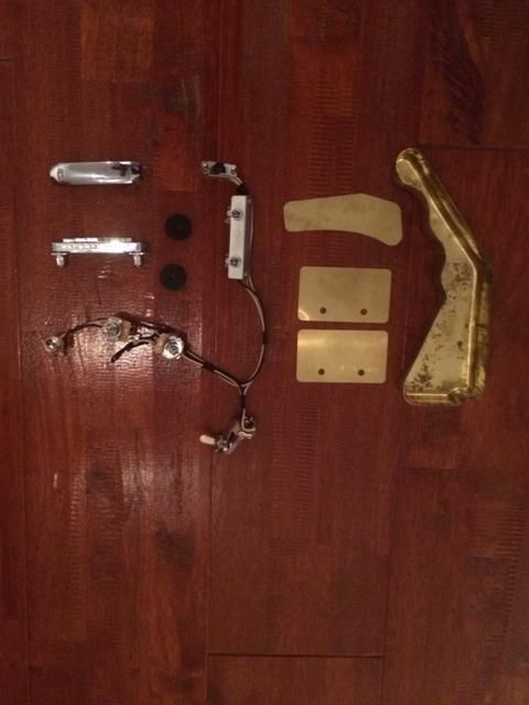

HARDWARE DAY!
Got the shielding plates, bridge and all the parts to make my own wiring harness.
Nice and simple basic Jazzmaster wiring.

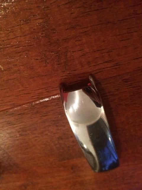

The bridge is super nice it's by ABM, I bought it direct it came in 4 days from Europe! Amazing
Standard Jazzmaster bridge I bought didn't fit the ABM bridge so I cut it up.
I used a hacksaw and some files: Just measured out the bridge size made some cuts and cleaned it up.
Added a little foam just to keep a tight fit without scratching the bridge. Fits tight and looks great.
