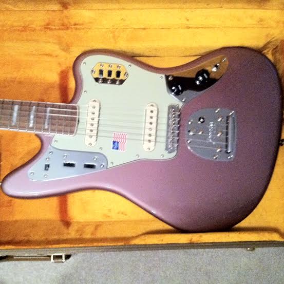

Here's my 50th anniversary Jaguar. I think the Burgundy Mist Metallic with mint green scratchplate is about perfect....have thought about putting a tort guard on but would rather buy pedals :lol: about as close to pink I've gotten.

Re: Shellcaster

Uncle Grandfather wrote:Here's my 50th anniversary Jaguar. I think the Burgundy Mist Metallic with mint green scratchplate is about perfect....have thought about putting a tort guard on but would rather buy pedals :lol: about as close to pink I've gotten.
What do you think that? It's fucking sexy looking, but when I played one the pickups lack some of the vintage growl and the trem seemed a bit spongy [set up low spring tension]. That being said, I keep looking at it...

Hyphen Nation wrote:What do you think that? It's fucking sexy looking, but when I played one the pickups lack some of the vintage growl and the trem seemed a bit spongy [set up low spring tension]. That being said, I keep looking at it...
I don't know why they didn't just do a reissue. And if this was a reissue of the 62 then I would be disappointed in the pickups, they are just too hot. But this is its own beast, sort of a pimped out Classic Player really. Its a quality instrument, i'll give fender big ups for putting together a flawless guitar in mine. I prefer the stock pups that came in my 65 avri Jaguar overall, they are much more dimensional, balanced and a lot less hot. Thats something i don't jive with, the stock pups in modern fenders are always too hot compared to vintage pups. A great thing about this trem is how easy it is to set up to your liking.
