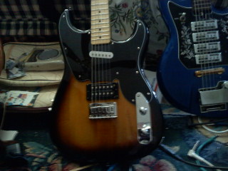

I just bought a 3-ply B/W/B Pickguard for my 2TS 51. All those ideas sound pretty awesome, though! Cymbals....I like the thought of cymbals as pickguard or hardware. I like the pickups, so no swap needed. As for the bridge I was gonna put on it, Muddy brought to my attention something that I foolishly didn't consider; that the ashtray-style tele-bridge is fitted for a traditional tele layout with a single coil at the bridge. This bridge, tuners, everything else feels pretty solid with the guitar, so I'm keeping it as is.
As for the blondie, I'll have to let you know when it lands. From reviews I've read, the finish is transparent (which you can't tell really from the photos I've seen). I think that sanding off the lacquer and then buffing it until nice and smooth might look cool and give it a nice worn look. I ordered it last night, so should be here soon. Until then, I suppose I could throw up a pic of the 2TS with the new 'guard. It looks pretty classy. If I thought my wife wouldn't kill me for buying yet ANOTHER piece of gear, I'd get a third, strip it, and do vintage trans-amber with blackguard. Thinking on the blondie, I'm gonna go either W/B/W, creme, or the 3-ply B/W/B for the guard. The stock 51 pickguards, while cool in shape, are shit in every other regard. I wonder if the creme would be overkill with the finish...I was thinking that a W/B/W or Creme guard would look neat with the black pup-covers on the blonde model.

here's the pic of my sunburst one with the b/w/b pickguard on it.
