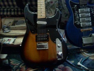

As for the blondie, I'll have to let you know when it lands. From reviews I've read, the finish is transparent (which you can't tell really from the photos I've seen). I think that sanding off the lacquer and then buffing it until nice and smooth might look cool and give it a nice worn look. I ordered it last night, so should be here soon. Until then, I suppose I could throw up a pic of the 2TS with the new 'guard. It looks pretty classy. If I thought my wife wouldn't kill me for buying yet ANOTHER piece of gear, I'd get a third, strip it, and do vintage trans-amber with blackguard. Thinking on the blondie, I'm gonna go either W/B/W, creme, or the 3-ply B/W/B for the guard. The stock 51 pickguards, while cool in shape, are shit in every other regard. I wonder if the creme would be overkill with the finish...I was thinking that a W/B/W or Creme guard would look neat with the black pup-covers on the blonde model.

here's the pic of my sunburst one with the b/w/b pickguard on it.
