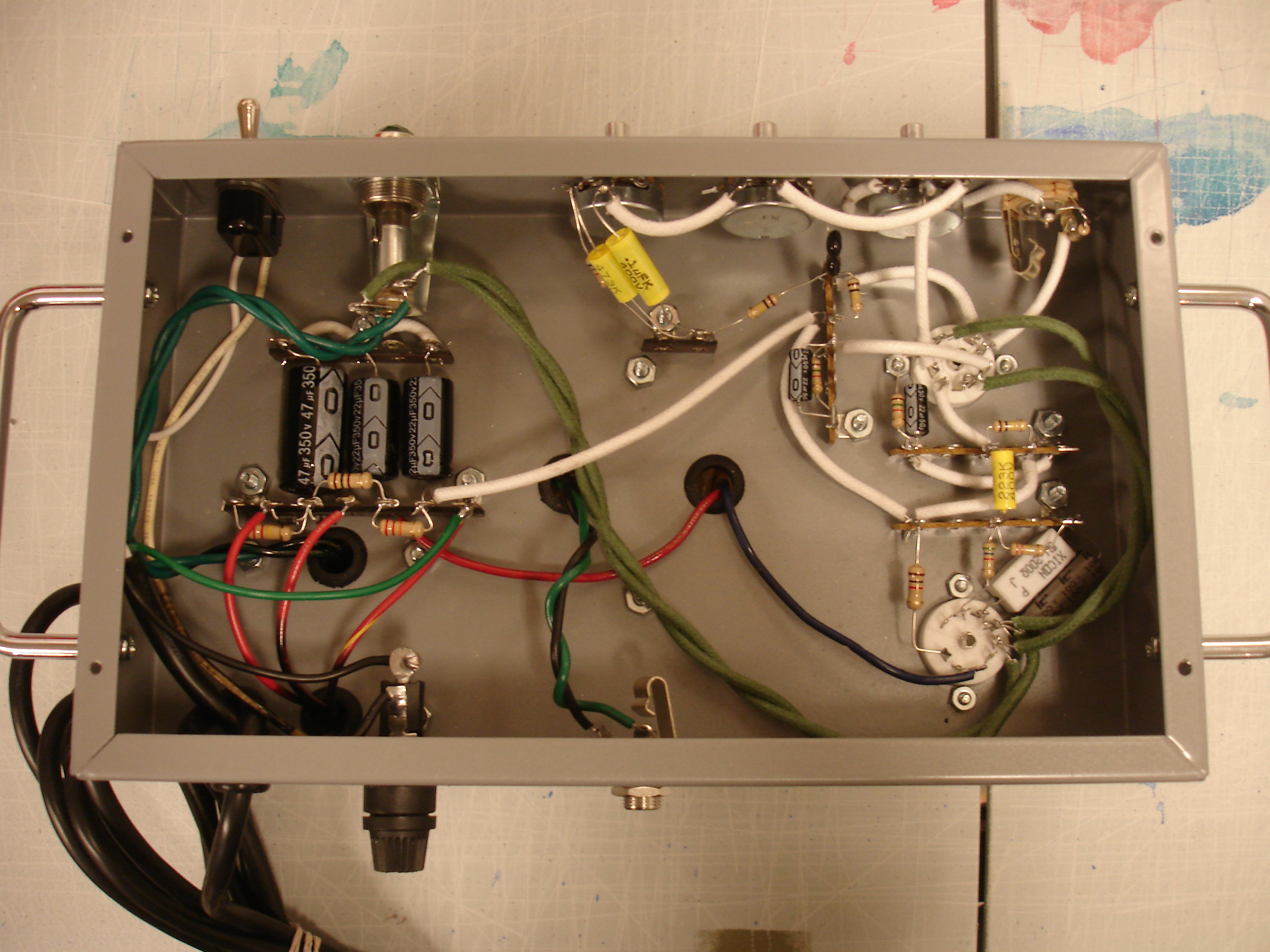

Here's what it looks like inside, only has maybe a dozen resistors and caps to the whole circuit:

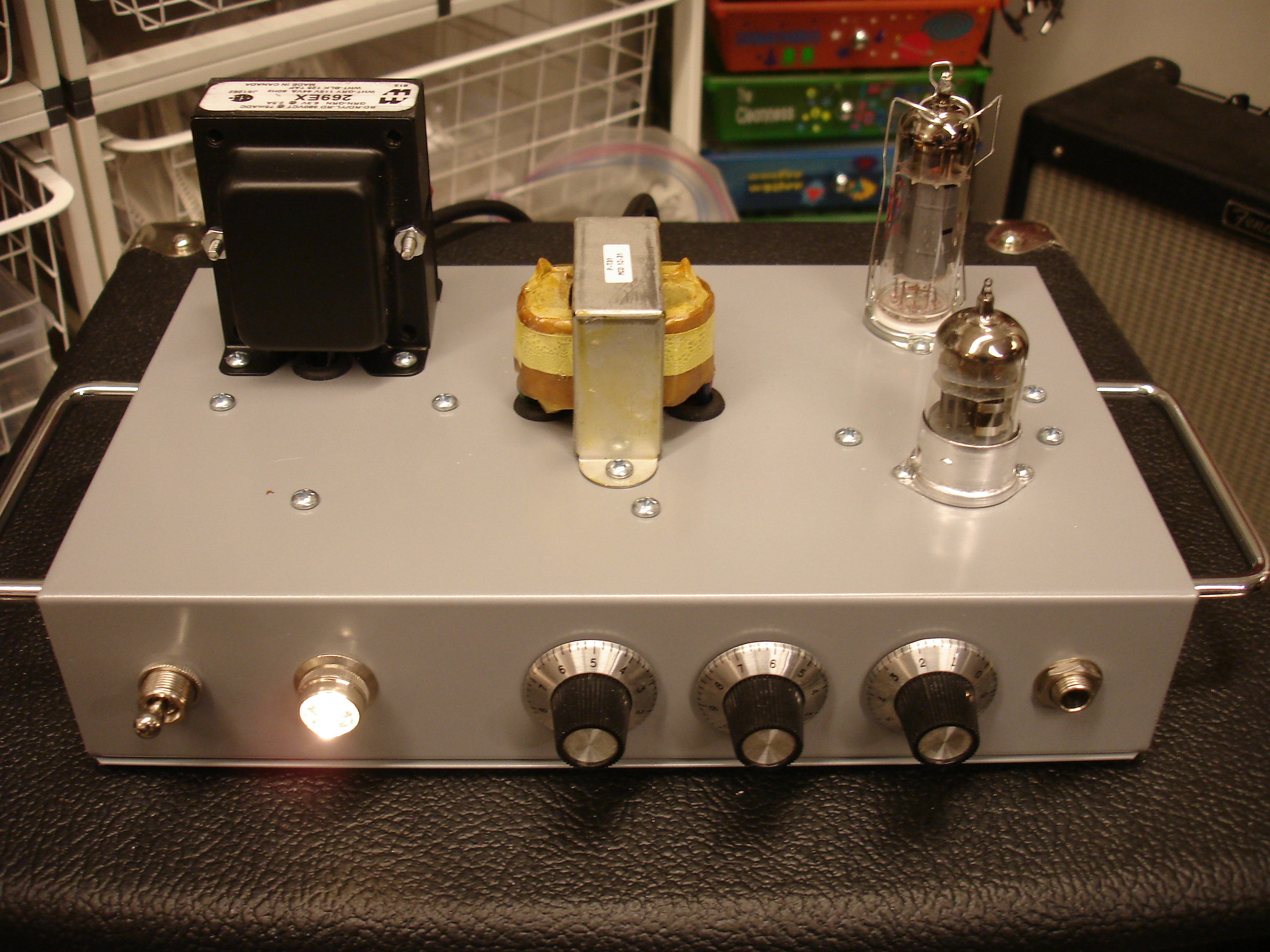

Here's the finished amp:

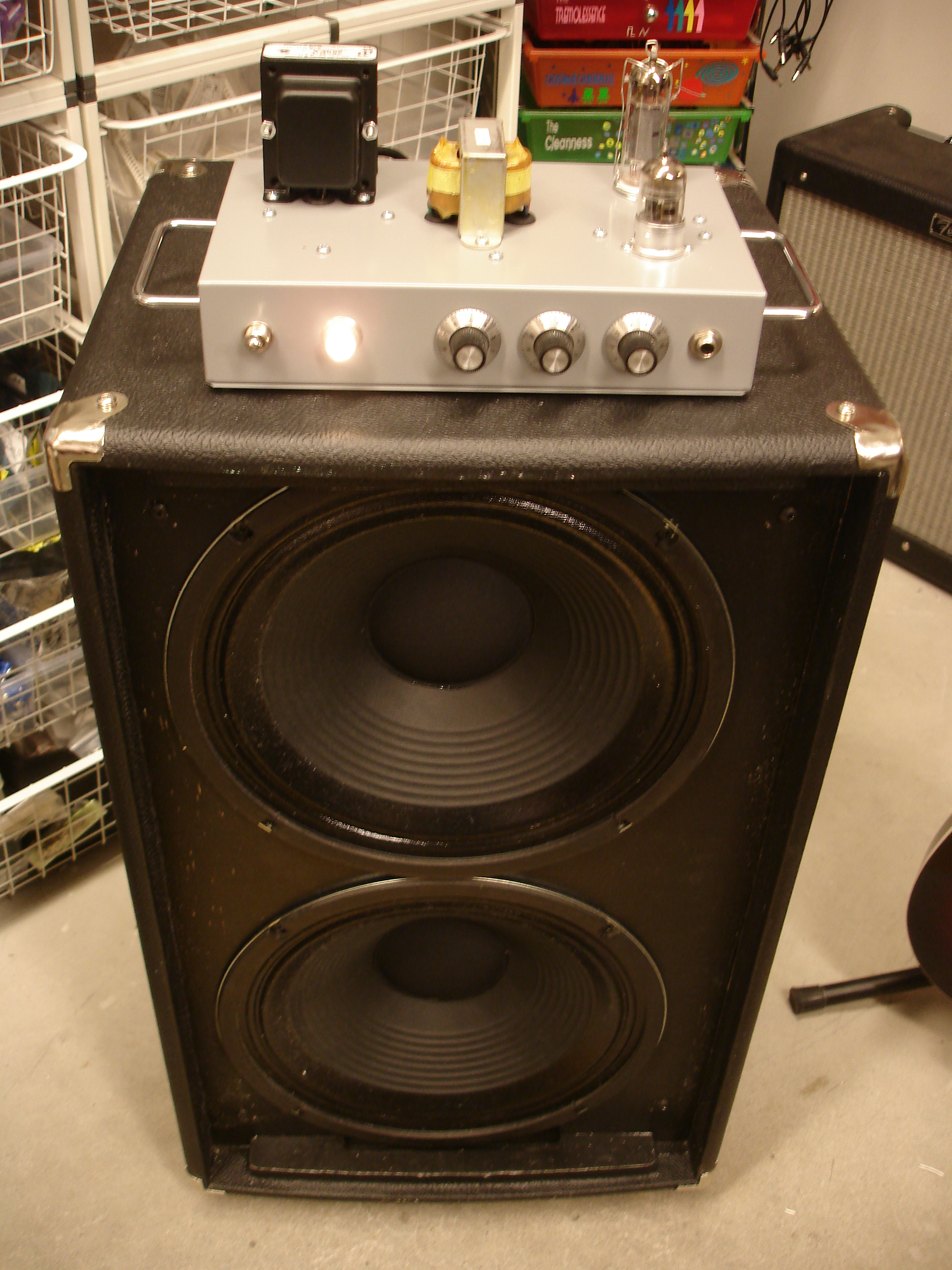

And here's it sitting on a 2x12 cabinet:
It's a great sounding little amp! It stays nice and clean to a modest volume, loud enough to bother people for sure, and then beyond maybe 4 on the volume knob it goes into a really great overdrive and then into a pretty mean distortion. I'd highly recommend the project and I think you'll dig the result bigtime.

Dr. Sherman Sticks M.D. wrote:too late! nom nom nom. it reminds me of some of those pastries u see at asian bakeries.
Thanks dudes!
I figured you were onto something so I had a bite...... you were right, it's delicious! I ate most of it but left enough for the amp to still work. (It's the output transformer, the big tube connects to one side of it and then the other side of it connects to the speaker jack)
