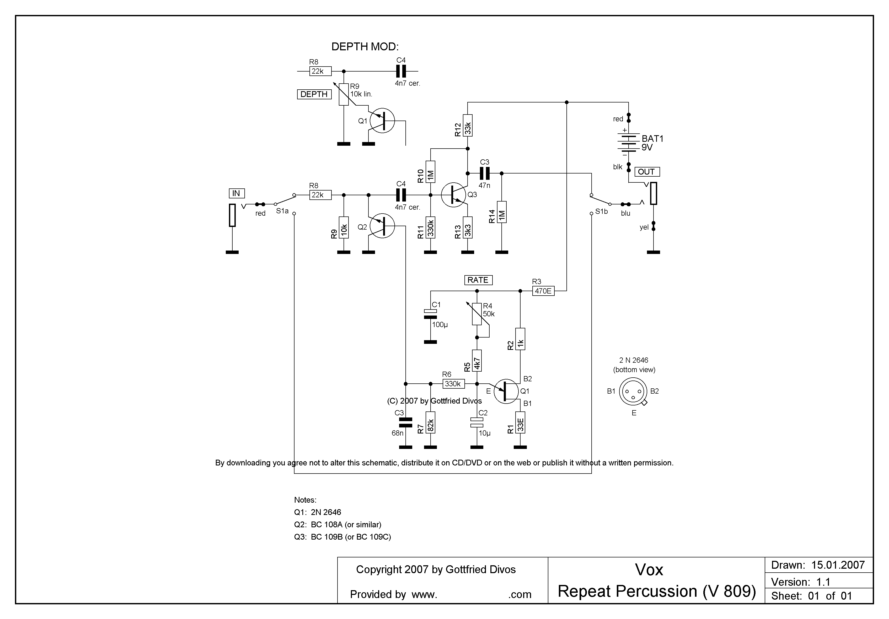

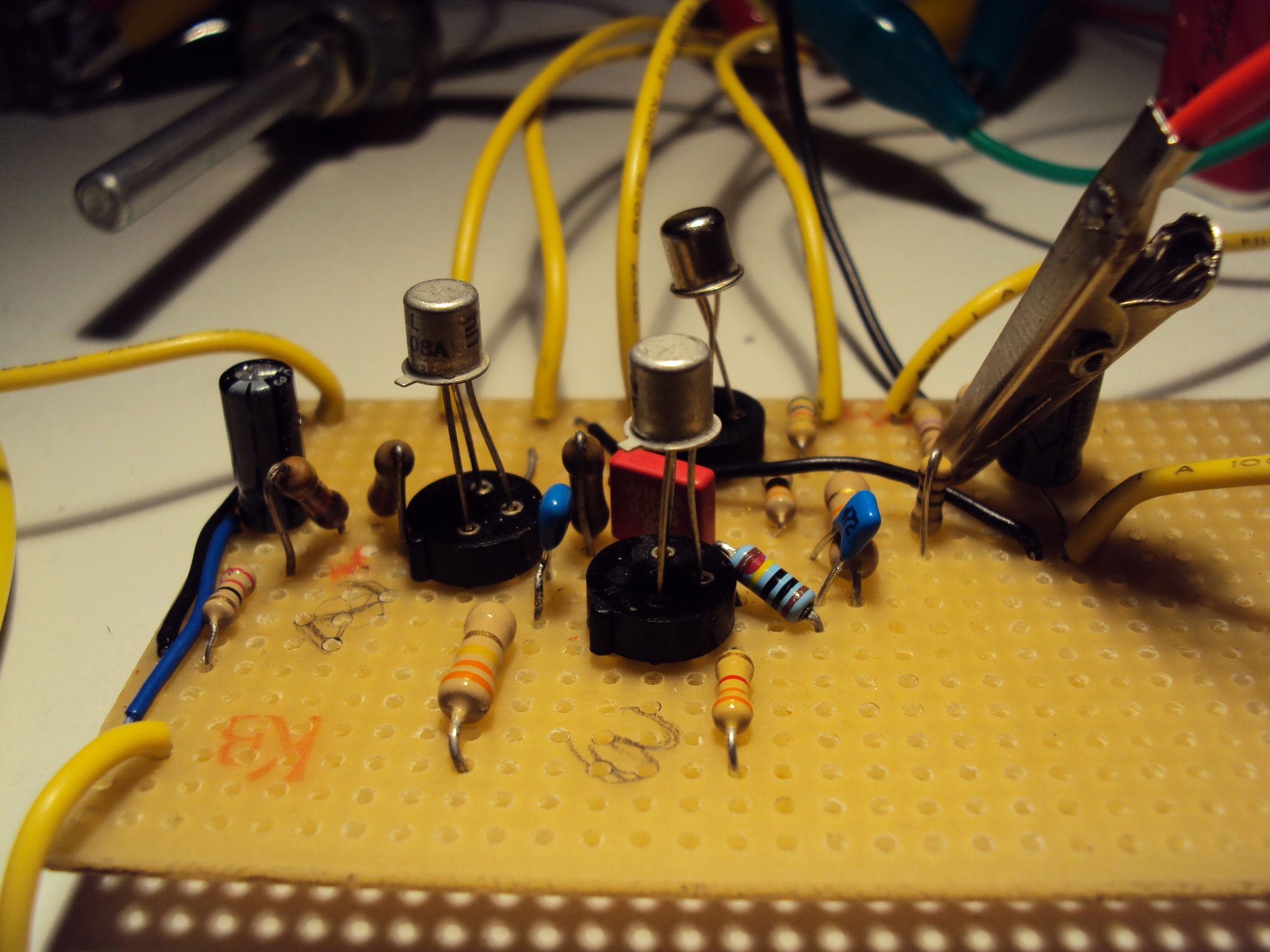

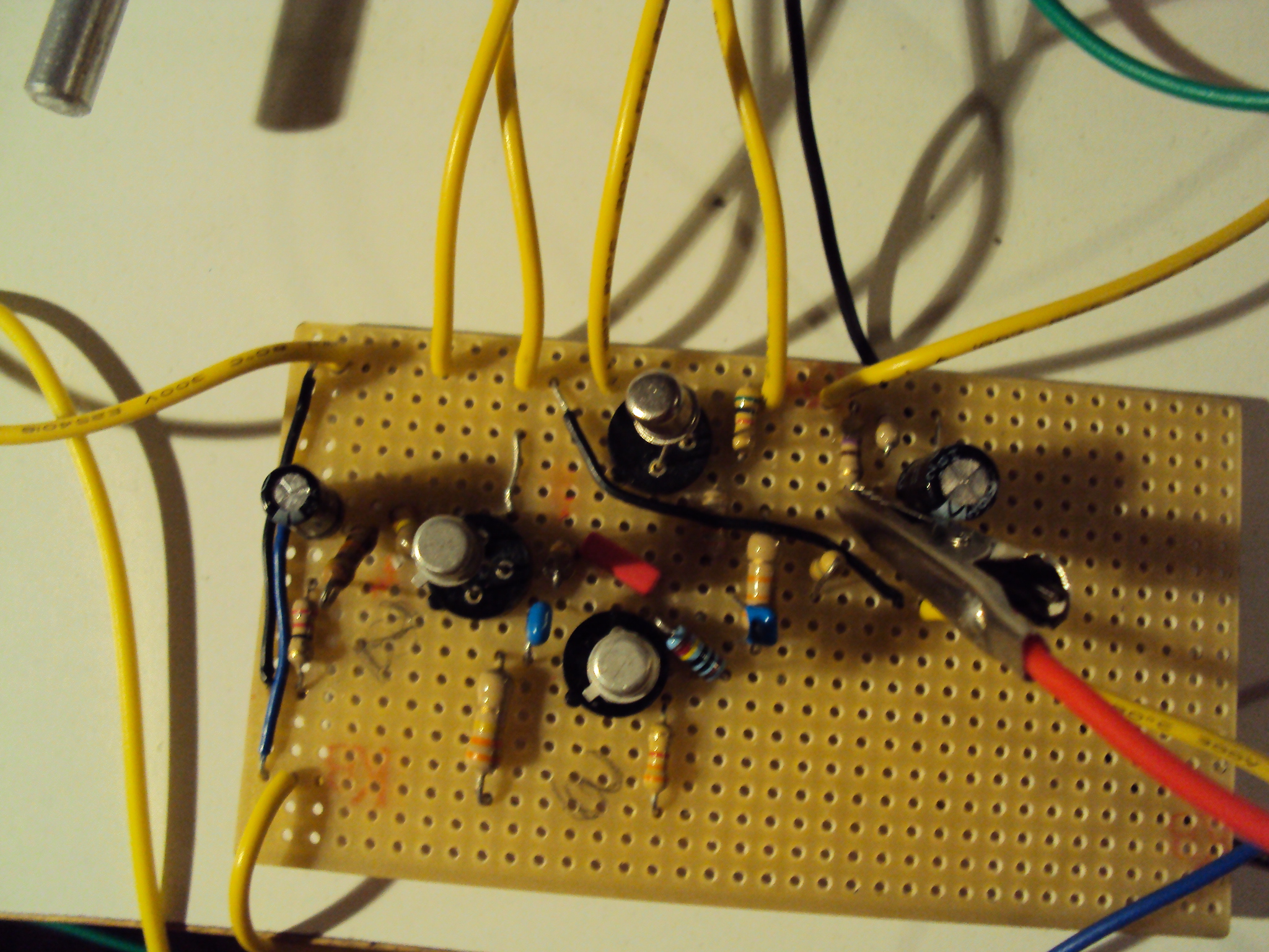

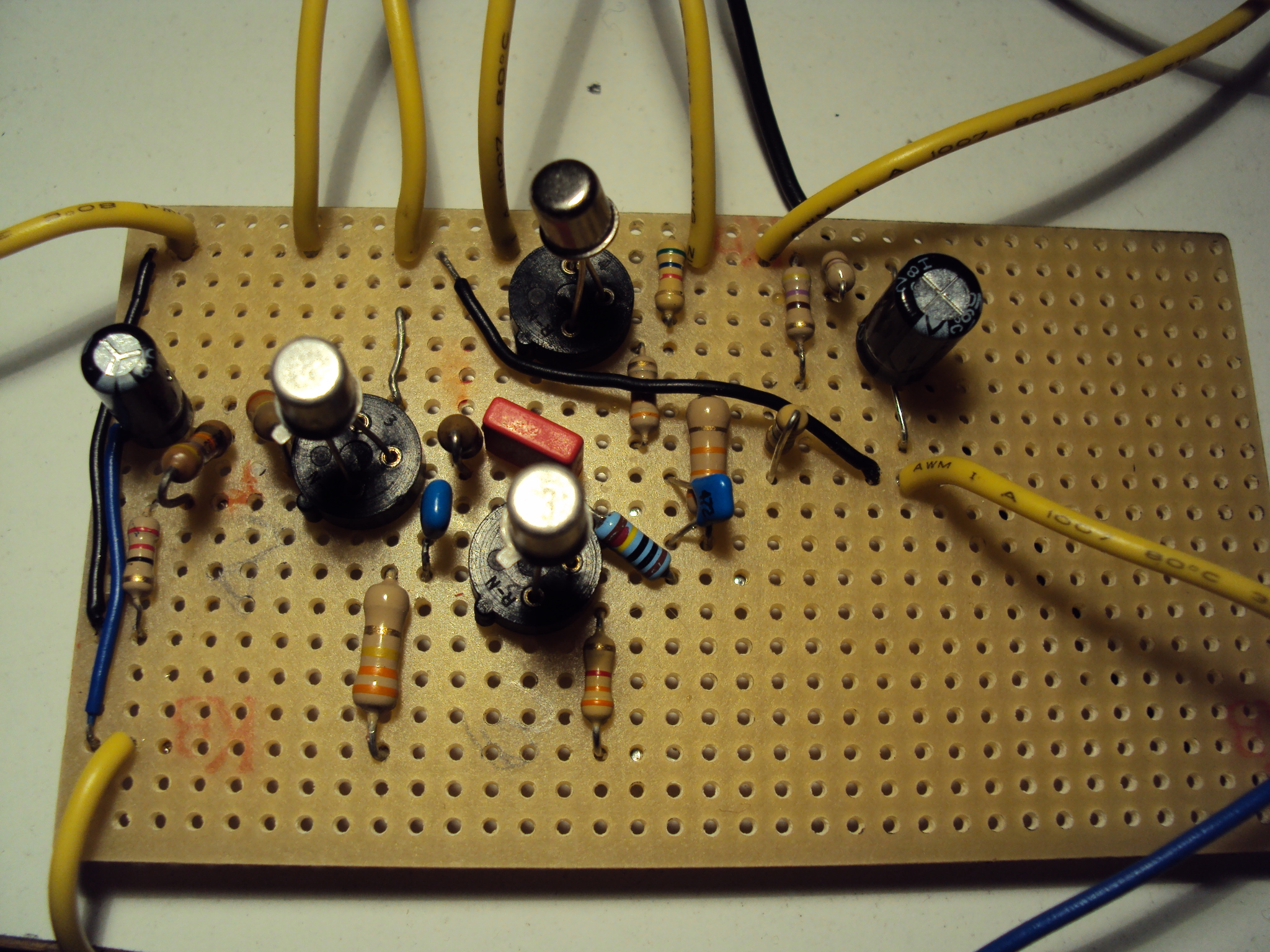

wondering if anyone has built one.
i've been having trouble getting this to work and read somewhere that some 2n2646 transistors tend to just not work.
figure someone might see something wrong :?: or should i just buy a bunch of trannys till possibly one works?

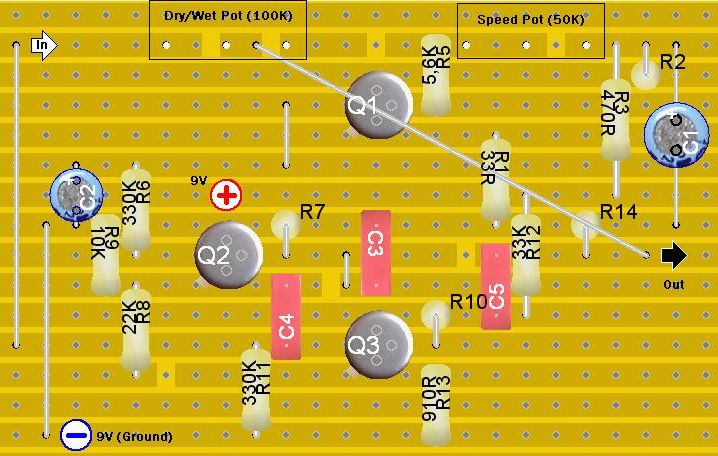

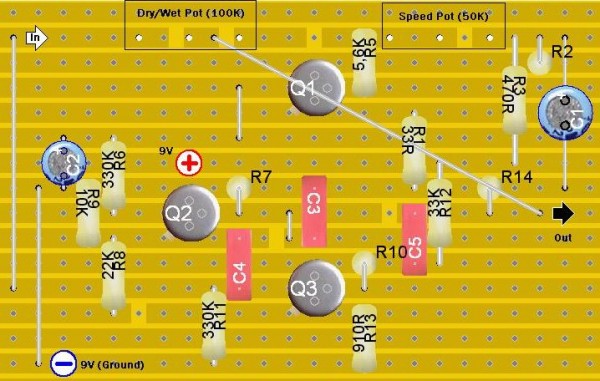

i went with a vero layout i found online but after seeing the mistake (?) at the very start (22ohm resistor at the input is off)

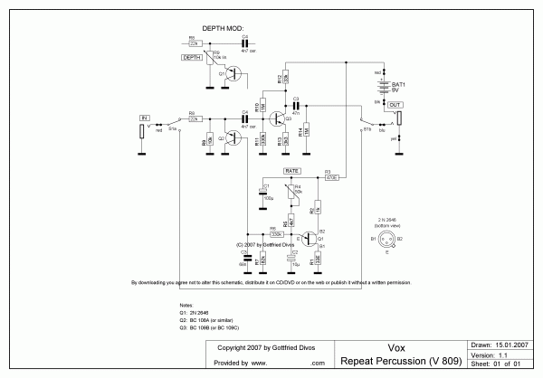

i realize i should have followed the schematic more closely instead although that seems to my noob eye to be the only mistake.
ive also seen an newer revised version of the schematic and made the changes to no avail.

hmmm...nothing eh?

i'd love nothing more than to buy one.especially t he hummingbird 2.
pero no es possible..especially after checking the how rich are you calculator..
plus i have the parts..will check the diy site again i guess
