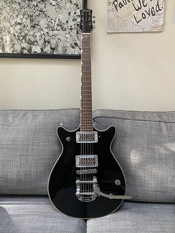

well, another passenger has signed on to my Ship Of Fools. this is a late-00s Gretsch Electromatic Double Jet. the previous owner installed TV Jones FilterTrons, but he did a lousy job of it; you can see that both pickups are at an angle to the proper position, and he cut into the mounting ring for the neck PU which should not be necessary. i'll have to wait for it to arrive to know how much i'll need to do. if i have to take them out and do a total remount it'll be fine, cos TVJ has parts specially designed for mounting Filters in a Pro Jet which was a popular mod for the 2000s PJs with those weird little Gretsch mini-humbuckers (as the perpetual Odd Man Out, i put Dynasonics in mine). it also needs to have a hole drilled/filled where the bottom strap button ripped clean out of the guitar (the mahogany or equivalent on these guys is quite soft and thus prone to screws ripping out). i'll probably add a Gretsch tone switch, possibly with rejiggered capacitor values to make it more useful. the classic Gretsch "rocking bar" bridge drops right on to the Tunomatic studs. i've played these guitars with the B5 Bigsby on before and it works fine, but aesthetically it just screams WRONG; i have an ancient B3 which i'll install, and find a cosmetically pleasing way to fill the B5 holes. oh, and a pickguard. $345 plus shipping, and the TVJ pickups are4 like $100 each. a pro-line Double Jet with TVs would run you a cool $1200-1400.

hawt nonetheless

yeah, i figure some filler, then drop-fill the holes with black paint and sand/polish it so's it's all nice.

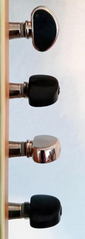

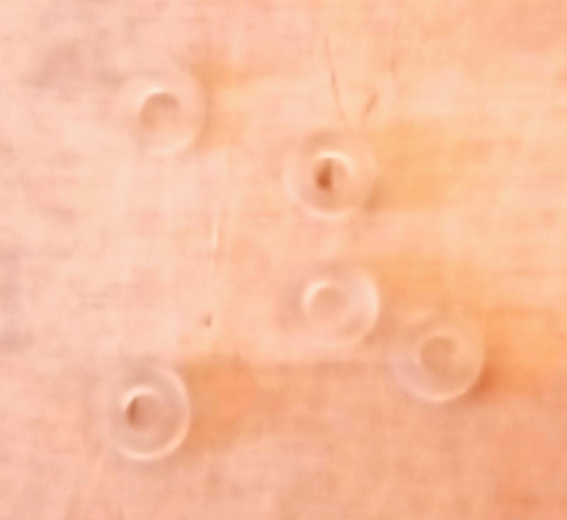

a small job while i get ready for bigger stuff. i have a terrible time telling the tuner knobs apart when i'm playing 12-string, which makes it hella difficult to stay in tune. i decided that it would be a good idea to change every other tuner knob from the chrome mini Grover knobs to wooden knobs. it works a treat. the wooden knobs are a bit shorter along the shaft axis than the originals, which looked a bit funny. i contemplated the situation for a bit, and realized i have a piece of plastic tubing about 9" long; i cut little rings about 1.5-2mm deep and used them as spacers, and it came out quite well. i highly recommend this for 12-strings.
the finished product. note how the clear plastic picks up the color of the ebony knobs.

seriously, it makes tuning 200% easier. i can tell the difference in texture and temperature just by feel now.

the Double Jet arrived today. it's actually in better shape than the listing led me to believe. not only did the previous owner install the pickups crooked, he somehow managed to get the neck pickup wedged in the rout effectively enough that i had to take out the mounting screws entirely in order to adjust the pickup height. when i first played it i was less than thrilled with the pickups, but when i adjusted them to be closer to the strings i started getting that patented FilterTron thwack/plunk that makes them so appealing. once i get everything else done they'll be great. changing from the current ABR-1/Bigsby B5 will make it sound Gretsch-ier, if you will...the bar bridge makes the strings a tad plonk-ier, and switching to the B3 will lessen the string tension significantly for additional twang. now it's going to go sit in the queue until it's Woodworking Time, which might be next week. but this one needs to wait for parts i've yet to order. i'm going to do the lazy man's option and just order a wiring harness from TV Jones, saving myself the hassle of figuring out how to convert from a simple pickup switch->volume knob->tone knob to a pickup switch->tone switch->individual volumes for each pickup setup. this will also require a bit of cosmetic work to eliminate the mounting holes from the B5, so this will be an adventure. but i know that however badly i fuck it up, it'll still be better than Tobin Guitar Works.
