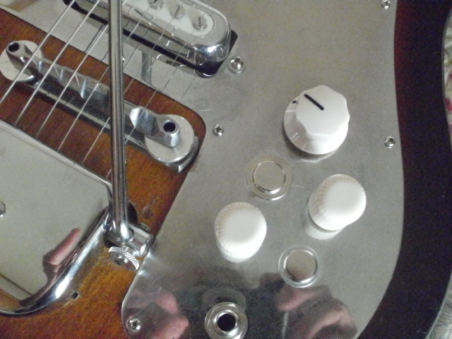

i've got Kendo up and running. the wiring was a screaming hell-beast which took me parts of three evenings. why they don't label the terminals on six-position switches i'll never understand, but it made it really hard to wire it. i bought a sampler package of wire from Small Bear which i used to color-code the switch wiring, but still had to re-do several connections.
here you can see the cut-out i had to do so the truss rod nut would fit; i filed the notch in the pickguard and cut out the wood with a sharp pocketknife.
the controls. the MXR knob is for the six-way PU selector (neck, middle, bridge, n+b, n+m, m+b). the ivoroid StewMac knobs are volume and tone. i plugged the additional holes on the guard with caps sold on eBay as neck bolt covers for Supro guitars, with washers underneath to cover the bunged-up areas around the holes.

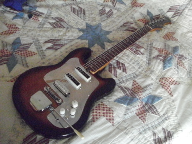

the finished guitar. the mystery eBay tremolo is lovely...it has a little play in the mechanism, but drops almost as low as a Strat tremolo when you put the bar down. the bridge is the Bigsby aluminum bridge i mentioned earlier; it had a long archtop style base which i cut down to length.
the plastic Kent PUs have a nice reedy kind of sound; the Guyatone bridge PU is NARSTY in the nicest possible way. the two-PU positions sound odd and thinner than on a Fender, more like the PUs on Hoppy. this might have to do with the pickup positions, which are off from the typical spots in the string length than most guitars and thus read different harmonic content. i did a ghetto fret-dress this morning which is basically rounding/polishing the frets with 800 grit sandpaper, and that really helped a couple of spots on the neck where one or another string buzzed.

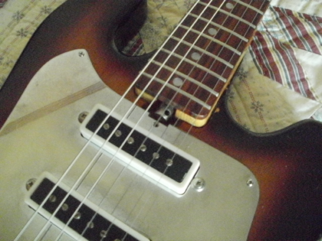

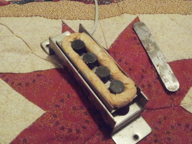

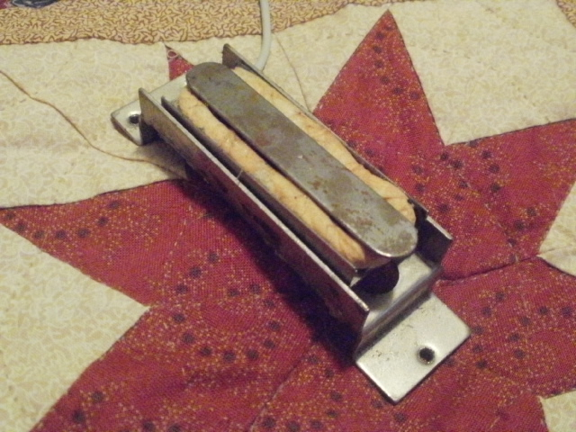

i promised y'all pictures of the Schaller PU from Hoppy.
here you can see the pickup as it appears when the cover is removed. the long flat piece on the top is a steel plate approximately 1.5mm thick which serves as a sort of Paleolithic equivalent of the blade sensor a la Gretsch SuperTrons or Charlie Christian PUs.
this is what's under the bar. there's no bobbin at all. rather, the coil is wrapped in tape which appears to have been coated with epoxy or perhaps wax-potted, with four cylindrical polepieces spaced equally inside the coil. the only bobbinless pickups i know of that are still produced are Burns Tri=Sonics, which have a single bar magnet rather than slugs, and possibly the "Vintage" Schaller archtop Johnny Smith mount and soundhole-mount acoustic PUs that appear on their website. they have a charming, reedy sound which sounds a bit like a Strat played through a telephone. their main drawback is the lack of adjustability; to balance the top string with the rest of the strings i had to actually shove the entire coil, slugs and all, over to the treble side of the mount (it's centered in the photos).

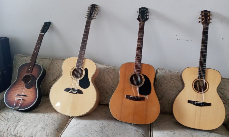

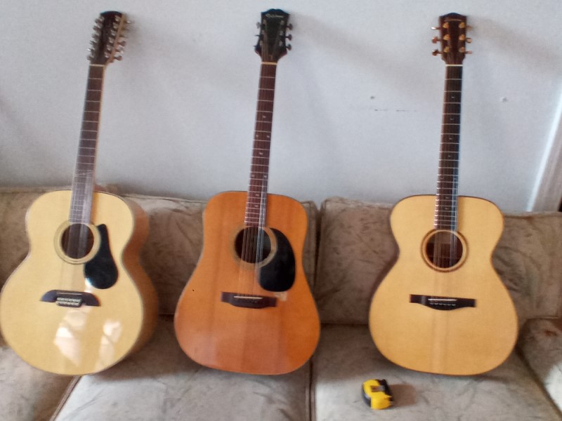

i have so many projects/putative projects on the board that it's hard to know where to begin. at the moment i'm doing some stuff with the acoustic guitars. the Alvarez 12-string on the left is getting wooden buttons for every other tuner, which i'm hoping will help me to quit cranking the wrong tuner. the middle guitar is an Epiphone FT-345 which i bought new in 1974. it's been everywhere; you can see her history all over her. the Epi gets a new nut and saddle (all acoustics here that don't have them already get a new bone nut/saddle and bridge pins as soon as they come through the door) and replacement Grover Sta-Tites to replace the ones that have been on since 1980, also an Epiphone truss rod cover with the big "E" on to replace the one which was lost back in the 1970s. the Eastman 000 on the right may get the saddle filed down to improve the action a bit, but otherwise it's perfect just as it arrived. sorry the photo sucks.

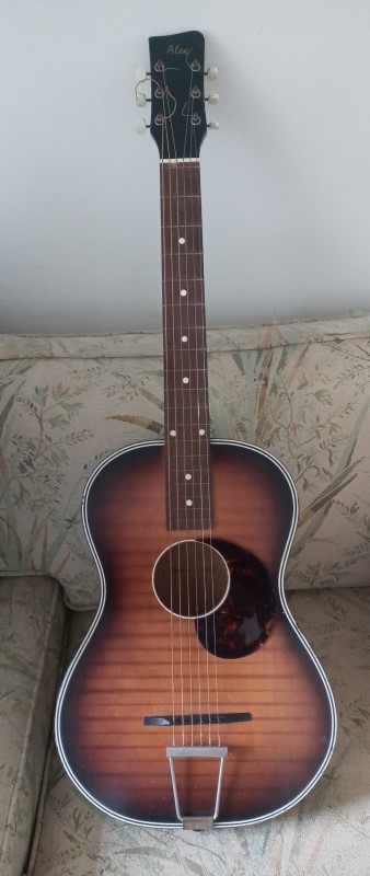

more/better pictures...here's a better shot of the acoustics with a little guy i sometimes forget about over on the left. it's a Egmond Alex parlor guitar which needs the pickguard glued down where it's starting to peel up.
here's a better look at Alex. the fingerboard appears to be made of some rather porous wood, and i have no idea what other woods are used. there appears to be no truss rod, so it's a bit surprising that it's held up as well as it has. 25" scale despite its small size. the tuners are startlingly good for what must have been the Dutch equivalent of a guitar from Montgomery Wards. the bridge is plastic, and i had to use wood bits to build up the saddle slots so it doesn't buzz in spots above the 8th or 9th fret. i might try a wood bridge, which presumably would help tonally. interestingly, it's not a regular set neck; there's a single bolt at the neck heel which screws into a bracket inside the body...thus, if i get brave enough to try it i can perhaps re-set the neck to help the string height a bit. it's actually a kind of neat, boxy sound with hints of cardboard and kerosene. really, i only bought it because i was stoned and thought it looked like a tabby cat.

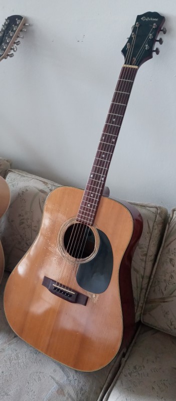

here are some better pictures of the Epiphone, showing its rather reliced state. note how the soundboard is worn away around the soundhole/rosette, particularly on the treble side and below the pickguard.

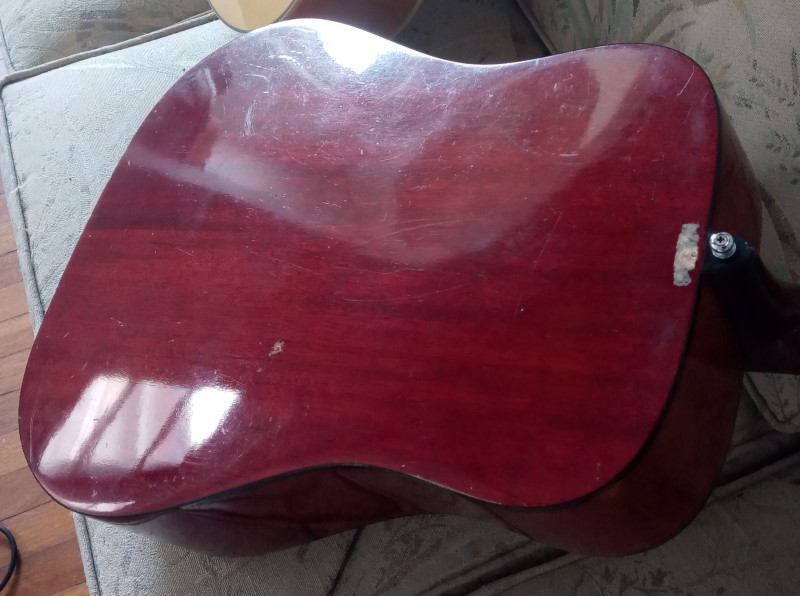

here's the back, using sunlight to highlight the wear.

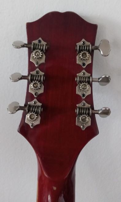

in this shot you can see just how beat the old tuners are. half of the head on the the main screw on the low E tuner has broken off.

i realized last night that the Egmond's neck mount is actually a tilt adjuster! thus, i should be able to do a modern-day low-rent neck reset with the big flat-headed screwdriver.
on the other hand, i can't find a suitable wooden bridge, so i'll have to carve one myself.
