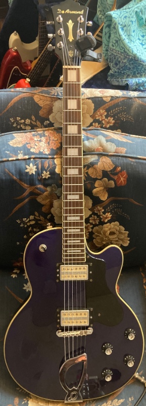

ordered a Kluson ABR-1 for the M-75. if this works i’ll change out the bridges on the other two DeArmonds as well. the bridges on budget 90s-00s guitars are generally a weak point.

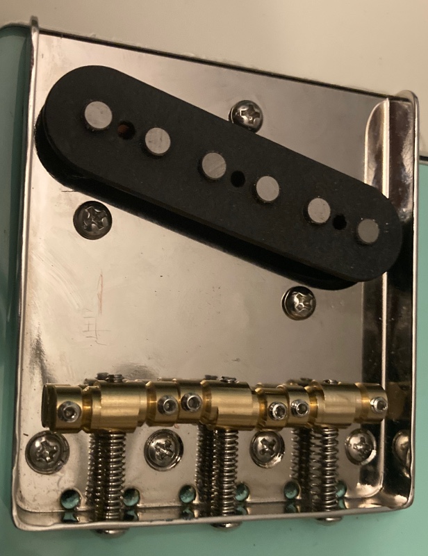

some of the parts came in, so i’ll be messing with stuff later in the day. the compensated Esquire saddles look great, but use a larger-diameter adjustment screw so i’ll need to drill the bridge out to fit. i’d file it but my round needle file has gone missing since i put the pickups in the Hopf…i guess i could get a new set, since there’s only a couple left. the ABR-1 for the blue M-75 also arrived, and only needs to be notched to match the old one. so insh’allah i’ll have the DeArmond sorted, and the Esquire ready to wire up.

i got the stuff i was after from Lowe’s. the new needle files worked well, and the integrated handles helped a lot. the new saddles are massive brass units the same diameter as the stock saddles but covering a larger area. by reversing them they offer two degrees of compensation; i went for the greater in all cases because IIRC the old saddles needed much more variance than i could supply. i reversed the center saddle so it’ll compensate better between the G and D strings.

finished the initial setup on the Esquire…it’ll probably get some additional tweaking, but the compensated saddles intonate perfectly. i’m really impressed, and will have to replace the Duo Sonic saddles presently. i might still do the M-75 bridge today, but i don’t think i’m doing anything with the soldering station till the weekend. it’s funny that i originally thought of the Esquire solely as a source for the Sherwood Green body and now it’s a happy little beast on its own with its $80 replacement body.

the springs, second tremolo claw, and screws for the Galaxiemaster spring chamber are out for delivery, so i’m probably going to mess with that sooner than later because i’m so curious about how it’ll come out. i’m in the process of replacing the M-75 bridge, and am startled by how much heavier and more solid the Kluson replacement is. i anticipate a marked improvement in tone and sustain. i guess i should replace the other cheap import tunomatics where present, particularly on the other DeArmonds. i still could get into soldering this weekend depending on how i’m feeling.

i got the new bridge installed on the M-75 and holy crap. it improved the sustain and resonance so much that it hardly feels like the same guitar. i couldn’t figure out why it was so plunky compared to the demo of the Gold Tones in an Explorer i saw on YouTube that convinced me to try them; it was the shitty bridge. it absolutely snarls now, and has the lovely resonance you’re looking for in a mahogany (or mahogany-esque) guitar. i want to A/B it with the Tokai Les Paul to see how they differ. seriously, folks, if you have an imported guitar with a shoddy tunomatic—which is most of them—get that sucker off there ASAP. one more nail in the coffin of “the only thing that matters is pickups.”
it also looks much better. the oversized bridge made the whole lower bout look subtly out of proportion. it looks right now. i also replaced the big Grover-style tuner buttons with mini buttons for a more vintage aesthetic like the old-school Aristocrats and Bluesbirds.

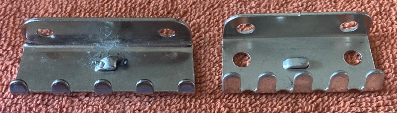

the Galaxiemaster spring chamber is a little trickier to implement than i thought, but still quite doable. counterintuitively the rout is wider than it is long, so i’ll need to run the springs at 90° to the string path rather than parallel. the second claw i ordered (on right in the photo) is a Squier-sized item and is much better for this application…it has holes so i can mount it perpendicular to the walls and gain more spring room, and also has longer tabs i can bend to hold the springs better. i ordered another and the chamber can wait until then.
the stock size of Fender tremolo springs is approximately the same length as the width of the rout, so i’ll definitely need to shorten them by a half-inch or so in order to have room to tension them with the claws. it’s yet to be determined how taut they should be; i imagine i’ll literally be tuning them to where they feel right and have a bit of BOING when the body is struck. it would be nice to see the actual chamber on the Vintage Revo Vision guitars so i had something to go on, but what’s DIY without trial and error?

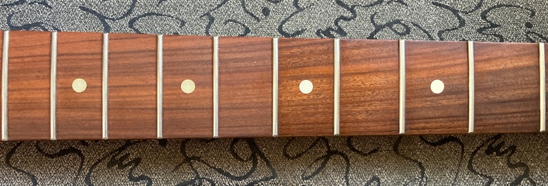

while waiting on parts and getting it together with the soldering station i came up with a couple of side quests. my MIM fretless Fender Jazz Bass needs a neck shim as a last-ditch attempt to avoid having the neck, whose truss rod is maxed, steamed, and the Lead II’s pau ferro fingerboard, which has a weird grainy texture, needs to be sanded. the board feel keeps me from really enjoying the guitar. i expect i’ll eventually have to send the bass neck out, but i don’t need that expense.

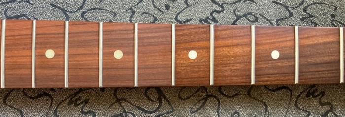

i got a third of the way through sanding the Lead II’s pau ferro fingerboard, and the difference is remarkable. it was originally surprisingly rough, and took a ton of oiling to be barely acceptable. once sanded it’s nice and smooth, and since it seems considerably harder than rosewood it should stay that way. what’s really surprising is how the color changes…the unsanded areas on the left are dull and predominantly reddish in hue, while the finished parts are browner. the light streaks become lighter, and the dark streaks darker. the result is a striking pattern that reminds me of a mountain sunset.

parenthetically, Fender seems to have problems preparing non-rosewood fretboards in their non-US facilities. this isn’t the only example; you’ll recall that i had to sand the Indian laurel board on the Esquire, which was made in Indonesia while the Lead II is from Mexico. it seems to me that they try to simply do the same processes as with rosewood, but that’s not suited to either wood…laurel needs to be grain-filled and aggressively polished, while pau ferro, being harder than either, comes to life when sanded to 2000 and polished. it’s unfortunate that the market life of the reissued Lead series was probably negatively affected by the pau ferro issues. i know other people online who also bought them sight unseen were similarly bothered, and i have to assume people trying them in person would have been put off.

i’m pleased to report that the inflammation has largely subsided after lots of steroid cream. i did 3 more frets last night and managed to get away without further problems. though my right wrist tried to go off, i managed to take care of it and it was fine this morning. i have 9 frets left to go, up at the high end of the neck. if i apply myself i could conceivably be done today. i started doing multiple frets at a time hoping to make it go faster and though i’m not sure it works it’s still good because it helps me be more consistent from fret to fret. once it’s done imma put the neck back on and have a Mission of Burma party. then i reckon i’ll shim the bass neck and then tape up the Jetstar neck for priming. yes, i am still putting off the soldering stuff.
