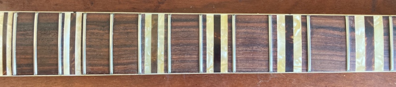

i finished off the Höfner fingerboard this morning. took a bit more sanding that i expected to get things flush and smooth, but it’s pretty much done unless i discover some as-yet-unknown issue that needs dealt with. i cleaned the entire board off with alcohol because when i cleaned the first fret it was quite dirty. now all i need to do is let the super-thick CA dry on the divot on the first fret and then sand it down.
i want to jump over to the Esquire/Tele project, but i feel like i should do the two passes of polishing on the GM body first so the GM parts are in a similar state of readiness. so that’ll probably do me for today.

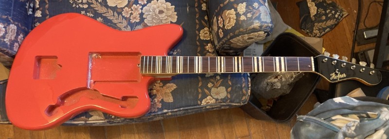

as i'm getting ready to do the hopefully final rounds of polishing the body, i got the neck and body out and lined them up as they'll go when they're assembled. checked for correct position for its 25.5" scale and the neck needs to join the body at the 16th fret, which is the same as a standard Jazzmaster. aaaaaand all of a sudden it looks like a guitar. and the Fiesta Red looks less washed-out with the dark board and headstock.
even though the proportions are roughly the same, the GM looks neck-heavy just sitting there. between the substantial weight of the body and the loads of hardware going on i think it'll be OK. if not i can always put lead weights in the tremolo rout LOL. if i decide i don't want to fuck with piezos on the GM i won't need the space for a battery/preamp, so in that case i'm thinking i'll put plastic toy dinosaurs in there.
so next it's polishing the body and then working out the neck mount. as you can see in the photo the amount of wood left at the end of the existing neck pocket is only about 2 mm so it makes no sense to leave it when i'd have to cut a notch through it for the heel truss rod adjuster. i'll spec the pickguard to sit flush against the neck heel with a notch once again for that pesky adjuster.
when the neck and body are together i'll probably mount the B50 as well. then it'll just look like a peculiar JM husk. i'll definitely need to create more room by enlarging parts of the control routs, and might relocate the lower bout controls slightly to leave room for a volume for the piezo should it come to pass. on the other hand, my friend Charlie says he has "a couple of offset bodies i'm never gonna do anything with" and a piezo could go in one of those. or i could spend $900 on that fucking Italia. that's a minor issue for now. i suppose at some point i'll order a couple of Schaller Oysters and place them near either end of the bridge, which will have space whether i use an archtop base or use the Musima bridge's studs.

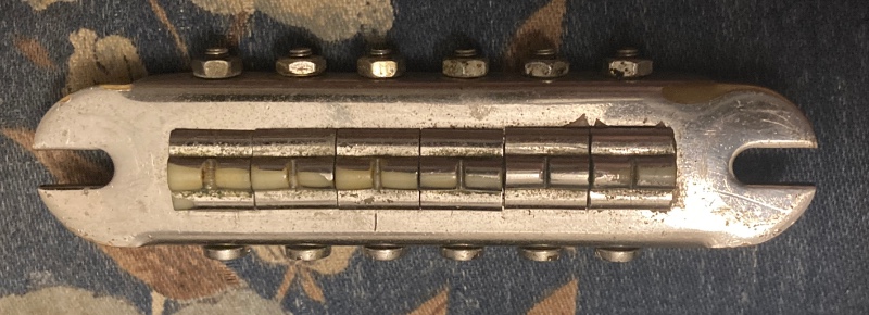

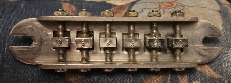

i knocked out one more small Galaxiemaster job, fixing up the Musima bridge. a couple of the bridge saddles were wonky…the plastic saddles work with metal adjustment screws via wee brass inserts of very thin metal, just this side of foil, that the screws bite into. you can see the end of one of the bushings protruding slightly above the upper edge of the 2d and 5th string saddles (helpfully labeled “2” and “5” respectively on their bases) in the second photo. the bushings were missing from two saddles. fortunately i have a second Musima DeLuxe bridge in poorer condition i got with a heap of funky parts from a guy in Poland, and was able to pull the bushings and transfer them to the other bridge’s saddles. once that was done i needed to fix the lock nuts on the ends of the screws in place so i hit them with blue threadlocker and after drying they rotate freely with the screws without coming undone. my favorite blue threadlocker use is securing the nut that secures the output jacks on many guitars which can have an annoying tendency to come loose, letting the jack fall into the interior of the guitar. my 335 was very problematic that way until Loctite entered my life.
note the visible bushing on the 2d string’s saddle. yes, i did reinstall saddle 6 backwards. no, it doesn’t make any difference.

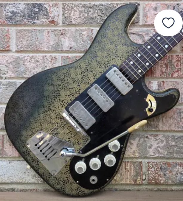

the Musima bridge, like many East German parts, is crudely made (compare to USSR parts where the prime directive seems to have been CHEAP AS HUMANLY POSSIBLE) but has a wide range of saddle adjustment that’s pretty detailed due to the closely-threaded screws. it also goes with the general weathered look of the neck, Bigsby, and RCA K-80 knobs. i need to decide just how to use it. the best solution that doesn’t involve drilling stud holes is the Göldo (yes, the umlaut is correct…the founder is Deiter Gölsdorf) multi-width base which can go wide enough for the wide-spaced bridge. it also has handy plastic foot tabs that would serve as decent mounts for the putative Oyster pickups, which come in a pre-wired pair with a single output jack. they might not be dreadful run through the Hotone Acoustic Simulator which could also serve as a preamp of sorts, and really what more could i ask for in a cheap piezo solution? they’d probably do better either literally stuck onto the bottom of the bridge or on the top of the body near either end of the bridge, though.

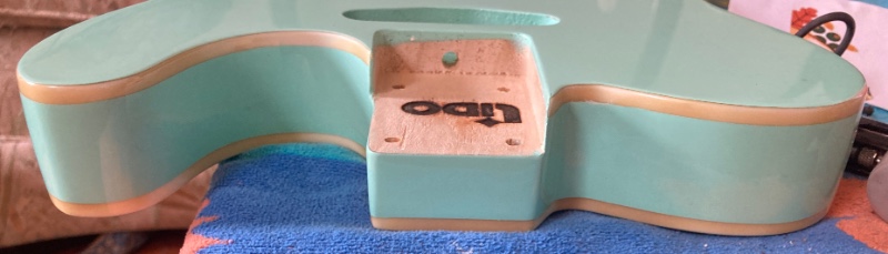

spent some time looking at the Lido Tele body to figure out specs for the hardware that won’t transfer over with the brains. i’m going to have to get string ferrules from GFS because they’re 8 mm while everywhere else they’re 8.6 and i don’t trust the finish not to chip for even one second. for the non-standard jack plate—GFS says the Lido bodies don’t work with a standard Tele cup—i’ll get a curved, square one. everything else from the Squier should fit.
i think i know why the body color is unusually greenish, and why the binding is variegated. the only thing that could make the binding go dark-to-light moving up is some kind of tinted (un)clear coat. no, i am NOT going to try polishing through the clear coat on an $80 body, but it could use a couple of rounds of polishing just to get it good enough to quit thinking about.
the color variation is particularly noticeable around the cutaway and next to the neck pocket.

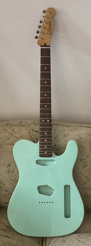

since i'm trying to "eat around my plate" by doing stuff on different projects rather than homing in on one thing, i decided to take the Esquire apart and start grafting Squier parts onto the Lido body. before doing that i had a go at one round of polishing, but quickly decided that it'd be pointless to do more for several reasons. for one, the binding discoloration is not susceptible to polishing. for another, the actual binding job is lousy. they used binding too small for the routs no doubt to avoid sanding it down, but the result is that it doesn't quite reach the level of the top. and finally i really don't care that much about having an Esquire so i'm not as invested in making it as perfect as reasonably possible.
i pulled the Squier neck and happily it fits the Lido body with no problems. next i have to do the bridge and pickguard, which i'm not looking forward to since it involves a lot of drilling. i'll do the pickguard first because it sits right up against the neck heel and thus should be easier to get right. after this is done i'll need to to a similar set of operations on the Gemini Tele to actually assemble it. i won't be able to finish it until i can afford the pickups and controls, but whenever i get a neck and body assembled it makes me feel like something's happening.

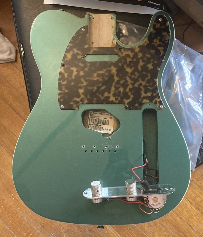

as i continued taking apart the Squier Esquire, i discovered much to my surprise that unlike literally every other Esquire body i’ve ever seen it’s not routed for a neck pickup. it shouldn’t be a huge issue because the Dremel is great at removing wood, but it’ll be more effort than i really want to expend. on the other hand, the Mad Cat-style pickguard looks even better than i imagined it would. i was afraid it’d be too transparent, but it’s not at all. i think this will come out as nice as i envisioned it. i'll have to redrill the bridge bolt holes, though, because the Kluson bridge has different hole spacing.

i'll also need to open up the Lido body's bridge pickup rout a bit because it's just enough too small that the pickup rubs against the sides of the rout.
Posts: 14854
i fit the parts together on the Lido body and it looks like everything should line up. it's off in the photo because the pickup pushes the bridge plate out of position due to the rout size issue mentioned above, and the pickguard contour isn't quite right for the body which is most likely an issue with the body shape. but i can probably live with that. you can also see just how ratty the fingerboard is...the laurel board on my CV Mustang Bass is worlds better. but caveats aside, it sure does look like a fucking Esquire. once i get a jack plate i could wire this puppy up. i'm pretty sure the only other thing i need is strap buttons and felts.

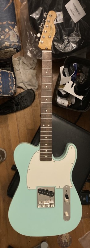

working on the Teles is weird...in order for some parts to be placed properly they require that others be present, e.g. to install the pickguard you need the neck to be on to be sure it lines up and you need the pickguard to help assure that the bridge is going on straight. you also need to remove the saddles to access the bridge mounting screws. i'll have to file the Mad Cat guard a bit because it's longer than the body rout, while the Squier guard is a bit wider than the pocket and should probably have vertical shims on either side. all the drilling is really nervewracking because it's among the more destructive operations i need to do. theoretically fill-'n'-drill is usually an option, but i'm still not comfortable with it.
i'm going to try a new thing to hopefully get the holes straighter, that being using a small bit in the Dremel to do starter holes. it's much lighter and easier to hold than the electric drill, so it should be commensurately easier to align.
