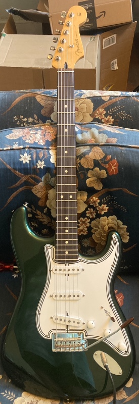

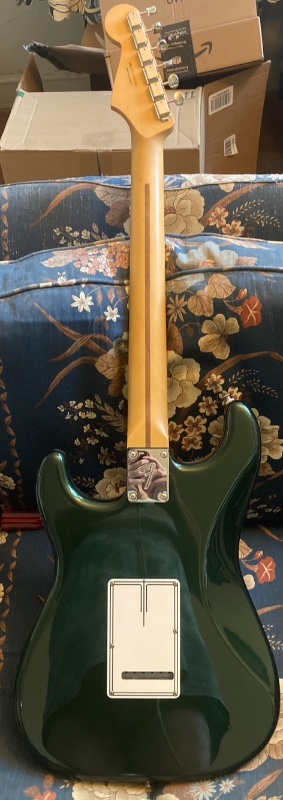

since my stuff was delivered yesterday, i got the replacement Strat knob and put it on today. i had to ream the aperture out with a 1/4” drill bit so it’d fit the 1/4” shaft on the Tonestyler pot, but the material is soft enough i could hand-ream it with the bit. i didn’t want to risk drilling through or breaking the knob with a rotary tool. it only took 15 minutes. a round of pickup and truss rod adjustments and it’s essentially done so glasses up, everyone! something’s finished.
mods included Fender CS ‘69 Strat pickups, nickel-plated flat jack plate, Stellartone Tonestyler tone switch, Decoboom “Streamline” pickguard and back plate, knobs and tips by Xentric Guitars of Colorado.

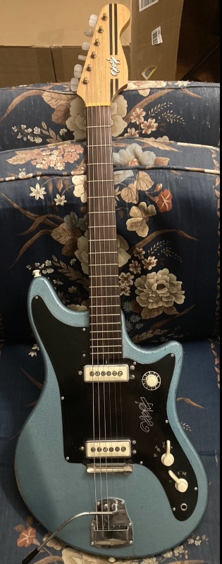

i also put the Hopf back together. the filler didn’t have the greatest surface either bare or painted with the black lacquer marker, but it turned out not to matter much because with the bridge placed for proper intonation the feet cover most of the holes/patches. i guess that sitting for a few months let the neck settle into its working tension—it had never been installed—and this may have helped make it possible to remove the shims from under the bridge. with them gone the guitar is noticeably more snappy and resonant. i still need to reset the pickup heights and polepieces, but that’s not so difficult. so that’s two, count ‘em two guitars finished today. too bad i can’t keep up this pace.

i dialed in the Hopf tonight, and it’s so much better than before. it used to sound kind of nondescript and dull, but now it’s positively snappy and sounds like i hoped it would back when i decided on the pickup swap. i could use it in a standard rotation now, though it’s still a bit fragile. if i put a wedge in as a neck shim it’d help a lot, but i’m not prepared for that level of fabrication right now. it could also use a bit of fret leveling, but as long as i can get away without it i will. i did have to sand one fret a bit under the A string so it wouldn’t buzz, but happily that was simple.

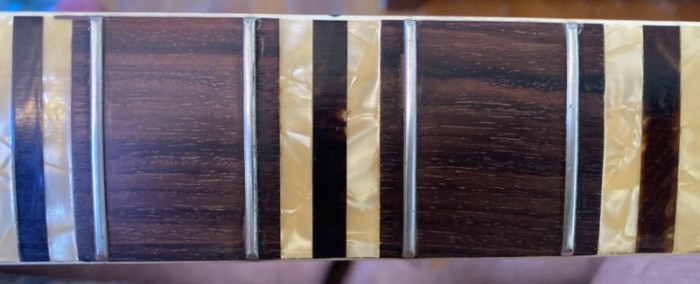

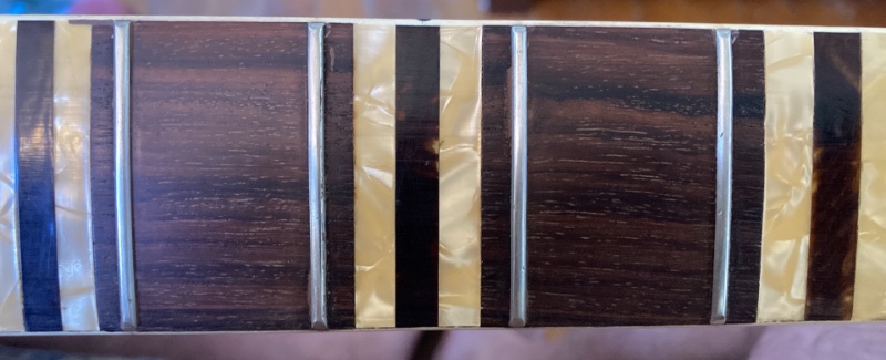

while waiting for Becky to be released from the hospital—she needs me to drive her home because she came in an ambulance—i’ve been sanding the parts of the fingerboard that were treated with grain filler but never sanded. four frets in it’s clear that i was wrong about it not working well on those areas…on frets 3 and 4 you can see quite a number of filled cracks, which show lighter on the dark background.
zoom in.
zoom in.
this makes finishing the neck simpler. i can just do the wood down to 2000 (my nicest is 1500 now) and it’ll be sorted, and then level the inlay stripes and knock down the wood on either side a bit. then if i knock out the back of the neck pocket and line it up i could mount the neck. i think i’ll do more polishing on that first.

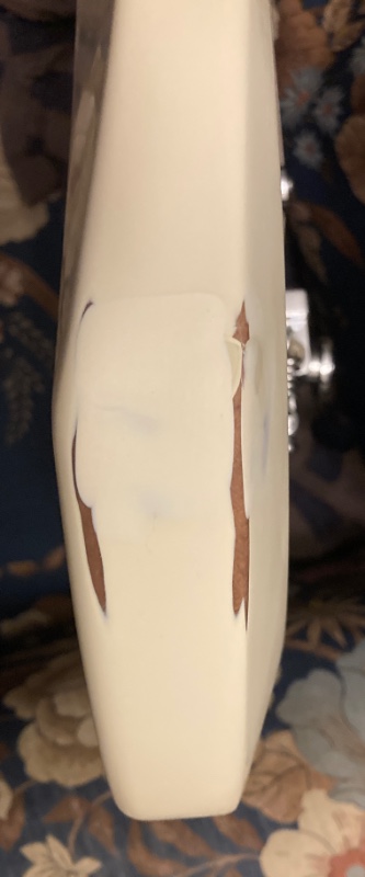

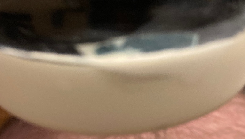

photos of the Jetstar work:
here you can see that the original crush dent is completely covered and smooth; you can see a bit of the original fill from the seller near the top on the right, the darker grey-brown. if the primer does its job the remaining stuff should be reasonably easy.
sorry the photo sucks. i tried several times. the color isn’t great, but the curves and planes are smooth. again, primer should help a lot.
i’m not dying to do another coat, and a lazier person would just cut to the neck repairs, but if there’s anything to learn from my saga it’s that little things count in the big picture. hopefully the next pass will be done and sufficiently dry to give me something to be thankful for on Thanksgiving.

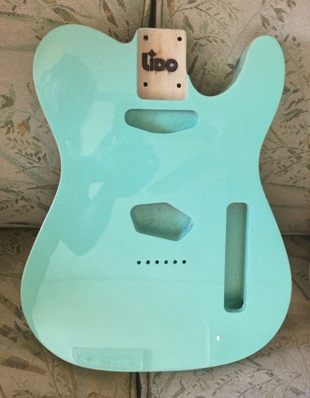

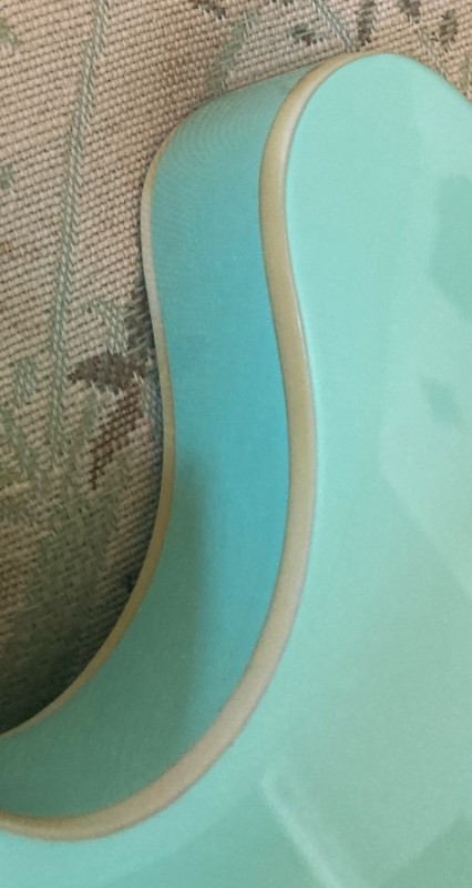

the GFS Lido import-spec Tele body arrived today. at first glance it seems nicer than the Jazzmaster body i got for the Galaxiemaster. i don’t see the kind of visible segmentation of multiple pieces here, or the same degree of orange-peeling. there are weirdnesses, though. GFS seems to have a real problem with color matching…the Fiesta Red JM body is more like coral, their Daphne Blue is rather more greenish than Fender spec, and their British Racing Green is more like forest green. the binding is also oddly variegated, yellower in some spots than others. i can live with it, but it’s peculiar. i think it’ll work. all the hardware and the Squier neck will get transplanted to here.

i decided to work on the Höfner fingerboard some more, and made a lot more progress than i expected. after trying to file down the wood bits on either side of the inlays on the remaining part of the neck with some success, i decided to try filing the entire area between those frets to get the inlays, which shrink at different rates and had uneven surfaces, flat and i’m quite pleased with how it came out. i went back and worked on the 12th fret some more and also got it flatter, with the added benefit of evening out the color a bit. i’ve gone over the inlay fret areas with 800 grit, and will take it down to 2000 tomorrow. when that’s done all that’s left to do with the neck is fill that small divot on the board at the first fret. it’s a bit annoying because i’ll have to clean the carefully moisturized wood with alcohol to get it ready for the CA.
