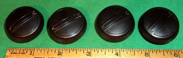

i found these absolutely brilliant vintage Bakelite RCA radio knobs on eBay that i think i’ll get for the Galaxiemaster. i need something in a pointer stylie for the pickup selector and tone switch and these have a nice low profile that won’t harm my knuckles. i’ve seen other examples with white paint applied to the crevices which would be even better but may be a pain to do. black on a light background is much easier if you use India ink.
they want 1/4” D-shaft pots, which shouldn’t be a huge problem because i can file down round shafts which i’ve had to do before.

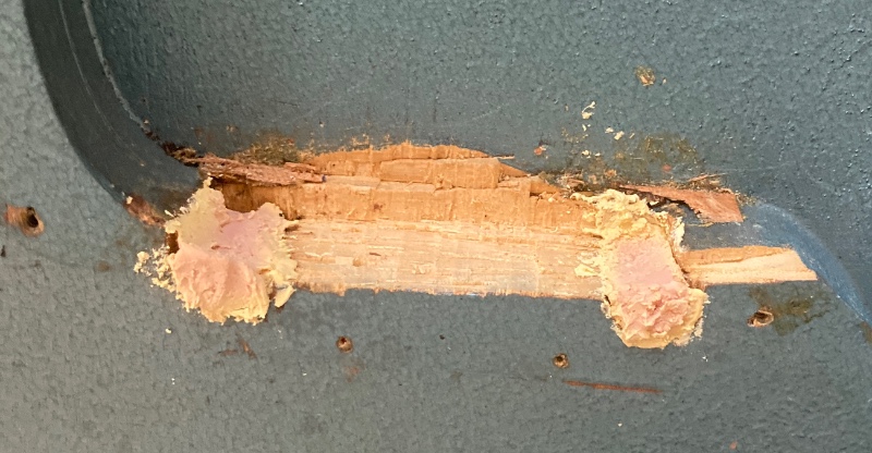

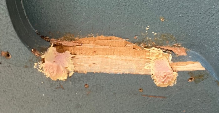

i got into the Hopf today and it turned out to not be too bad. the StewMac chisels did great at pushing back the edge of the rout so the bridge pickup clearance is sufficient. i mixed up some of the rosewood grain filler and taped off the open side of the bridge stud holes and packed them full of filler slightly above the level of the top since it’ll shrink when it dries. once it’s settled i’ll level it off and paint it black so it blends in with the pickguard.
to get it thick enough i had to mix more than was needed for the holes so i decided to fill the non-inlaid sections of the Höfner neck’s fingerboard because it’s by far the tiredest fingerboard i have. i think it’ll be an improvement once it’s sanded which it needed anyway.

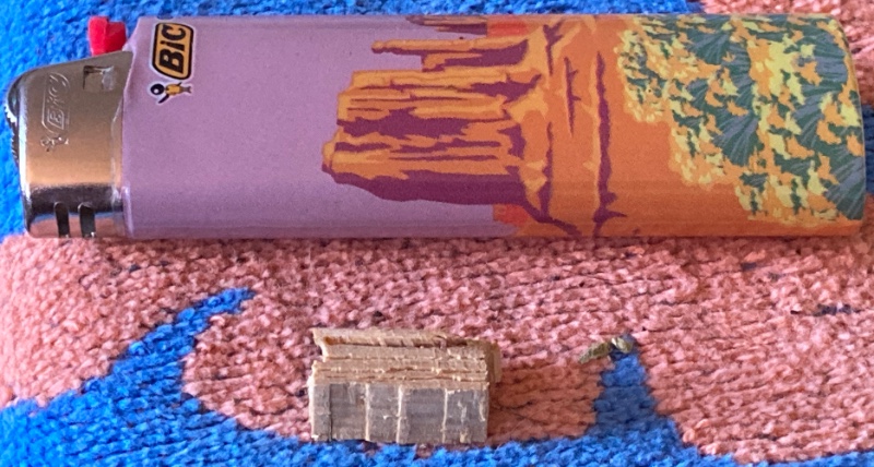

a side note: i’ve long been curious about just what material the Hopf body was made of, and while chiseling out the rout pieces came off and then broke into smaller pieces in symmetrical layers indicating that it’s some kind of laminate in layers about 2 mm thick. i’ve seen claims on the internet that it’s the same material as the neck and is probably pine or linden. i can’t confirm or deny this, but the neck resembles the Framus laminate necks which i believe were maple. it also seems unlikely that a pine neck would work with the neck’s tiny truss rod and adjuster. at any rate, it seems like plywood was the postwar German material of choice.
the grain filler didn’t work well for filling the bridge stud holes. i think i’m going to clear it out and go get some proper filler at Home Depot. i’m tired of trying to make materials do things they weren’t meant to do. there’s holes in the apartment walls that could stand to be filled as well. it’s not entirely dry, so there’s still a chance it’ll work.

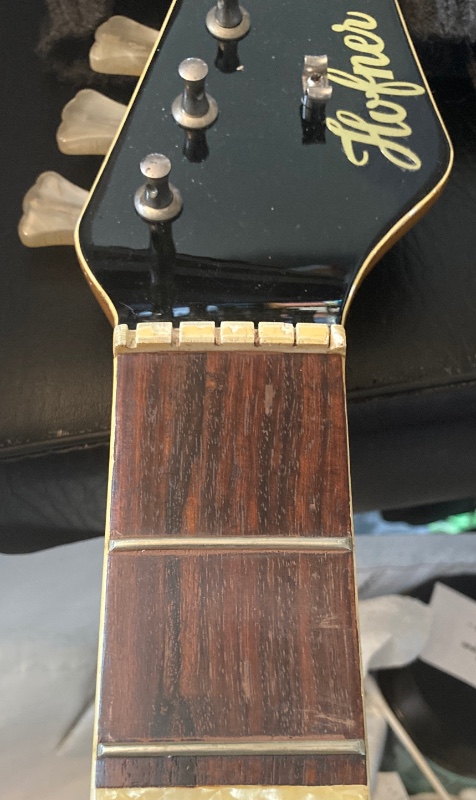

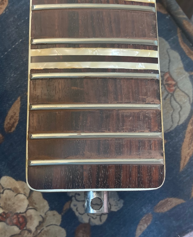

i gave up on the rosewood grain filler, which i think is like the colored Minwax fillers they had at Home Depot that say on the label “will not dry to a sandable surface.” it still wasn’t nearly dry so i dug and scraped it out and cleaned off the residue with a wet rag and a blade to get the glue from the tunomatic studs off. the normal Minwax filler i brought home is the same stuff i’ve used to fill holes in the concrete walls of my apartment, and i know how it works. it requests a clean, dry surface so i’ll let it sit overnight. i could do it now but i’m too pooped.
really hope that the aforementioned grain filler works well on the Höfner fretboard. it looks and feels pretty smooth for having only been scraped with an old credit card. if i could get away with only sanding to 1000 i’d be absolutely delighted, but i expect it’ll want the same 1600/2000 treatment as the other rosewood board work i’ve done. if it works well here i’ll take a look at the other guitars that could benefit, the most likely candidate being my weary Epiphone dreadnought. i’m not going to try to fill the trenches between the first few frets, though, unless i find some product currently unknown that does a better job of it. that would probably be biting off more than i could chew, especially since that would really need refretting as well which i absolutely am not going to mess with.

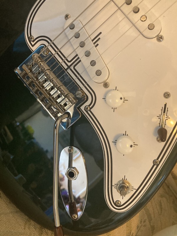

the Strat knobs arrived. unfortunately one of the small barrel knobs was broken in transit, but Xentric was really nice about it and the new knob’s already in the mail.
they work really well…they’re big enough to grab and small enough not to snag anything, and they’re the right diameter to show almost all of the embossed design around the holes in the pickguard. they're also knurled with less abrasive relief than most barrel-style knobs. having seen them i like them better than ones that would match the tips. the tortoise knobs idea came from old British sport and racing cars which combined a British Racing Green finish and lovely burled wood paneling in the dash and interior. wood wouldn’t be practical because you wouldn’t get much pattern in pieces that small so tortoise was the next close thing. i think having all the knobs that material would be too dark. when viewed at a less oblique angle the marker dots on the knobs line up with the center line of their group of lines.

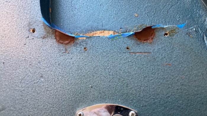

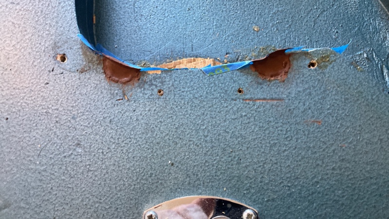

i felt like doing a bit of delayed stuff when i got home this morning so i filled the Hopf body’s bridge stud cutouts left over from early work versions. since i had the pot of filler out i also did some screw holes in my living room walls where previous tenants had mounted stuff. the guitar actually looks better than the walls at this point, though as the incomplete change from bright pink to beige shows it’s not completely dry yet. when it’s ready i’ll sand it down to be level with the top and paint over it. note the area between the holes where i removed wood so the bridge pick doesn’t snag on the wood.
i sanded the highest and lowest frets’ board area. results were mixed…the top fret looks and feels like glass, but the filler didn’t stick to the most relieved parts of the space on the bass side of the 1st fret and was only partially effective at filling a divot between the 2d and 3d frets (visible as a light spot in the photo). i’ll probably use CA to fill that, and sand the grainy bits more. i think overall it’s an improvement, but need to finish more of the fingerboard before saying for sure. note: the sanded areas were treated with lemon oil after sanding with 1500 grit only. i need more 2000 grit to really nice up the board which is what i used on the Alvarez.

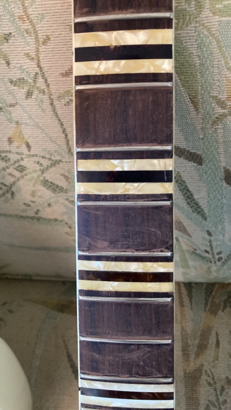

when i talked about the Höfner neck’s grain filler i forgot that the frets above 10-12 (closer to the nut) hadn’t been sanded at all. i went at the first fret with 800->1000 grit and it’s almost nice enough to skip the 1500 though i won’t. once i’ve dealt with the filled areas all that’s left will be leveling the other inlay bands. one more stop on the way to getting this Rube Goldberg plane off the ground.
