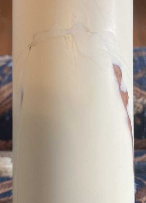

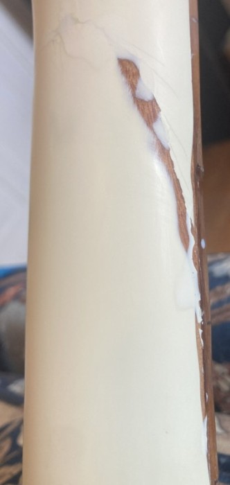

i got a bug up my butt about filing down the CA fill along the bass side of the Jetstar fretboard, and wound up sanding down the first coat on the neck. it's actually better than it looks in the photos, which prominently display cracking in the original finish and differences in texture that are less obtrusive in person. i got it reasonably smooth with 1000 grit, but i think the other painted bits should dry longer...some of the paint on the neck wasn't quite cured. i'll mix up some more of the tinted Vintage White and do another pass on the neck presently.
to get everything smooth i wound up having to take off some of the finish along the fretboard.
here you can see the filled area along the edge of the fingerboard which is darker than the rosewood.
i'll tape off the edges of the fretboard before the next coat. it's problematic because i need to do thin coats so the paint behaves properly, but it's not really dense enough to hide the bare wood unless i gob it on. i may have to accept that i can't get a near-perfect visual result on the neck unless i come up with some primer or something.
the other areas actually look like they're pretty well covered, but as noted i'd better leave them alone for another couple of weeks (yeesh). but i'm making progress on the neck so i'm happier.
