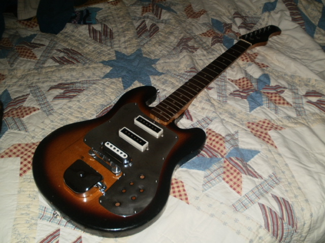

well, since all the rest of the bodies and stuff arrived yesterday, i thought i'd give you a tease of the next one to be completed. this is the Kent Copa body with two original Kent PUs and a 9.5kΩ Guyatone PU in the bridge, the Hondo neck from the 70s, a Bigsby aluminum bridge, and the eBay mystery tremolo. i'm going to try a rotary tone switch if i can figure out an efficient way to wire for the three PUs...perhaps the six-way toggle they sell at StewMac.

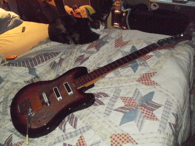

here's the progress on Kendo, the Kent/Hondo hybrid. the neck holes have been drilled, a new bone nut profiled and slotted to replace the funky plastic one that was on the neck when i bought it, and the mystery tremolo installed. i tried to place it so it covers the hole for the original tailpiece's spring plunger. the next thing i need to do is cut away the pickguard at the neck heel to accomodate the truss rod adjusting nut, which sticks out about 1/2 inch from the end of the fingerboard. after that, it's all about the electronics. i'm still trying to decide how to wire up the pickups, whether to use the six-way toggle they sell at StewMac or a rotary selector. if i use a rotary selector i'll basically have to use a normal tone circuit because i don't think there's enough room to cram two rotary switches into the control cavity. on the other hand, the six-way toggle costs $30, which is a lot of money for a fuckin' switch. anyway, Lulu seems to approve.

i haven't strung it up yet, so i don't know how well it works...i'm not going to put strings on it until i have the wiring sorted, because i'll just have to take everything apart again and there's a definite limit to how many times you can run screws in and out of mahogany before it turns to mahogamush. it feels good just playing with the bar and feeling the spring tension, though...it's got a nice sharp springback to it that feels different from any other trem i've tried, tighter than a Bigsby or Jazzmaster trem but not as stiffly demanding as a Maestro vibrola.
