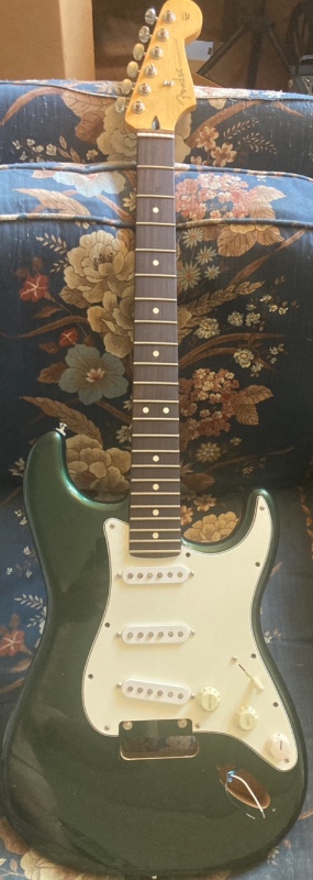

i got the pickups in, which was simple, and installed the Tonestyler which was not. the wiring in the Strat didn’t match the wiring diagram, because the positions of the tone pots was reversed. after puzzling it over for awhile i finally decided to just rewire it to match the diagram. so far, so good. but i can’t test it yet because the soldering iron battery ran out before i could connect the jack and the ground wire to the tremolo claw. when the battery’s live it’ll only take a few minutes to solder 3 wires. then i’ll tap-test the pickups to see if everything’s properly connected, and then string it up. assuming everything’s kosher i’ll move on to the bridge adjustments. i want it done by tomorrow night because i’m taking the as-yet-unaltered Supro and the Wandré to Charlie’s house so he can check them out…he says he’s been tempted by both but hadn’t gotten to play them, and i know the Tonestyler is going to blow his mind. it seems possible from here. i’ll see how it goes.
you can see here how much better the covers for the CS69 pickups match the pickguard. unfortunately the Tonestyler doesn’t work with Strat knobs because its shaft is D-shaped and requires set-screw knobs. i chucked a white MXR knob on there for now and it’s not awful, but i prefer matching knobs. there don’t seem to be set-screw Strat knobs available other than metal ones in various anodized colors that look weird. maybe i’ll paint some metal ones with the Vintage White nitro i got for the Jetstar. or maybe i’ll take the easy route and just get more MXR knobs. i’ll probably do another pass on the Jetstar before i switch over to the M-77T because i’m tired of these long-term unfinished projects.
Posts: 14854

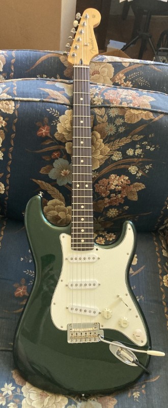

the wiring appears to be finished. i missed a couple of switch connections on the diagram so the first pass failed, but when i sorted them all 3 pickups worked in a tap test so i put the pickguard back on. by the time i finished it was pushing 10 so i stopped in order to wind down before going to bed. tomorrow i’ll re-mount the tremolo and string it up, after which will be another round or three of trem and string height adjustments. hopefully it should be pretty well done after that except for what to do about the knobs. i’m not celebrating yet, but i’m getting excited.
Posts: 14854
it's done other than final adjustments to truss rod/string height/tremolo springs to get things just as i like them. the Tonestyler is just as good as i remember it being; it's particularly nice that i can make the CS69 pickups sound like the CS 54 pickups in my sunburst Strat by using the first active position (the first two positions are true bypass and simulated load of a wide-open pot). it's much more versatile than a varitone, with only the most capacitor-ized position of the eight being too muffled to use.

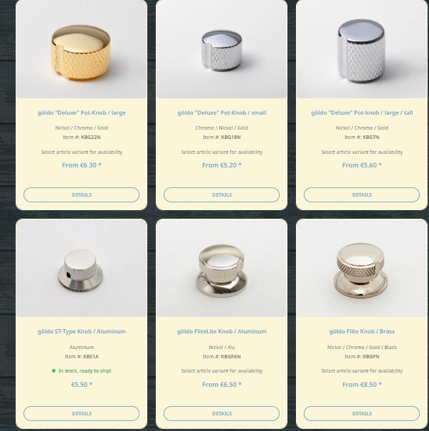

i'm probably going to order two more matching MXR knobs for the volume and tone pots, though i could go for three of the chrome Goldo knobs if i want to be chromed out.
goldo knobs.jpg (65.86 KiB) Viewed 2010 times

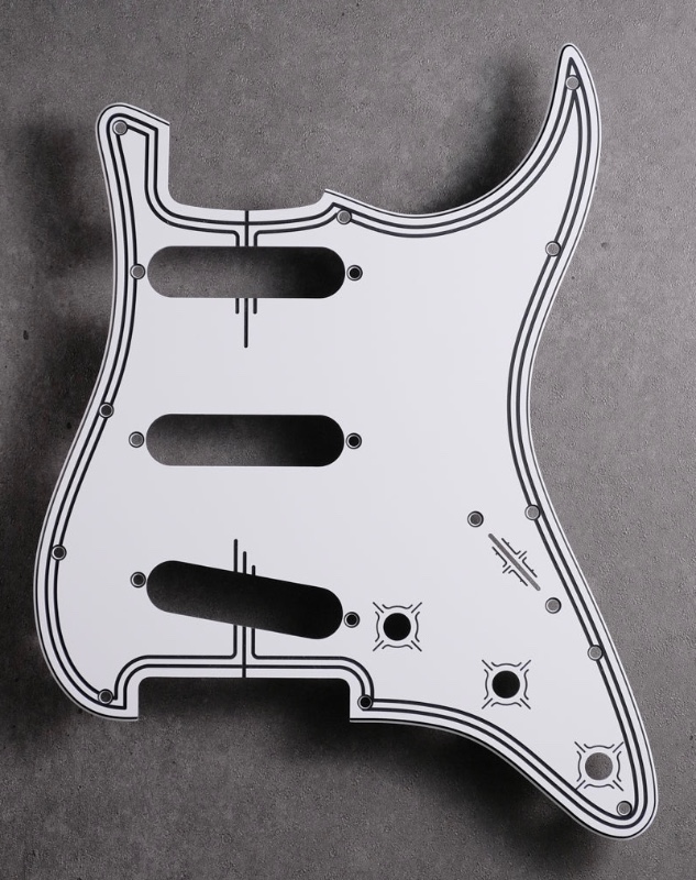

i decided to get a Decoboom pickguard for the Strat. the plain white guard is kind of boring with the deep green. unfortunately the back plate is out of stock so that’ll have to wait. i think this should work well.
the remaining MXR knobs are surprisingly being prepared for delivery and should be here today. the knobs and pickguard should be the final additions other than the back plate.

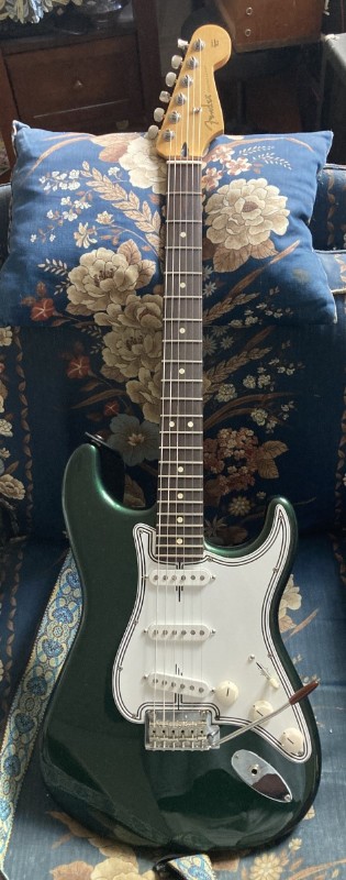

the tremolo tip i was waiting for arrived, so now the green Strat is done except for the matching back plate which i just have to wait for Decoboom to restock. i'm not entirely thrilled with the MXR knobs, but i haven't seen anything else i like better. but i'm very happy with how it came out. it sounds great, has a broad palette of sounds, and is very comfortable to play. if i was going to go play somewhere and could only bring a limited number of guitars i'd bring this one because it can cover so much territory.

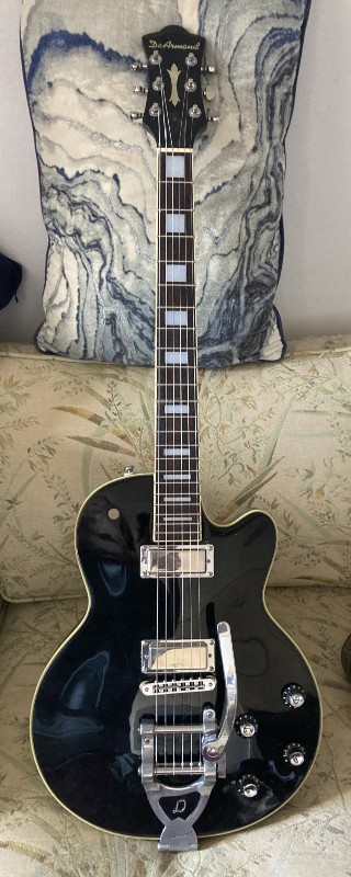

i have the M-77T out because replacing the pickups is near the top of the list, and when i looked at it sitting on the sofa i was suddenly struck by how much the black guitar with its Bigsby and the chromed Firebird rings looks like Old Black. which is funny because i've been a Neil Young guy since 1970 but never noticed it before...i was only seeing it as a Firebird pickup platform. after corresponding with Anthony at Pickguardian i decided to just order a stock M-77T pickguard and file/polish the cutouts as/if necessary; the footprint of the Firebird rings is maybe 1 millimeter wider/taller than the DeArmond pickups they replace so it shouldn't be too terrible. if i fuck it up at least then i'll know how the stock template needs to change. unfortunately he doesn't have an electronic file of the stock template. i'm waiting to order that until i get paid next week, but won't wait to do the pickups.
