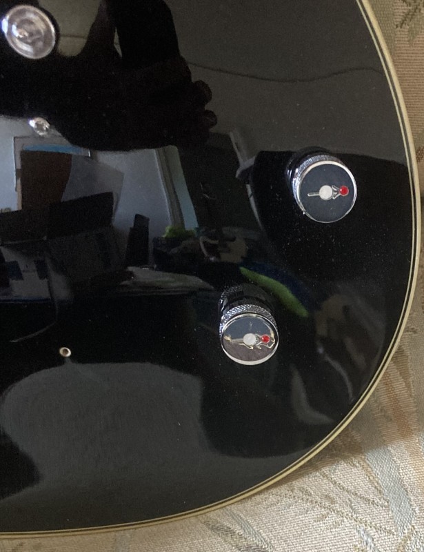

i got the new harness installed. i had to open up the potentiometer holes in the top and the jack hole in the metal jack plate because the new parts are US spec while the Pro Jets are metric. fortunately i had a round file of the right size and it didn't take too long. once the cables were pulled through the routs i put the control cover on to close it up for awhile. i'll need to get back in there again to connect the harness's ground lead meant for an archtop tailpiece with the guitar's ground lead that goes to one of the bridge post sockets, but not until after the pickups and switches are connected. i love the jewel-arrow knobs, which are the chromed version of the gold knobs on White Falcons. the only reason i don't have them on the Dyna Jet is because i chose the older arrow-only knobs that appeared on the earliest Duo Jets c.1953-54 which were Dyna-equipped rather than the later Filtertrons.
irritatingly the "black" screws i put in the most obvious holes from the B5 install are more "dark chrome" than black, so i'll need to get some paint on them along the way. next will be doing the enlargement of the neck pickup cutout, which i'm expecting to be the trickiest bit. i don 't think i'll go after that today because i want to take a look at the different pickup mount options for the M-77T's Firebird pickups which are supposed to be delivered today. i prefer the look of the metal rings, but the plastic rings might be better at supporting the pickups and keeping them properly positioned.

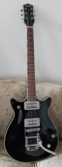

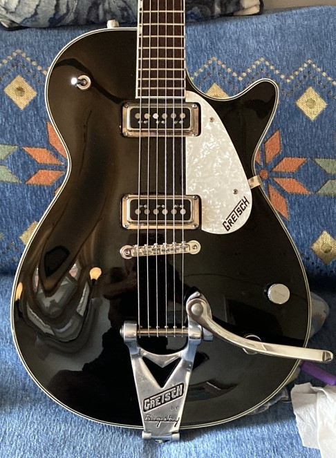

for review purposes here's a shot of the Double Jet before i took it apart. you can see that both pickups are crooked, and that the neck pickup's mounting ring has been crudely notched to fit against the end of the fingerboard; this was necessary because the pickup rout is too far north for the ring to fit properly because the stock mini-humbuckers didn't have rings but mounted directly to the wood in the pickup cavities. everybody who did this mod on the older Pro Jets cut the ring rather than fixing the rout. i'm mildly amused by the fact that the old owner positioned both pickups crooked by roughly the same amount. i absolutely hate that Gretsch and everybody else and their dog insist on mounting the flat-mount B5 Bigsby on arched tops where they don't fit right unless tightened down so much that they make indentations on the top which you can see on the stripped Double Jet. they do this on almost all of the Electromatic Jets; IMO at least they could do a B7 if they insist on the tension bar. here you can also see how clunky-looking the modern tunomatic is compared to the ABR-1 on the Dyna Jet. i basically had to rework things for it to be acceptable to me. i'm not going around with a sloppy-ass looking guitar...i have a certain amount of pride.
good god, i looked at the dates on the old Double Jet photos and i left off on it almost 5 years ago, September 2020. you know how time fades away. so long ago that the Gretsch Pages still existed. the silver Duo Jet pickguard i'm using on the DJ was given to me by someone from TGP. it was a weird forum with a lot of superannuated rockabillies who thought the Beatles "ruined rock 'n' roll," but there were some interesting and nice folks on there.
