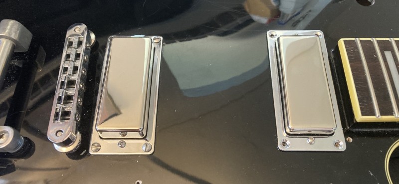

i managed to squeeze the Firebird pickups into the M-77T’s routs, but i’m going to have to take them back out and do some artful work with one of the thinner StewMac chisels because the tabs the adjustment screws go into are about 1-2 mm too wide and bind up against the sides of the cavity. they’re otherwise OK…the screw holes from the factory DeArmond 2K pickups are slightly closer together than the ones in the metal Firebird rings, but the mounting screws work with a bit of coaxing. i managed to find exactly 8 matching screws for the pickup rings that fit the covers and screw holes in the parts box. the metal rings were flat when i got them, but a bit of bending helped the screws to nail it down to fit the slightly curved top.

I think I’ve seen Gretsch-inclined folks use old mouse pads as spacers between pickups and rings and arched tops. I believe the magic is that it’ll compress where it needs to. I’m not sure that would have looked right with flat Firebird rings, though.

it took a little doing, but i got the pickups in. i used one of the narrower chisels from StewMac to take wood off the sides of the cavities so the tabs the adjustment screws go into would fit. when i started setting up the pickups before installation the screws from the parts box started slipping when adjusting the height; fortunately i found a small ziplok in the box that had held the M-77T parts which had the correct screws which are a finer thread, but they needed the ends ground off like the other screws because they were too long to fit. i haven't screwed down the neck pickup because the wires from the bridge pickup are too short to reach the switch cavity. given that the pickups spec as neck = 8.0kΩ bridge = 8.2kΩ i'm going to just swap the positions rather than muck around adding length to the bridge pickup wires. when that's done i'll need to wire up the regular Gibson-style toggle switch from the parts box...i have an actual wiring diagram for the M-75T with the correct color codes for the wiring so it'll be especially hard to fuck up.

i got the pickups installed per my last post with the neck and bridge pickups swapped. i had to take out the bridge pickup again because it needed different springs on the height adjustment screws so i can crank that pickup up to where the housing is almost coming out of the ring, which i may need to balance the pickups. if it's not high enough i'll order a Dynasonic shim to lift it a bit more. i restrung it and it's currently quite playable, though i need to do a proper setup once everything's wired up. i really ought to do the switch today...we'll see how my energy level is doing later on. i must say it looks badass with the Firebird pickups and Digsby. now that the pickups are in i can measure how much deeper i need the pickup cutouts on the pickguard to be; i'll have it made so the cutouts are as deep as the pickup rings so i can get it close to the surface on the upper end. this may wind up being my most dangerous project guitar. Firebird pickups, mahogany (well, nato...i always wondered what Warsaw Pact wood would look like before i got the Musima), shorter scale than an actual Firebird, and the Digsby. it should have serious teeth.

yes, the neck pickup is slightly crooked in the photo. i corrected it. that's what happens when you're using screw holes in a pattern slightly smaller than the screw holes in the rings.

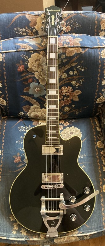

well, today was a day. i discovered the hard way that i’d totally misunderstood how the M-77T was wired…i did what i thought was correct and i got signal, but it was low-level and there was loud hum when i touched the pickup selector switch. turns out that it’s wired like a Les Paul where the pickups go to the volume/tone pots first and then back across the guitar to the switch. i think i know what to do from here because i have the M-75 as an example with the same type of switch (i went back to the original switch so i could copy from the M-75) and control layout. i got the switch wired up so it’s down to connecting the pickup leads, but by the time i was done with that i was pooped and my back hurt so i closed up shop. tomorrow i need to solder on extensions for the pickup leads, and then i should be able to connect them to the harness.
when i realized that i’d gotten the wiring backwards i needed to swap the neck and bridge pickups so the cables would reach, so they’re back in normal positions. i had to put shorter springs on the bridge pickup so i could raise it as high as possible…the longer ones wouldn’t let me put it all the way up by which i mean about 1 mm of the pickup cover still inside the ring. i also adjusted the bridge posts to get the treble side post short enough that it doesn’t stick up past the top of the bridge so i don’t cut my strumming hand on the end, and put one more #8 washer under the bass side of the Bigsby so it’s more level. assuming i can get the electrics sorted tomorrow all that’s left workwise are small things: the cracked finish along the sides of the fingerboard, the damage on the bass side of the 20th fret, and another round or 2 of polishing. when the guitar was on the sofa with its back facing out the sunlight revealed some areas dulled and cloudy enough that they were noticeable, and the front has some unfortunate scratches i’d like to minimize. so that’s where that’s at.
