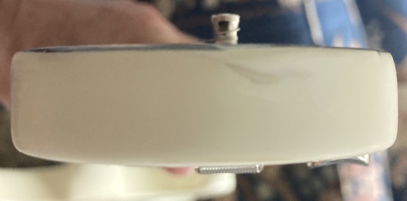

got an unexpected check yesterday that gave me wiggle room, so i ordered the Firebird pickups off eBay and found some lightly used metal rings on Reverb. by the time these parts arrive i'll be gone on vacation, so they won't get installed until after 7/5. polishing the guitar is coming right along; i have 1/4 of the top and the sides left to do, after which i'll go over it closely in good light to catch flaws. once that's done i put the bridge and tremolo on and string it up.
i'll do a second coat on the Jetstar bits today and then put it aside till Sunday or Monday, when i'll do some light sanding to level the surfaces and then do poly clearcoat over them. i'm waiting to see how the other parts come out before painting the neck which is much more important to get right.

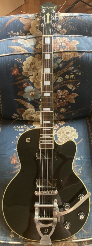

i finished polishing the M-77T and mounted the DeArmsby and the bridge. this was not without complications...the bridge posts screwed into the anchors OK, but once weight was applied one of them came out of the threads and dropped into the socket. i used the small strips of wood in the socket technique and both posts are OK now. the spring supplied by the seller of the tremolo has to have been non-original, because when i put everything together it was so much too tall that the handle was at a 45° angle to the top of the guitar. fortunately i had spare springs, so i put a normal-height spring in and it's fine. there's still a fair bit of adjustment to do; i particularly need to get the post height right so they don't protrude above the top of the bridge, which would chop my picking hand up. one nice surprise was that the neck appears to be reasonably straight and has about the amount of relief in the neck i'd shoot for, a bit more than some folks prefer but assuring fewer rattles. i’ll definitely have to shim the front screws on the Bigsby, because they’re resting on the back edge of the bridge body. but it’s all together and tuned up.
there are some small dings in the top on the cutaway above where the pickguard would sit. i considered doing something with them, but i really don't care that much. maybe somewhere down the road i'll mess with them. there are also a fair number of scratches in different spots, none of which are so egregious that they need treatment. i'll remind you once again that perfection has never been the goal; the goals are functionality and not looking like the guitars have been through the Tet Offensive.

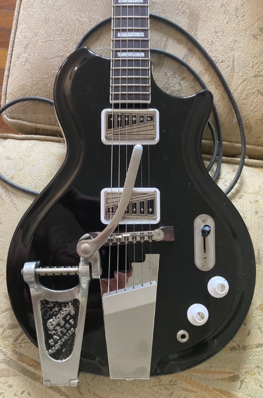

yes, but i ordered a modern Supro Black Holiday which has the advantages of being complete and lacking in vintage-destruction guilt. the Airline and Supro husks i’ve seen are truly beat. i had an alert on eBay and Reverb for “supro guitar.”
the other advantage of the Black Holiday is that it’s already set up for two pickups with a 3-position switch and pickup openings that should be close to what i need. all i should need to do is install the Bigsby pickups, change the bridge saddle, and install a Bigsby tailpiece. minimizing work is a new value in my project life.

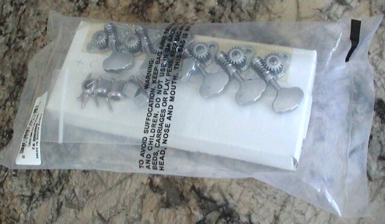

i went ahead and ordered the remaining bits for the Double Jet, those being a set of openback tuners from a recent Gretsch Electromatic that are higher ratio than the ones sold at fox-music (which unfortunately aren’t the same as the ones on the Oriole), and a simple banjo armrest which is something Gretsch started doing with the White Penguin and was a popular mod on the Gretsch Pages. when i’m done with the M-77T and Jetstar i intend to go directly to finally getting the Double Jet completed. i’ll be doing that while waiting for the Mojo PAB pickups that go in the Supro which take awhile to make. i’ll deal with adapting the TV Jones archtop wiring harness to a Jet-sized body first because it’s the part that worries me most. i’m glad i’ll have the tone switch which turns out to be more useful than internet chatter would lead you to expect. i’m also going to try to work on the Galaxiemaster body and neck. it’s still not out of the question for me to give up on the GFS finish, but the M-77T’s top is orange-peeled as well though not as badly so i may learn to live with what can’t be polished out. i’m really not interested in multiple rounds of sanding and polishing and may well just cut to the chase. i’m more interested in having it done than making it Just Exactly Perfect. i need to look at the neck and decide if i’m going to use filler on the fingerboard or not…i’ll test on one or two frets high up the neck to see how well it works. i’m going to order a digital caliper thingy from StewMac so i can precisely spec the pickguard which will be tricky.

some of the stuff arrived. i need to find my ruler so i can measure more precisely, but it sure looks like the Firebird pickups will fit the M-77T. unfortunately the pickup rings were delayed and won’t be here till tomorrow. the tuners for the Double Jet are also here. the embossed decorative motifs on the plates are a bit cheesy, but take a look at those gears! 15:1 i think. i’m tempted to take the Grover Sta-Tites off the Dyna Pro Jet and get a second set of these.
i did a second coat on the Jetstar bits and will do a third tomorrow; after that it’s going to sit till i get back from vacation.

the B6 definitely works better on the Supro than a B3 would. its break point is only a little farther forward than the stock tailpiece, and the handle is in a good place for how i use Bigsbys.

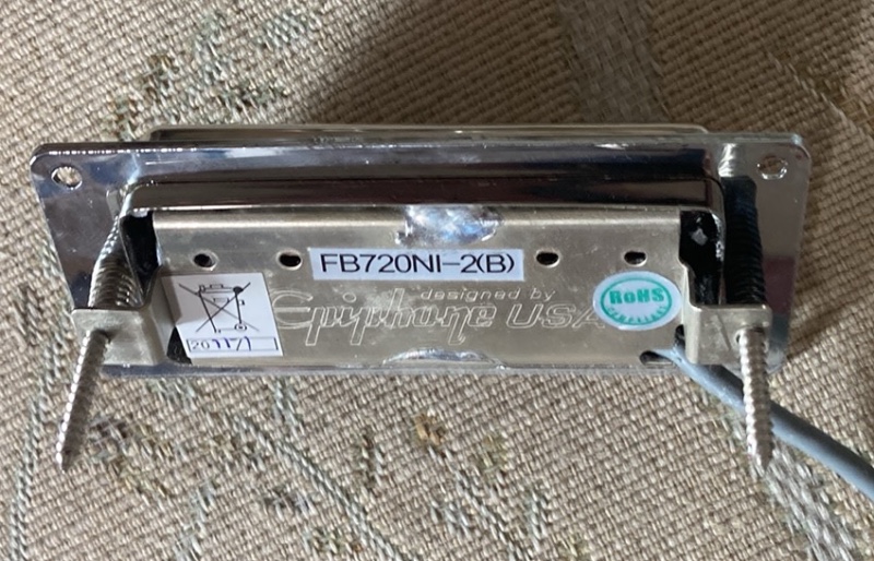

put the Firebird pickups and mounting rings together…they didn’t come with height adjustment screws but i had humbucker-length screws in Ye Olde Parts Box. the only problem is that they’re too long and will bottom out on the cavities, though the pickups look like they’ll fit just fine. i’ll use the Dremel to grind off the superfluous endage.
the pickups use an Epiphone solderless plug system that i’ll cut off. i still need to get the washers to shim the front of the DeArmsby and would prefer to do everything at once so this is a Maybe Tomorrow thing. today was tough and i’m about out of energy.

i played the Supro for a bit last night, and i think it's going to be perfect for the Bigsby pickups. it plays nicely, but the stock pickups just aren't right for my playing style. if i was still into fingerpicking blues and slide guitar like i was in the 70s-80s they'd be perfect, but they don't work for me now. they'd be great in a lap steel, though, so that may appear on the projects log in the future. i'm just waiting for the funds to be available to get the pickups. once those are sorted all i'll need is the compensated Bigsby aluminum saddle. contrary to what the Music Go Round guy said, the volume control works fine...it just has a weird taper that goes from 5% to full-on in the last half of the rotation, but that's fine with me. i seldom use the volume knob except to turn the signal off when i set the guitar down.

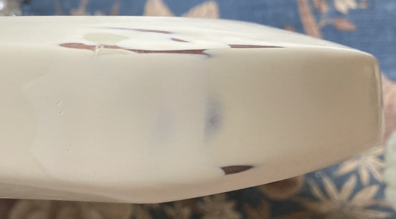

and i think the Jetstar paint is finally dry enough for sanding. i'll need to do another touchup layer on the body ding area, but i think the headstock should be good to go.

i sanded the Jetstar bits and am reasonably happy with how it's coming. i'll need to do a touchup coat on both areas, but the ding on the side is now completely covered and smooth...there are some spots where the original finish got sanded through that need a touchup. i'm really not happy with the 2-week drying time, which means i won't be done for at least another month, but i finally have a solution that works and matches the original color reasonably well. i guess i should do a coat on the neck repair when i do the touchups to get ahead of the sequence. i made it harder than necessary for myself by covering larger areas than necessary on the theory that it would give me wiggle room when sanding. lesson learned. i don't feel like stirring paint today, so this will probably get done tomorrow. next up is putting the pickups in the M-77T.
