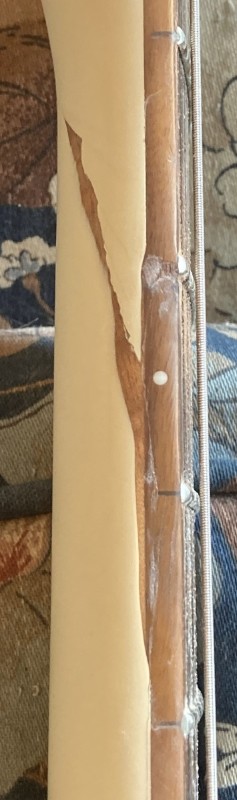

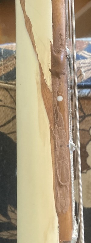

i decided the best thing to do first was to fill the divot left after i dug the white paint and filler out of damage to the fretboard on the bass side at the 2d fret, assumedly the main point of force in the break. that seems to be going swimmingly for the moment...the filler looks much more in tune with the paler-rosewood board than it did with the mahogany on the Kondor body though of course it isn't dry yet. i also spread a little filler over adjoining areas of the board edge which had white paint impregnated into glued cracks that i couldn't get out without doing violence to the edge. it's deliberately thicker than it strictly needed to be so i have a bit more wiggle room when reducing it. once that's dried and been sanded i'll clearcoat the divot and the exposed edge of the board in the adjoining areas, which is about 2 inches. there's another spot where the finish on the edge of the board is funky down by the neck join, but i haven't decided whether to redo that as well. when the clearcoat had dried and been sanded down i'll tape it off and start with the CA. i still plan to try the CA out on the body ding first where a lousy result would be less consequential. perhaps later, after more coffee.
Posts: 14854

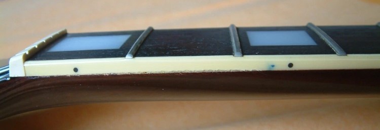

today's results were mixed. i think the side of the fretboard came out reasonably well, and some lacquer marker balanced it out a bit. i did a drop fill of clear CA for the divot after the photo was taken. the irregular edge between the fingerboard and neck will be taken care of when i do the painting.

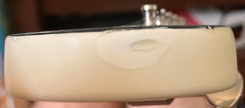

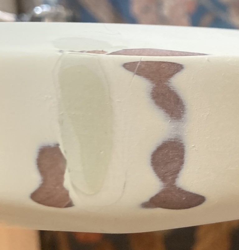

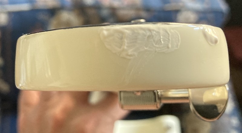

on the other hand, the side ding wasn't nearly as successful. i was able to mix a pretty close match to the paint color and get it applied consistently to the problem area. however, once again the (tinted) white CA was unable to cover the darker imperfections. it was also a screaming bitch to sand, and in the process some additional spots got the paint sanded off. you're supposed to be going in the opposite direction, dammit.
at this point i'm declaring CA, at least in the StewMac formulation, ineffective for finish fixes other than small drop fills. i'm quite disappointed given that they represent otherwise. i guess the next thing will be to find some Vintage White paint that won't fuck up the extant poly finish and go for a Kondor-style coverup of the bad bits. i'll still find some way to make it look OK, but i really didn't need the letdown on a Monday. oh well. i won't get back to this till Wednesday because i'm going out to Becky's straight after work and thus won't have time to shop.

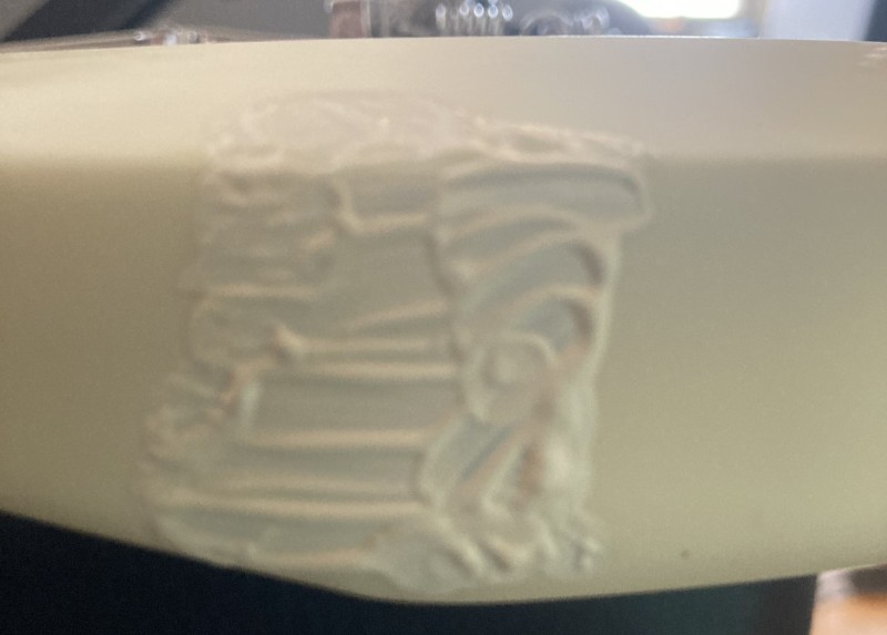

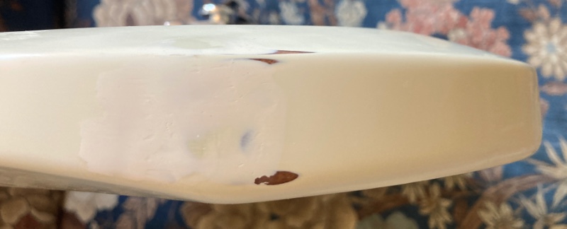

i found some satin finish Vintage White craft paint at Michael's which isn't quite an exact match, but it's pretty damn close. it wasn't doing a terrific job of covering the dark spots so i rather troweled it on. i'd rather sand more than sand through. the headstock seems to be coming along quite well, and i'm managing to get a decent straight edge between the black face and the white side.
the side looks to be a bit more challenging because of the dark areas of exposed mahogany. i'll do another coat here and then carefully sand down till i get a reasonably flat surface.
assuming i can get a decent flat painted surface, the rest should be relatively simple. a couple of coats of clear brush-on poly, some judicious sanding and polishing, and we should be rolling. they say to leave an hour between coats, but i'm not doing another till the afternoon (it's 0845 now). if i have one big takeaway in filling and sanding, it's that it almost always takes way longer for something to dry and harden than it says on the can. but i feel better now...i may not be able to match the OG paint perfectly, but at least the flaws won't be visible from 3 feet away. it's also possible that the clearcoat might balance out the colors as happened with the sides of the Kondor body.

second coat on the side ding and headstock edge done. now i have to do something i'm not good at doing, which is be patient and let it cure before going at it. i so want this to be done, because it's been an inordinate pain in the ass and because it's going to be so fucking great when it's done. but i'm not there yet.
Posts: 14854
sanded down the first pass this morning. once again the headstock is doing better than the body, since it’s a smaller area with simpler problems. it sanded down pretty well, using 1500 and 2000 only to keep from tearing up the uncured white paint.
since everything else is bearable—i may do something to color the acrylic depending—i put a small second coat on the visible dark area and am hoping for the best.
the side damage is much trickier to deal with because of multiple planes and multiple hues to conceal. it didn’t come out wonderfully, but i think there’s still potential for a decent fix.
similar to the headstock tactics, i applied a thin coat of white on the problematic dark spots and will go back tomorrow and carefully sand as little as possible to get a flat surface. if it looks good tomorrow, great. i might try putting some poly clearcoat on before sanding to give a bit more leeway. otherwise it’s back to the drawing erm, painting board. i swear that if i have to spray Vintage White auto paint into a can and paint it with that, i will.
looking at the photos i actually feel a bit better because they remind me of being able to fix the color problems o. the Kondor body. someday it’ll be done.

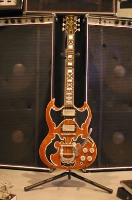

i had an interesting idea about the Jetstar which is inspired by John Cipollina's SGs which in the early stages of development had the equivalent of 1961-style pickguards on the left side as well as the right; his fully-developed aesthetic owed as much to Batman and surfing as it did to Kalamazoo.
he did all the modifications to his guitars himself.
cip sg.jpg (28.63 KiB) Viewed 664 times

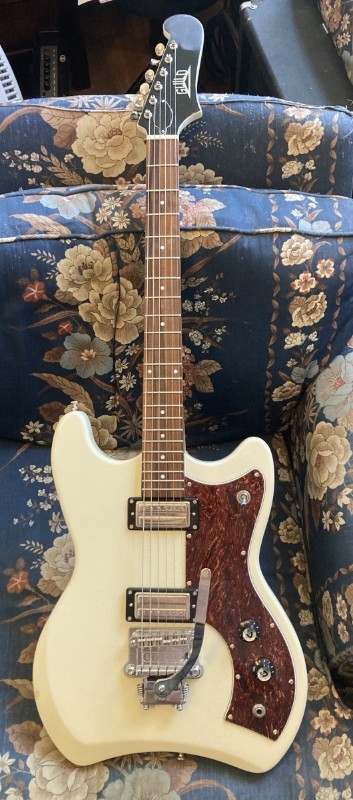

i've considered adding a left-hand pickguard to my Epiphone '61 SG, but kind of don't feel like it needs the added visual clutter. the Jetstar, or the other hand, has a huge expanse of empty literal white space for its left side. i could ship the existing guard off to Pickguardian and have him make a duplicate of the OG guard and a mirror-image left-hand guard with nothing but the screw holes. that would also give me the opportunity to get a bit nicer quality of tortoise patterning than the stock guard. i suck at photo editing, so you'll have to use your imagination (to think of good reasons to keep on pushin' on, ooh yeah). so at some point in the near future i'll take a big sheet of paper and trace a template i can flip to be sure it'd work with the slightly different body and cutout contours on the bass side. it also reminds me of those Gibson J-200s, and the J-180 Everly Brothers model in particular, which had guards on both sides of the soundhole, and of some of the more antic Airline and Kay designs.
no doubt about it, if i get to go out playing imma be known in Charlottesville as "that little old guy with the weird guitars."

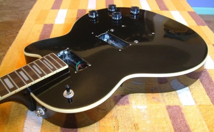

there's a possibility that yet another DeArmond may become part of my life. there's a husk of a M-77 on eBay for like $120; there's finish cracking on both sides of the fingerboard that could indicate a blow to the neck, but everything looks ("looks") stable. there's also a DeArmsby, which are rare as hell. i was pondering this and it struck me that those routs would be just exactly perfect (h/t Bob Weir) for Firebird pickups. so that could go from concept to realization really quickly. the husk is missing the bridge, but the knobs/pots are there so it wouldn't take a lot of assembly. and that'd tick off another box in my Pickup Types I Still Need list.
Posts: 14854
while i was pondering this, the seller dropped the price from $139 to $119, and i couldn't pass it by. i used various forms of PayPal delayed payment and ordered the husk and the DeArmond Bigsby at once. i also got a set of black DeArmond knobs to replace the speed knobs that just popped up today. so now we wait. it appears that the wiring is intact sans pickups, and the only other things missing are the bridge and bridge posts, which i'm pretty sure i have in the parts box after removing them from the Jetstar. so essentially i get the bits, screw them together, order a pickguard, get some Firebird pickups (leaning towards the Johnny Winter set at the moment), wire them up, and presto! another cheap weapon of a guitar with pickups i love in it. and a Bigsby!
you've seen a lot of M-75 bodies here...this is to illusatrate the generally good condition.

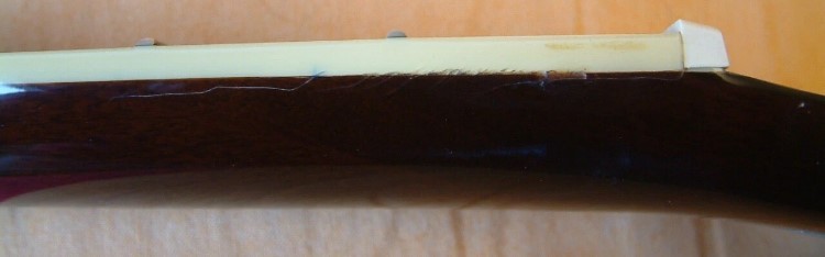

you can see that something messed with the stability of the connection of the neck and fretboard. on examination, though, it doesn't look like anything's been knocked significantly out of place, though i wonder about the white area beneath the end of the nut in the last photo. it shouldn't take too much to sort it out. if it works as-is i'll just fix the finish and move on. i asked my friend Charlie, who's been at this even longer than me, what he thought and he said "i've had guitars that looked like that for years and nothing happened. i also had a guitar like that that did need to be fixed and after glue and a clamp it was fine."
