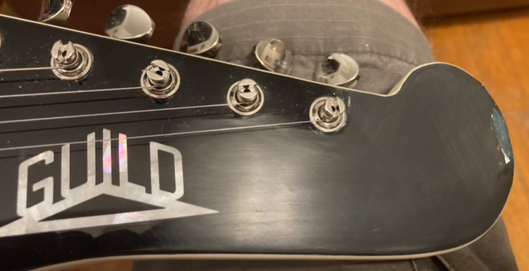

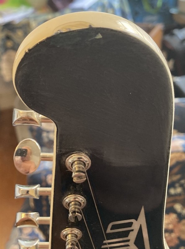

i started sanding the headstock. i’m pleased to note that the medium-weight CA dries to a nice consistent density that is hard enough that it’s a bit of a chore leveling out the irregularities in the dried glue. i think it will polish out just fine, perhaps needing a coat of brush-on poly if it won’t buff out on its own. i’m taking this very slowly because i don’t want to have to do this again.
ordered more CA-related stuff from StewMac: aerosol accelerator for the glues so i can work more quickly in thinner layers and avoid unevenness, a plastic mixing palette CA won’t adhere to, and a bunch of plastic dropfill toothpicks which i trust more than pooting glue out of the bottle via a “whiptip.”
once the black headstock work is reasonably “done,” i’ll build out the ding in the white-painted side of the headstock. this will be my testbed for mixing the correct tint to match the Vintage White i.e. slightly yellowed hue. when the headstock is sorted i’ll use some of the fingerboard grain filler to build out the ding on the left lower bout, which was helpful when working on the damage to the Kondor, till it’s close to the necessary height. obviously i’m leaving the neck for last. i don’t know if it would be better to work CA into the finish cracks, or to sand that area down and use the CA like repair paint. leaning towards working it in, which i think will preserve the neck contour best.

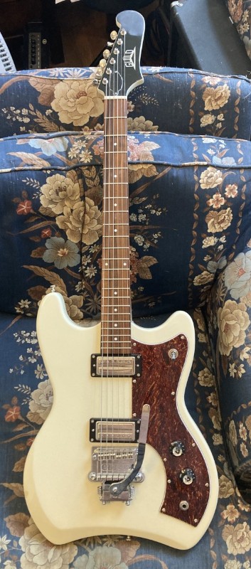

i’m eager to have the Jetstar in full service. i’ve been playing it in between work sessions and with the new Stetsbar handle and the pickups swapped front-to-back and cranked up it’s an absolute beast if a well-mannered one. the trem has a Bigsby feel but is a bit more precise…it’d be perfect for playing “Marquee Moon.” it’s kind of like a Firebird’s cousin that goes to continuation school, huge on the bass pickup and snarly on the bridge especially through the AC15 with Top Boost on. i’m slightly tempted to add a third LB-1 as Guild calls them nowadays, but i can resist.
it’s kind of amazing how the idea of taking pickups from what for all intents and purposes was a dead guitar to put in the sparkly blue DeArmond wound me up with two guitars that work so well for me that i have a non-tremolo M-75 coming in.

i sanded the end of the headstock face with 800 grit until it was reasonably smooth. i stull have a couple or three lighter weights to do before polishing so i'm not tremendously concerned about having it perfectly smooth yet. the CA is solid enough that it was tough to sand through the excess from my layers of glue, so i feel pretty good about it as a minor structural element. the biggest problem is that the glue dries to a blueish-grey that doesn't match the paint, but i can just go over it with the black lacquer pen. the light triangle happened somehow, i'm not sure exactly how. it's a vuisible defect only; you can't feel it when you run your fingertip across the surface. it'll also get touched up. there are a few places where the black slipped under the masking tape, but they'll either be covered by the white CA or scraped off with a blade. the actual edge looks reasonably consistent. i'm now a lot less worried about getting an acceptable result on all the damaged areas.
it's beginning to develop a vibe of its own. it looks ready to jump up and bite you. like Casper the Friendly Ghost's evil ghost nemeses. the replacement handle is more consistent with the design's Alternate Futures Of 1962 feel, while the round modern handle similar to a Les Trem was anomalously REAL-modern. the new handle makes it look more like something off a 60s Italian or British guitar.

sanded the headstock down to wet sanding with 2000 grit. i think it’ll polish out just fine, but will definitely need touched up with the lacquer pen. the filled part is nice and smooth to the touch, and the filled area is pretty well as flat as the surrounding surface. i’m going to leave it for now and wait for the CA accelerator to arrive before starting on the white edge. i see no point in polishing out the face before the edge is also done…you KNOW something’s gonna fuck it up. the StewMac stuff is due on Wednesday, along with a bunch of other stuff including preamp tubes for the AC15 and the DeArmond M-75. woop woop. i’m finally making progress on this thing.

looking at the most recent full photo i’m surprised once again by the great difference in feel and “rightness” a small thing like changing the tremolo arm makes to the overall vibe. i’m reminded of how much more like itself the Epiphone SG looks with the new/correct bridge and tuner buttons.

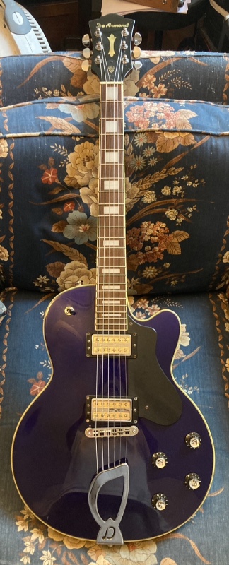

the current Jetstar thread is going to be derailed briefly by me getting the DeArmond M-75 that just arrived set up and in service. it’s generally in good shape, but there are a few minor issues that need to be sorted.
it’s literally the little/big brother of the blue sparkly DeArmond M-75T i got last year, in a Very Serious “Moon Blue” finish that’s almost black under indoor lights. the DeArmond Gold Tone pickups are the attraction here, a uniquely DeA take on a humbucker with a second row of flat polepieces leveled just below their apertures in the cover. they have more air in them than PAFs, and a POP to the pick attack that’s almost a DeArmond signature. when i cranked it up last night before destringing it and starting the cleanup/tuneup phase it sounded great, snd more importantly sounded like me.
there aren’t a lot of issues, but there are a few annoying little things. there are some deep scratches in a couple of odd places, two small dings on the edge of the headstock, and an area where the harp tailpiece meets the top that had 30 years of crud under the base that disrupted the finish a bit. the frets could stand a polishing but are in good overall shape. when it arrived the action was too low for me, but the guitar played without buzzes and rattles all along the fretboard indicating that the neck is reasonably flat and straight.
one irksome aspect is the knobs and other plastic parts. 3 of the 4 knobs exhibit some chipping around the upper edge; i hope to build those out with the black CA and strategic shots of accelerator. the toggle switch knob broke while i was handling the guitar for cleaning. i had spares in the parts box so it’s fine.
i need to decide whether to polish out the pick scratches on the top between the pickups that extend out an inch or 2 on either side, or just call it battle scars and move on. the pickguard is so scratched-up that i ordered a new one from Pickguardian…it was only $25 which is worth not having to spend several hours doing tedious hand work.
today’s agenda is remounting the tailpiece and bridge, stringing it up, and setting the pickup heights, polepieces, bridge height, neck relief, and intonation. when i played it briefly before starting to work on it it sounded just like me even with half-dead strings. i’m well on my way to having a little battalion of Guilds and Guilds Lite, and i couldn’t be more surprised to have taken to them as i have. when the Double Jet is done i’ll have the same number of Guilds/DeArmonds as i do of Gretsches.

still in the early phase of accessioning the M-75. i started out setting the pickups by balancing everything on the bridge pickup to the B string which sounded best to me and then bringing up (or dialing down) the neck pickup to balance it. my first set of adjustments sounded good, but the pickups were too close to the strings so if i hit a loud 3-note chord in the middle of the neck the preamp tubes would distort. is that what normie guitarists mean by "hitting the front end of the amp"? as mentioned these are the hottest pickups i've ever used other than those insane 12k P-90s in the Wildkat. so i backed everything down about 1.5-2 mm which helped a lot. probably going to go a little lower still...i've found that doing this kind of setup works better if i do short bursts of activity and then let my ears recover. they need to do that because in order to hear what a guitar's doing i really need to hear it at a level louder than casual conversation, and if i overtax my ears everything just sounds grey and flat as if my ears had dog vision. i fiddled with it at 8-8:30 so i should be OK now. it's a fine line here, as it often is with the kinds of guitars and pickups i favor, between showing excessive character and not hitting hard enough. i still want them to sound like hot trebly humbuckers, just not hot trebly humbuckers through a cranky Pignose.
i need to let the truss rod out just a bit and lower the bridge commensurately...the lower strings can get a bit rattly. there's also a variety of other annoying small issues to catalog and fix: scratches and dings, a missing teflon washer on one tuner, a bit of corrosion on a couple of frets. and i need to spray out the pots and switch. the switch pops like you'd expect when using it as a kill switch (FWIW i have never had a guitar, US or imported, with a 3-position toggle switch that didn't pop at least a bit when doing this), but the pots seem pretty clean. i'd like to put the silver-mica capacitors in it that i have in the Dyna Pro Jet and the SG because they actually do pass a bit more highs than most capacitors, but looking for them online made my head hurt something awful. i should stock up on them assuming i can find them, because they might be nice additions to the Wandré, Jazzmaster, and the putative Supro/Bigsby and baritone Jazzmaster projects. other than the SG which really needed help and the M-75 which is naturally toppier than a PAF the idea of silver-mica caps in humbucker guitars doesn't appeal. they don't need augmented highs.
turns out the utility of the Tonestyler is limited. according to a thread i Googled up on the Gear Pages it doesn't work with lower-impedance pickups by which the poster meant ~4.5kΩ. which in Bob World terms means it won't work on the Kondor or the bass pickup on the Wandré, and probably not on the Supro Bigsby either. my favorite application for the TS yet was in a Stratocaster...i could sound like two or three different Strats and all of Jerry Garcia's single-coil guitars from the 70s. i definitely plan to put one in my second (60s) Strat when i put it together. for it to work well it also needs to be in a circuit with only a volume knob and the TS so the only things in my gang that could work would be the Jazzmaster, Jetstar, and baritone Jazzmaster. i'll have to inquire at Stellartone HQ for recommendations for a model best suited to baritone. however, i'm planning on trying out the G&L passive tone circuit which has bass and treble roll-offs in the baritone, so the TS might be in the way. i don't want to wind up with a rat's nest like the Alembic Starfire Bass conversions which look like a telephone exchange inside.
