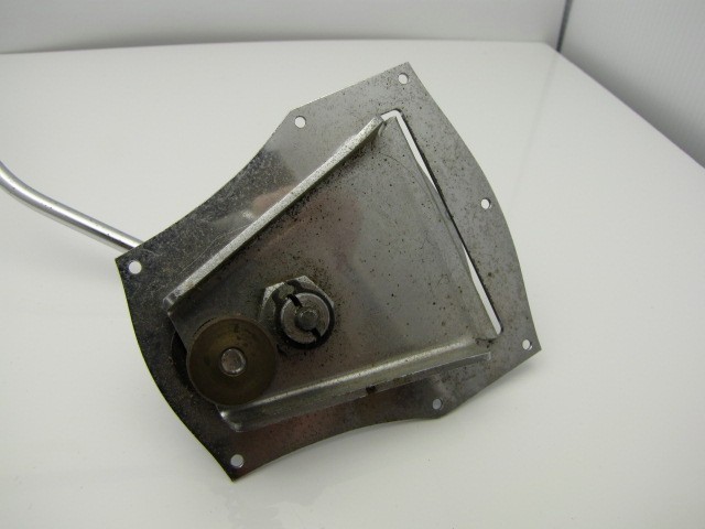

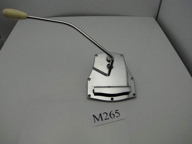

the tremolo has a small cavity to fit the spring which extends below the surface, similar to this Klira trem that's on eBay but with narrower internals:
the difference is that the trem arm collet and the spring are side by side on the Hopf trem, and one behind the other on the Klira.

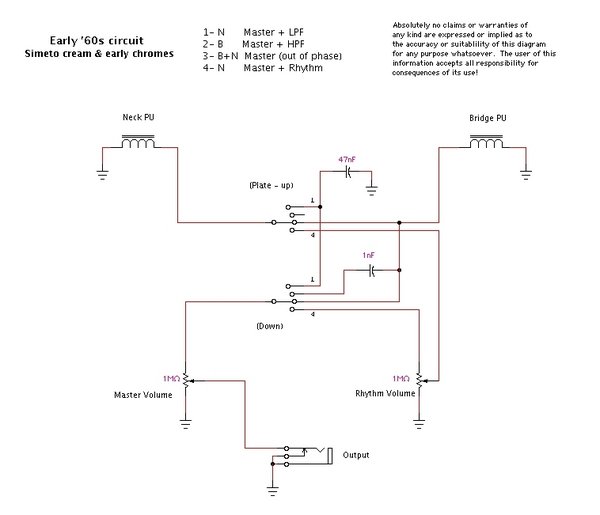

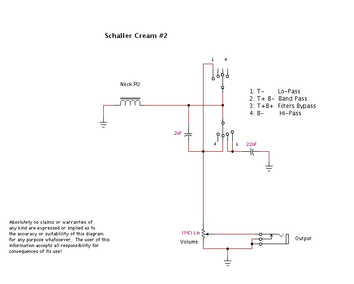

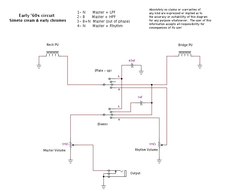

there's progress to report. the guy who failed to send me the Kent body got in touch, apologizing for his fail and offering to send me the body for free if i'll then revise my brutal negative feedback (which included the phrase "AVOID LIKE THE PLAGUE"). so IF it works out i'll finally have the necessary parts to put the Kendo (Kent body + Hondo neck) together. better yet, i found a schematic for the Schaller 4-position tone switch which is a constant on many German guitars including Framus and Hopf (Hoppy has a fully functioning example), and another for the Simeto circuit from the DDR Musimas. this is a Framus schematic:
and this is the Simeto diagram:
so i can wire the Musima properly and add a tone switch to the Kendo.
i'm gonna need some help to get things wired properly.

the Schaller circuit has a bass cut labelled treble boost (T+) that makes the fairly fat Schaller PUs thin and slashing like a Jaguar, a bypass labelled as bass and treble boost (T+B+), and two deep and muffled treble cuts, one of which (T+B-) is less extreme than the other (T-). as you might expect, T = treble and B = bass. the Simeto circuit is more mysterious and includes a out-of-phase setting.
