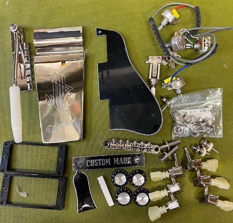

- Posts: 14854
i unpacked the 335 parts and i'm pleased. the vibrola is made much better than the one that came with the SG, cleaner contours and better plating as well. the rest of the stuff, which i could think of as stuff i got with the vibrola i bought for 1/3 off, is also good. the harness has full-sized CTS pots, the bridge is well made though it has the larger Nashville posts, and the Kluson-style tuners seem good. makes sense because the Bonamassa guitars are high up the Epi pecking order. at least some of this stuff will get used in future projects.

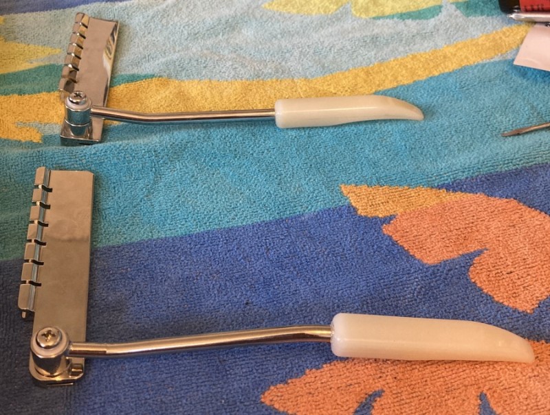

- Posts: 14854
the new vibrola is a serious upgrade from the original. as i hoped, the arm (foreground) is configured differently than on the original 2005 vibrola (back). it bends more steeply at the start, but flattens back out when you get close to the tip so the plastic tip tucks comfortably into the palm of my hand. it also starts out lower, and has only the handle's bushing while the old one had a smaller bushing with a spacer beneath. it also secures with a nut on the underside of the comb while the old one only had the bolt which screwed right into the comb. the fit and finish on the new comb is also much better.

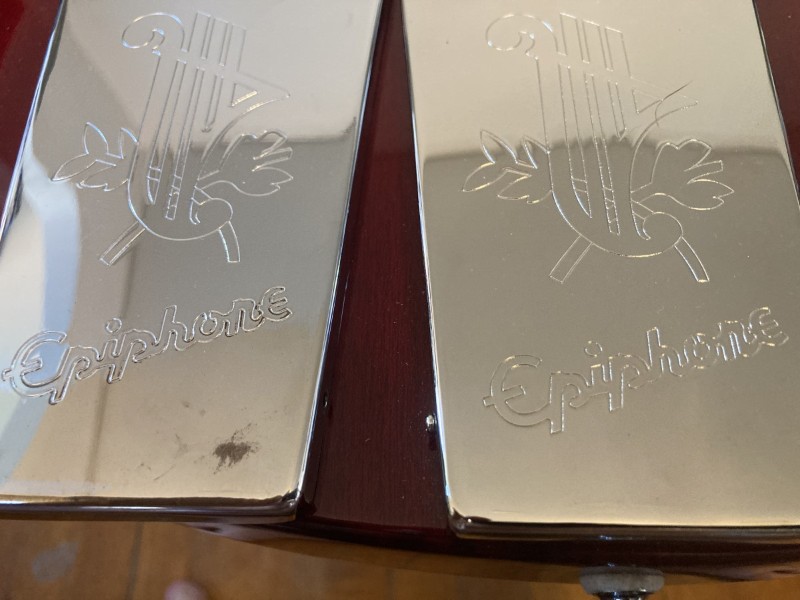

the scribed plate is also higher quality than the original. if you look closely at the engraving you can see that the old plate on the left is less precise, especially on the curves.

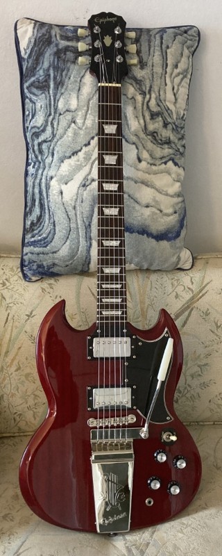

replacing the vibrola was a bit more fiddly than i anticipated, especially securing the scribed plate which is secured by 4 teeny weenie screws that fit equally tiny holes in the frame. if my small screwdriver wasn't magnetized i might still be at it now.
i'm really pleased with the result. the new vibrola is more responsive, and the handle fits my hand like i remember the ones did which i played in the 70s. it's striking, though, how much better the new parts are. i'm generally happy with my SG after the minimal mods i've done, but i suspect i'd like the new Inspired By Gibson Custom even more. this should be everything i need to do to the SG.
