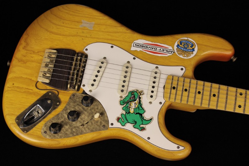

i'm also considering making the second Strat into a multi-pickguard affair. i'd start with the CS '69 Strat pickups this is predicated on, and adopt another of Jerry Garcia's innovations by making the controls a separate plate from the pickups so you can get at the wiring without having to unstring the guitar and take the whole bloody pickguard off. then i'd have the option of making other pickup guard modules that i could swap in and out using some kind of plug connectors. this would only work with 3-pickup arrangements, though. i could do gold foils, Firebird pickups, and perhaps the Simetos left over from the Musima (i'm sure i can get a third pickup cheap because the internet is chock-full of Warsaw Pact guitars either in parlous shape or parted out). i might also do one with three of the metal-cased open-top Guyatone pickups like the one in the bridge position of the Kondor. i wouldn't do a whole guitar just for that, but a loaded half-guard would be much cheaper and simpler. that would let the one Strat take the place of multiple guitars and save me a ton of money and hassle...i'd much rather set up one neck/bridge/tremolo than 3 or 4. i'd better get locking tuners to make swapping guards less problematic, though, which has worked really well on the Kondor. i first thought about this adaptation years ago, but was never really in a place where i could do it. it might be wise to inset screw sockets into the body and use machine screws for mounting the guards so the wood doesn't get chewed up.

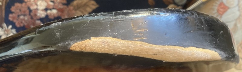

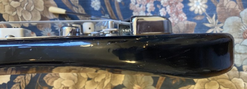

here's the more visibly damaged (though the less damaged in toto) of the two areas after several coats with the paint marker. it would be easier to get a good surface with a brush, because when you get enough lacquer on the tip to flow well the excess runs off down the face of the guitar. alcohol and paper towels on standby got used several times. this isn't perfect, but it's better. i'm pleased that the color-matching thing seems less problematic here, probably because i covered so much territory with the pen. i just did more lacquer this morning. once it dries i'll do the painting on the other side, let that dry, and then work out a final finishing strategy. i'm hoping that light sanding with 1200 followed by polishing compound will give me a decent surface...i did several passes to try and build up a sandable layer of paint because a single application of the pen is very thin. if i can just get a reasonably consistent flat surface i'll be happy.

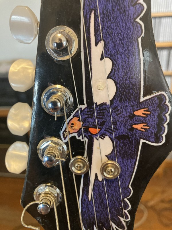

i more or less solved the problem of the hole in the Kondor logo from the misplaced string tree...i went through a J. Peterman catalog, which features watercolor illustrations of the products rather than photographs, found an illo with a clouded sky in the background that pretty much matched the pale blue color, and used clearcoat to stick it down. while i was at it i did a second coat on the sticker which made it nicer and brought out the colors a bit more. i'll do a third coat later on before i stop. you can see the fix close-up, but from three feet away it's invisible. i'm a bit hacked off that i had to do string trees. the staggered tuners would have worked on almost any other neck without aid, but the Hondo headstock actually tilts towards the bridge which i only noticed today. go figure. i guess they saved 4 yen on wood.

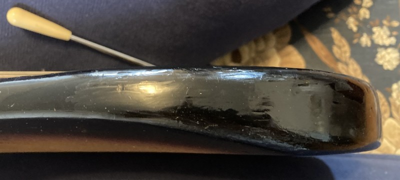

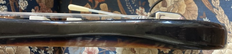

i worked on the Kondor body some more…the problem with the lacquer pen is that it doesn’t smooth down when it dries. it’s kind of like painting with blood in that it doesn’t want to stay together. sanding and polishing doesn’t smooth it because it’s a thin layer and you go through it before it’s flat. my first idea was to use the clear gloss lacquer pen to cover the work, but it melts the black pen and screws it up. so i tried the water-based clear poly and eureka! one side dried so nicely that i only had to polish out the points where it ended and the original finish began. for whatever reason the other side did not, but the poly stands up to sanding better than the lacquer. you can see places in the second photo where it got down to primer or whatever though the biggest light spots there are reflections from the living room lights...note that the large spots are in more or less the same place/relative position on both sides. i'll pick those off with the pen. i’m considering one more pass of poly on the problematic side, after which the big body fixes should be done. it’s not perfect—you can still feel grain texture on the parts that were splintered and filled—but the color is fairly consistent and i managed to retain a good radius on the edges that got redone. i'm really proud of the contours. lots and lots of sanding there before finishing.

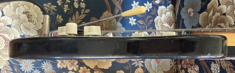

did one more coat of poly clear on the side of the body i had to sand, and i think this should do it. the great thing about water-based poly is that it acts like water, i.e. if flows rather than streaks. it’s going onto my list of guitar hackery essentials.

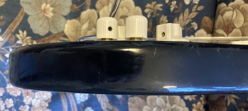

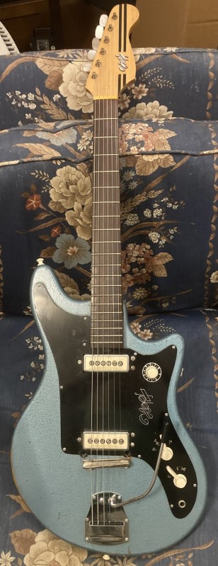

the Kondor is just about done. since i needed to take the pickguard off to remove the tone control, i also pulled the tremolo and went over the body with polishing compound. unfortunately taking out the tone control only helped the varitone slightly if at all; the first 2 positions aren't too rolled off compared to the bypass, but the others are way too quiet to be useable. i guess i'll get a Tonestyler when i've gotten through some of the other project spending. i don’t understand why the Pentatone doesn’t work. maybe it’s that the pickups are really low-output, down around 2.5-3.5 kOhms.

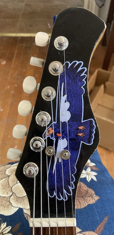

i cleaned up the nut a bit and did some black lacquer pen near it to make that part of the headstock less sloppy, and then went over that with the poly clearcoat. while i was about it i also did a fourth coat on the sticker, which is now pretty shiny. i'd probably have to sand it off now. i had everything buttoned up when the volume knob started cutting out, so off everything came again. there was a bit of wire coming off one of the terminals that was shorting the pot to ground, fixed easily enough. other than that the soldering really wasn't bad, just cutting the wires that connected the tone knob and splicing them together. everything's back together now except that the strings are still out of the tuners because i'm not going to tune it up until the clearcoat dries and i can't screw it up. i did some preliminary neck relief and bridge height adjustments earlier and will dial those in later. filed a couple of the bridge slots that weren't making good contact and they're fine now. once it's restrung and set up i'm genuinely going to be done except for maybe replacing the varitone with a Tonestyler somewhere down the line. photos once everything's set up.
