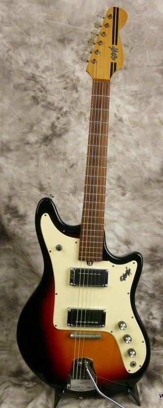

way off on a back corner of my mind is a second Hopf Twisty husk off eBay, complete except for the pickups, volume pot, and bridge. its pickguard is routed for large pickups; i've seen Twistys online with similar pickups. they appear to be PAF-sized with a kind of notched blade for a polepiece that has lower areas between the strings. i've seen exactly one of those pickups for sale used in the last 20 years.

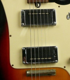

assuming that it needs less help that my current Twisty, what in the heck would i do with it? the Hofner pickups are going in the Galaxiemaster, i'm not sure i like the Simeto single-coils from the Musima project enough to devote a guitar to them, and i already have multiple P-90 guitars so the Epi ones in the parts box would be irrelevant. i don't really know that i need another guitar in this format; if i was to do something with it it'd probably be in altered tunings because the 20-fret fingerboard is a real hindrance when you want to play higher than the guitar wants you to. i don't know how suitable it would be for any of the pickups i still want/need. maybe gold foils. the repro Davoli Wandre pickups Goldo sells to Eastwood for their Wandre Soloist are fantastic, but i have my eye on an Eastwood one which you never see used (because i guess either people love 'em or nobody buys them) so that'd be coals to Newcastle. this Twisty has been online for ages, so i feel no compunction to act on it.
(this is not the eBay guitar)
Hopf hums.jpg (21.46 KiB) Viewed 6526 times

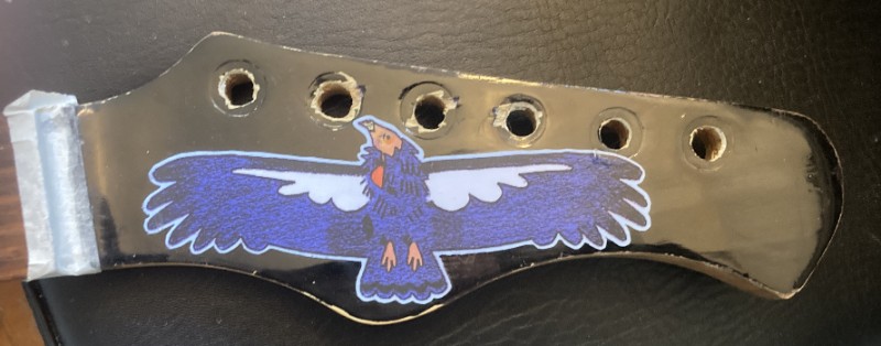

so this is now down to adjusting string height etc. so i'm moving on to the Kondor. i already resolved the non-seating pickguard thing so it's all cosmetics from here. first thing will be to use the black lacquer marker on the edges of the headstock face where it's been scraped so there's a consistent edge. then i'll figure out which of the variety of nylon and foam paintbrushes will work best with the consistency of the clearcoat. one coat, then 24 hours hibernating with a cardboard box over the headstock to keep dust off. when that dries i'll consider if it needs a second coat. i don't particularly want to get into polishing it afterwards for fear of wrecking the sticker, but we'll see. starting on that either today or tomorrow. then i'll sand the damaged areas on the edges of the body and lacquer marker over them. a test without sanding turned out well enough that i want to do it right. that's really all there is to do with this guitar. whoopee.
Posts: 14854

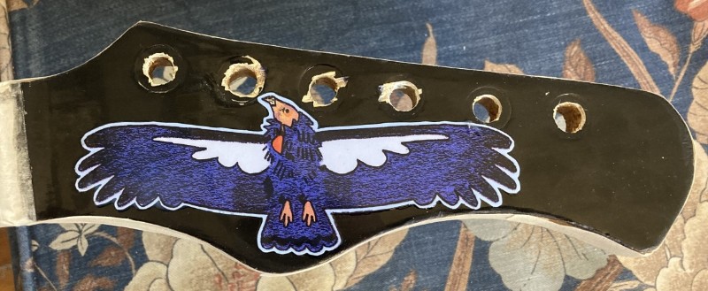

had a go at the ragged edges of the peghead. it looks a bit blotchy in spots, but should settle out when it dries with perhaps a dab of polishing compound.
i'm not doing the areas around the tuner holes because they'll be covered by the washers. and as ever i'm not going for perfection, just trying to make it look nicer.

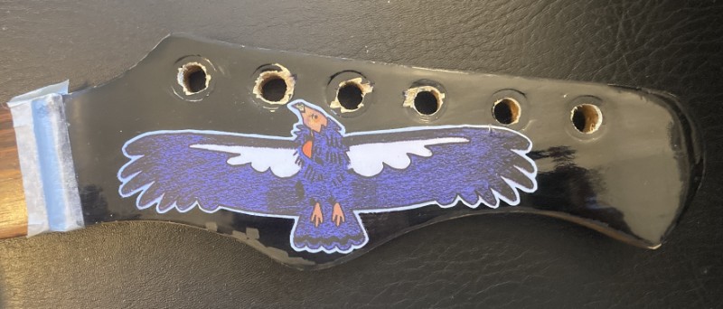

i decided the best course would be to coat only the sticker rather than doing the entire face, which is in decent enough shape. water-based poly is nice to work with because everything rinses off in the kitchen sink. i went slightly beyond the edge of the sticker hoping that'll help keep the edges from peeling up.
the instructions say to let it dry for 2 to 3 hours. in my world that means "come back tomorrow." the guitar is currently laying on the coffee table with a cardboard box over the headstock to keep dust off while it dries. when i get home from Becky's tomorrow i'll see if i think this is sufficient. i basically just want to be able to clean the headstock without fucking up the sticker. i like that the clearcoat has darkened and deepened the image a bit, which makes it stand out more.
the edge of the headstock has been taped so it's ready for a full coat on the face if i decide that's needed. i won't do any more painting than i'm forced to do.

for the record, this is the Hopf Twisty husk that’s been sitting on eBay forever. lead me not into etc. etc.

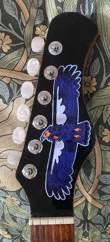

i think the sticker is good to go with one coat of poly, so i reglued the nut and put the tuners back in. i’m going to let it sit for a minute and decide whether to forge ahead with the body fixes.

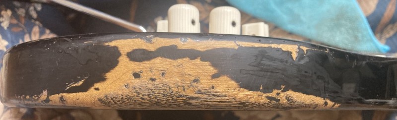

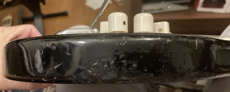

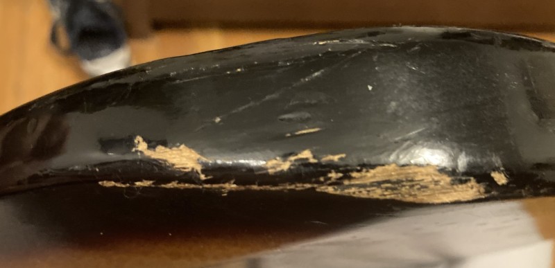

the Kondor is coming along. the areas i'm working on were crunched/splintered, assumedly from being dropped onto a concrete floor from standing height. the first shot shows damage that's untouched; the second shows the side that i tried to treat with the lacquer marker alone. you can see that the surface remained pitted, and the area that had been crushed showed obvious rough grain.
i was kind of unsure how to proceed until i remembered the rosewood grain filler i ordered for the Höfner neck. it turns out to do quite nicely at filling the grain and some of the worst dents. it's quite solid when left to dry overnight. in this shot you can see the areas along the edge at the bottom of the shot where the filler, which is slightly darker than the mahogany, is worked in between the grain that still retained paint after being crushed.
this is after sanding with 400, then 800. it's much smoother now than it was after the previous pass. i'll take it down to 2000 grit to polish the remaining paint to a good level. i'm really encouraged by how well it's working. i didn't really mean to sand such a large area, but once i got going my Smoothness Detector was on high alert and the hypomania kicked in.

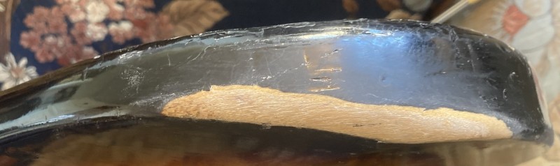

here you can see the difference after filling the splintered area on the top (right side) edge of the body. in the repaired shot the filler shows up as pale against the speckled, slightly reddish mahogany. i didn't sand this area at all before applying the filler. the collateral damage to the paint will be taken care of. i'm very happy with how this is working out. the finish repairs won't be done for another couple of days unless i get a bug up my butt about Being Done.
