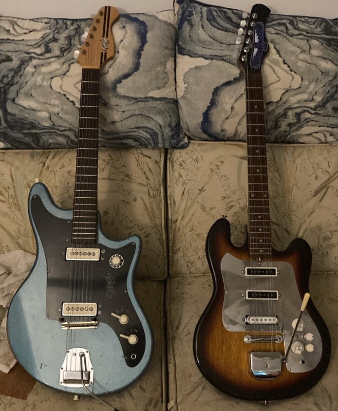

here's the Twisty with the Kondor, my other successful from-parts invention. hopefully the Hopf pickups sound as good as the Kent/Guyatone PUs in the Kondor, which really surprised me. the Kondor is waiting to be worked on...the strings are slack and the nut is off to facilitate clearcoating the headstock, which will also require taking out the tuners. that's simple here because the Fender/Ping locking tuners come off just by undoing the threaded bushing. i don't think the Kondor stuff will take too long because i've already been over it in the last year. there's really nothing technical to do, just finish stuff and figuring out why the pickguard won't sit all the way down in the control rout. i assume something needs a bit more lebensraum, but am hoping i don''t have to get into Dremeling the cavity even though last round was easy. i might wait on doing the Kondor headstock because i think it needs a full moon sticker on the upper part of the headstock. now, whether i can find one small enough to fit is another question. so far the smallest i've found are 1.4-1.5", which might be a wee bit too large. i need to measure the headstock when i get home.

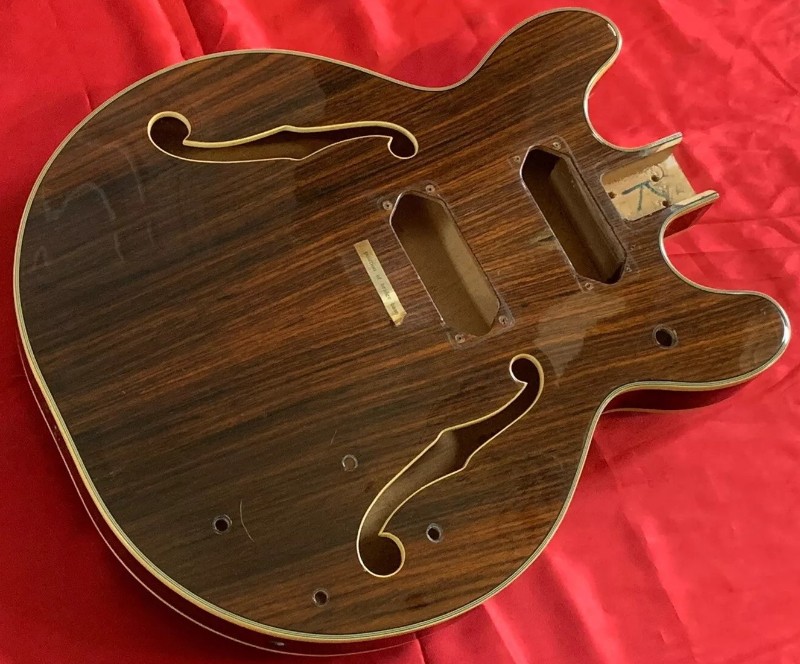

i'm being haunted by a body i saw on eBay, a bolt-neck hollowbody double-cut in rosewood veneer over heck knows what. i don't have money for it right now, but if i do that's going into the projects queue. god only knows how i'll find a neck that fits the pocket. the sticker says "position of bridge base" so i suppose you could figure out the scale by figuring out how far it is from the bridge to the butt of the neck which presumably would have 21 frets, or to the center line of the neck pickup rout which should be at the putative 24th fret. it appears to be entirely hollow other than a block/sound post under the bridge position. you don't see shit like this every day. in fact, i've never seen a 335-depth rosewood body. i already have wooden bridge bases in my parts box.

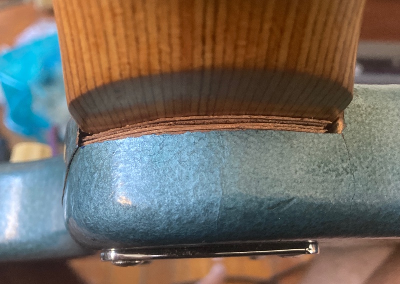

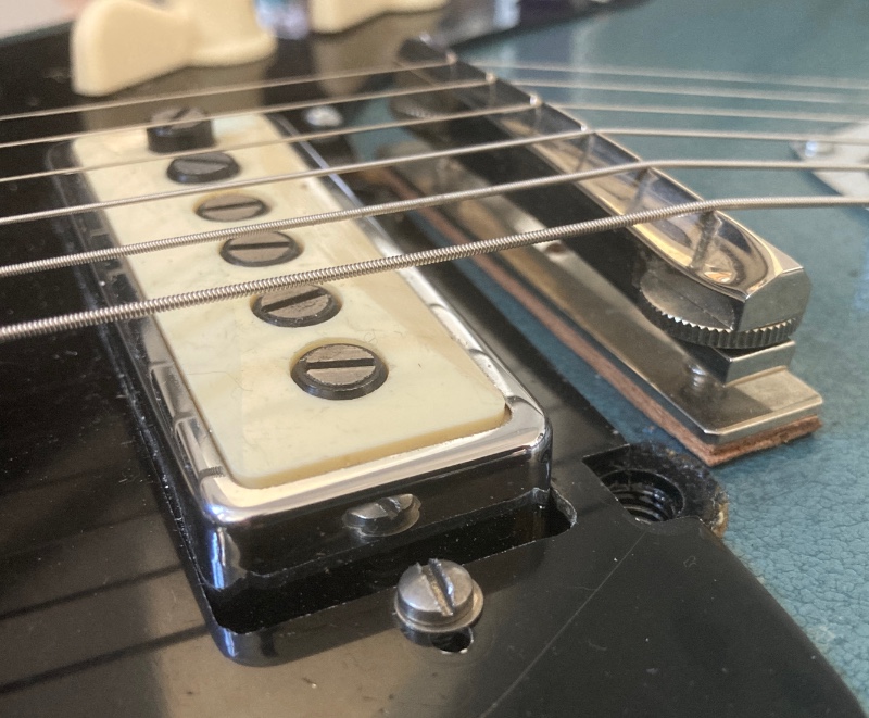

i thought you might like to see a bit more detail, so here’s photos of the shimmed areas.
that’s 4 shims in the neck pocket and 4 shims under the bridge. i don’t love the lumberyard look, but it was necessary.

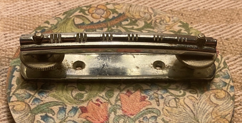

- Kacey Y
- Posts: 2321
- Location: Pittsburgh, PA
Question for you, Dub. Did that flat bridge plate with the posts attached come with the guitar or did you buy it? I was looking for that exact part and nobody who ever had a listing for one still had them, and the only company that still made it new was on indefinite hiatus when I checked
- dubkitty
- Posts: 14795
i bought the bridge separately, but it’s the OEM bridge. there’s one on eBay now for $145. the seller has a ton of interesting items.

Thanks. I found the bridge plate by searching for teisco parts, initially. I'm also a deep practitioner of Google-fu. Lots of reverse image searches and scouring oem listings, looking for key words. I'm sure I annoyed some ebay sellers with my messages like "hey, there was this image on google from 5 years ago with this model# and description, do you still carry that?". There was a lot of vintage used parts that fit the bill on there and Reverb, but too expensive for my project budget (it rhymes with "shmalmost nothing"). I came up with some ideas to DIY it, since it'll eventually be kind of a ratrod guitar, but it's on hold for a bit anyway
- dubkitty
- Posts: 14795
i try not to spend too much on parts, but i wanted the Hopf to be as close to original as i could get.
i have an old Teisco bridge i’m probably never going to use that you can have if you like. the space between the posts is smaller than Tunomatic spacing (65 mm vs. 75 mm) so if you need standard spacing it won’t work.

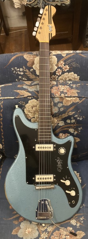

i’ve had a week with the finished Hopf, and i’m pretty happy. i raised the pickups today because the output was low compared to a control guitar (my Tokai Les Paul Special with P-90s). it’s still a bit low compared to my typical levels, probably similar to the Kondor that way. i was afraid there were still wiring problems because i was getting random noises while playing or moving it, but it turned out it was just a bad cable. thank goodness…i really wasn’t ready to take it apart again.
it turns out to have a pretty short scale at 24.5” so i might go up to .011s…that doesn’t bother me on Gibson-scale guitars (24.75”) but this guitar is a little bit boingy with .010s.
i oiled the heck out of the tuners, and they’re tons better, about as quiet as you could ask for from 50-year-old open-back tuners. there’s a little play in them, but it’s copeable.
i’m starting to feel like i’m done. i can’t really think of anything else i could do to improve it other than put a piece of plastic or tape between the tremolo collet and the base plate to eliminate the clicking when i pull up on the bar because there’s a bit of free space between them i can’t adjust away. i’ll do that when i change strings.
