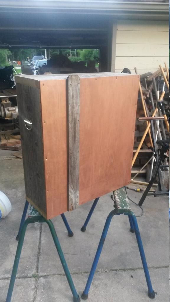

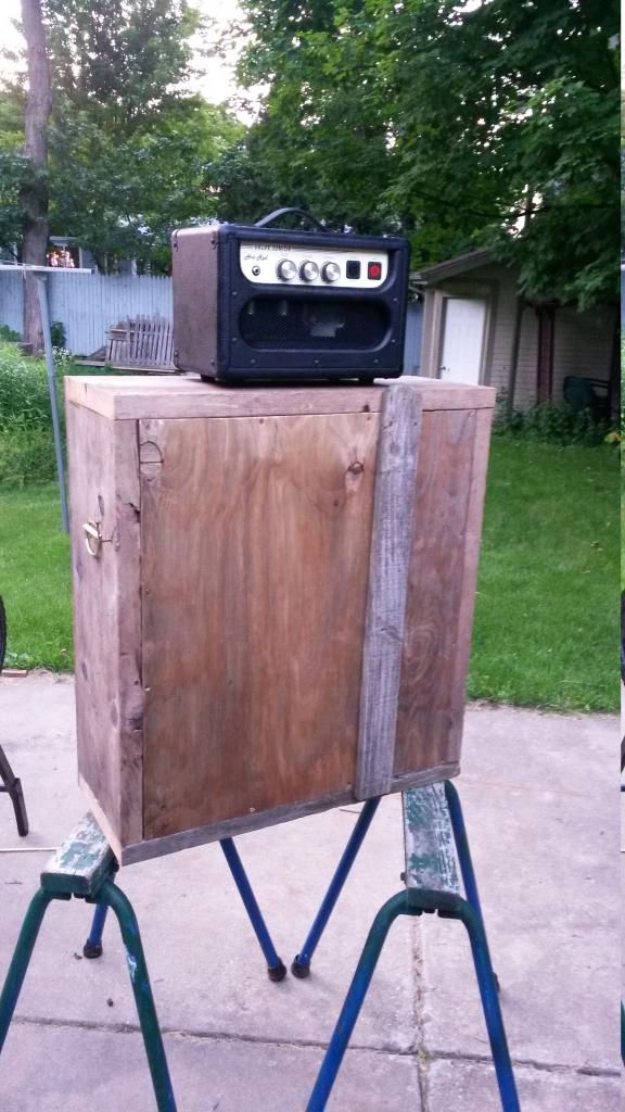

Did some work on the repurposed wood cab over the weekend...got it almost done. Just need to cut a hole for the speaker and find a grill.

Here's a question. With my limited woodworking tools and skills some of the gaps aren't perfect and will more than likely have air escape them. Is that something I should be worried about if I'm trying to make it a sealed cab? Should/can I caulk the seams on the inside to seal it better?

throw some epoxy in the seams. Do it from the inside and you'll keep the aesthetic you have going on with it.

epoxy or caulk is the way to go. And like AxAxSxS said... on the interior to seal it. if you plan on sanding everything on the exterior fill it with a wood putty and then you can sand off the excess with the rest of the box you are sanding. and as standing it looks like a mean bastard.

Yeah no way I doing anything to the outside, it looking exactly how I wanted it too. Im already am pretty happy with the results especially for the amount of effort I've put into it. It looks like it was made in a backyard by a high person...and that what it is.
I feel with some better tools, a bit more precious measurements, and a lot more wood I could do this on a bigger scale that would be constructed road worthy. My next plan is a 218 the size of standard 612, I want to keep it in the same weathered unstained repurposed wood style.

Well this cab is just a single 15. And it'll be rear loaded. When I have the hole cut, grill in and speaker in it'll all make sense. I'd fail hard at explaining it.
