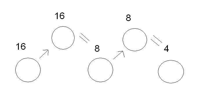

I'd put money on this is how its wired:AxAxSxS wrote:That was my take. The previous owner said it was one 16ohm, two 8ohm, but he also said that two 8 ohm cabs would go to the 8 ohm taps which seems contradictory. I'm sure its capable of having two 16 ohm cabs plugged into it. I'll message verellen. I'ts really a manner of how it was labeled.chillerthanmost wrote:I would think the opposite since no one would plug in two cabs to make a 16 ohm load. So I see it as one 16 ohm, then two 8 ohm so you can plug in two 16 ohm cabs, and two 4 ohms so you can plug I two 8 ohm cabs. Make sense? But, best contact Ben about that.

I'm with Astro and his fancy drawing.

This is my understandingAncient Astronaught wrote:I'd put money on this is how its wired:AxAxSxS wrote:That was my take. The previous owner said it was one 16ohm, two 8ohm, but he also said that two 8 ohm cabs would go to the 8 ohm taps which seems contradictory. I'm sure its capable of having two 16 ohm cabs plugged into it. I'll message verellen. I'ts really a manner of how it was labeled.chillerthanmost wrote:I would think the opposite since no one would plug in two cabs to make a 16 ohm load. So I see it as one 16 ohm, then two 8 ohm so you can plug in two 16 ohm cabs, and two 4 ohms so you can plug I two 8 ohm cabs. Make sense? But, best contact Ben about that.

I think your reading my picture wrong.chillerthanmost wrote:I still think it's two outs that make 4 ohms total, two outs that make 8 ohms total, and one out that makes 16 ohms.
Because the way skip is describing it means that you would never use the one labeled 4 ohms if you have two cabs that equal 4 ohms. Which is far more common than having two cabs that equal 16 ohms. So having two outs that equal 16 ohms makes no sense to me. But maybe I'm not thinking straight at the moment.
There is two outs that equal 4 ohms total, the two 8ohm outs. Look at my numbers not as the total load of that out but as the load of the speaker your plugging into it. The arrows designate a parallel out. So if you plug two 16 ohm cabs into the 16ohm taps it equals 8ohms (designated by the = sign in my pic) but you can still use the bottom row as single cab outs.

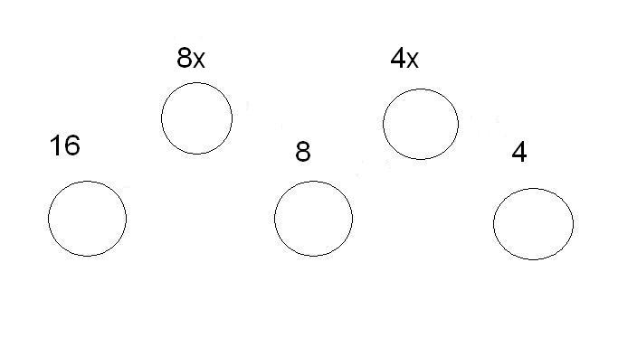

So this is how your saying it is:
This would provide no way to have a second 16ohm cab plugged in, which is an extremely common occurrence. And 4 + 4x in parallel would equal a 2ohm load, which is extremely uncommon in guitar amps (as 90$ of guitar cabs are 16 or 8ohm). If this was a bass amp I could see it having a 2ohm tap but I highly doubt it.
Now if your talking about 8x as a total load and plug 16ohm cabs in to the 16ohm and 8x, and 4x as a total load from plugging 8 ohm cabs into the 8 and 4x, then we are basically saying the same thing just from different view points. If your saying that you'd have to do 8 + 8x and 4 + 4x they would have to be serial connected jacks and would require that 2 cabs be plugged in at all times, which would render you unable to use the 8ohm or 4ohm out alone, and render the labeling of them as 8 and 4 ohm outputs a moot and useless point.

so basically

Ancient Astronaught wrote:I think your reading my picture wrong.chillerthanmost wrote:I still think it's two outs that make 4 ohms total, two outs that make 8 ohms total, and one out that makes 16 ohms.
I just talked with Ben about this yesterday.
My head has two 8ohm and two 4 ohm outs.
He said when running two 8ohm parallel, run them both off the 4 ohm outs, 16s parallel off the 8 ohm outs, he also said that at least the Meatsmoke has been tested with two 4ohm cabs into the 4ohm outs and the mistmatch is safe enough for his build specs.
