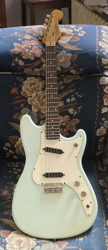

i did get the replacement pickguard for the Duo Sonic from Pickguardian and it's perfect. i sent in the old guard and a tracing with the pickups repositioned to 50s spec using a 50s reissue guard that didn't fit but had the pickups in the right places. it literally snapped into place between the neck heel and the bridge and lays perfectly flat. he made a 3-layer guard because i guess that's standard rather than the one-layer white that's vintage-correct (my fault for not specifying) but i rather like the added bit of visual definition the black layer provides. i had to go after the pickup cavities with the Dremel, but everything worked. the re-positioning of the pickups made it 400% better; the bridge has the kind of SNAP you expect from a Fender now, and the re-angled neck pickup seems both warmer and more articulate. i wish i'd gotten it together sooner...i always liked it, but now it's hard to put down, moreso because it's so tiny and weighs so little.

Duo Sonic is looking great!
Very cool
- dubkitty
- Posts: 14854
it’s always been very comfortable to play with the 22.5”
scale, small body, and impossibly light weight, but now it sounds as good as it feels.

Nice, the Duo Sonic looks good. The adjustment to pickup placement making it more enjoyable to use is a big deal
- dubkitty
- Posts: 14854

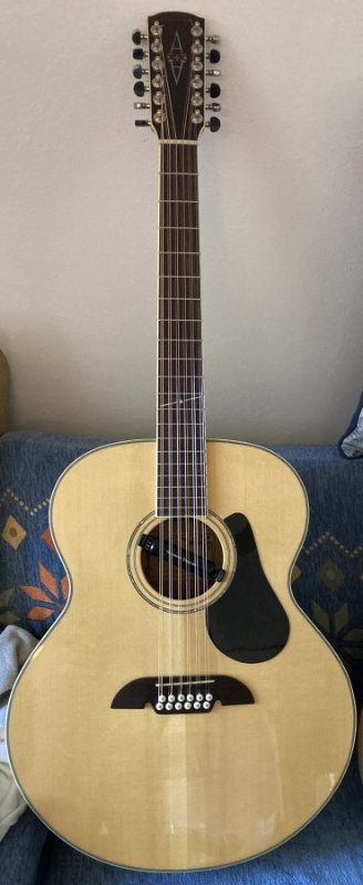

huge deal. it's gone from a curiosity to a tool. i love it when the result of all my futzing about is an actual improvement in the functionality. i'm chuffed today about the 12-string which i used for a long looping session yesterday with the full system where i got all kinds of lovely stuff that doesn't even necessarily sound like a 12er at all. the doubled courses in particular do wonderful atmospheric keyboardy things through the modulation and multiple reverb units. did i mention that i rotated the pickup to a diagonal orientation because it was very bass-heavy/treble-deficient? it helped a lot. now i understand why people started angling pickups. the only drawback is that the pickup really needs a preamp to get to unity gain with a typical electric guitar. i have the Mellowtone "party favor" Hi 5 as a clean boost at the start of the FEB and use it to knock the output level up enough that it'll kick open the gate on the Micro Tron. this also helps out the Duo Sonic and is generally handy for matching levels, bringing up quiet stuff like glissando guitar and bass tones through the Octave Multiplexer that needs a kick. the 12-string is one of my best success stories in Mod World. gained a ton of functionality, i like the sound better than a typical electric 12 because it benefits from the jumbo body and is less shrill, it works better, looks better, and the whole schmeer was way cheaper than buying an electric 12. and let's not understate how great it is to tune it with an electronic tuner. i've been kind of depressed lately, so it's nice to look at it and say "that worked."
