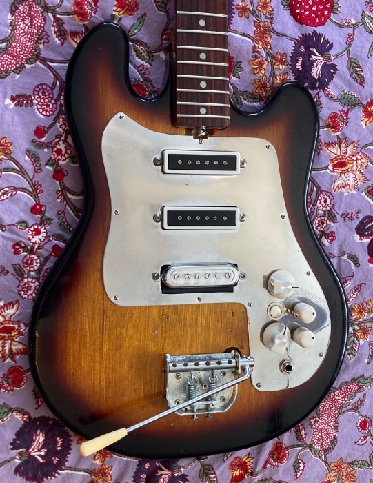

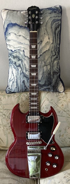

so that means no more major project stuff till i get back from vacation next week. i'm doing minor touch-up stuff as it comes up. i needed to change the strings on the Epiphone SG and decided to swap bridges...it originally had an ABR-1 which didn't play well with the stock Vibrola without the domed bridge adjustment thumbwheels which were a vintage feature (and happily are now being made by a bloke down in Texas) so i switched it out for a Nashville TOM which also gave me a bit more room for intonation. it always looked clunky, though, like it didn't belong with the rest of the hardware. The Jetstar came with a vintage-style ABR-1. so i swapped the two bridges since i'm planning on doing the GFS/Hagstrom bridge on the Guild. it just looks right with the smaller bridge, and since it's over 15 years old it's settled down enough that it intonates on the narrower bridge just fine. naturally i did a full cleaning on the SG, lemon oil and all, and reset the action and intonation as one does when changing strings. it looks like a happy SG now. those wee visual details, the bridge and the lettering i removed from the truss rod cover, make a ton of difference in subtle ways. and the bridge and thumbwheels make the Vibrola a pleasure to use, and how often does someone say that about a Vibrola?
SG 6-26-24.jpg (69.01 KiB) Viewed 4713 times

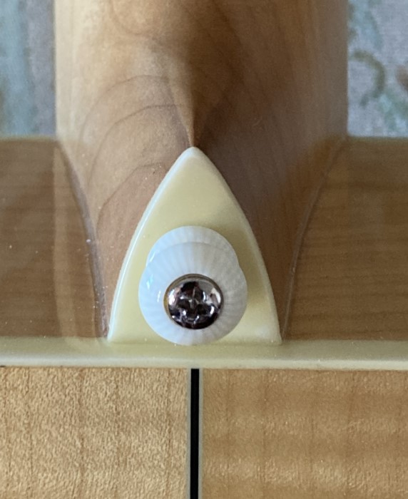

i added an ivoroid strap button from StewMac to the 12-string so i can use it standing up. i had to cut out the hole at one end of the strap so it would fit over the endpin jack button, whose center diameter is about 2.5 times that of a normal button. it works perfectly as far as i can tell...it's a bit amusing to stand there with a jumbo acoustic tucked under your arm, especially when you're 5'8". it came with a startlingly long screw, assumedly because it's intended to screw into the end block, so i had to drill about an inch into the heel. i started out with a wee drill bit and worked my way up in sequence till i got to 1/8" which was the proper size for the screw. i wrap masking tape around the bits at the depth i want to stop at so i can't overdrill. i don't think i'll ever have to be concerned about it falling out. it includes a quite clever brass bushing that goes between the screw head and the button so you can't easily over-tighten the screw and crack the button. this should conclude work on the Alvarez with the exception of possibly polishing out the pickguard.
alvy peg.jpg (73.7 KiB) Viewed 4668 times

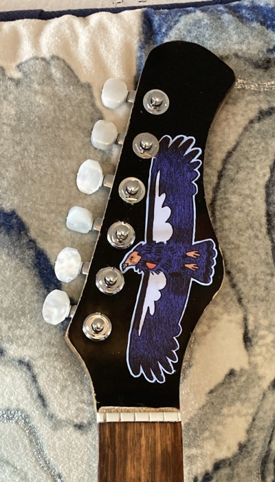

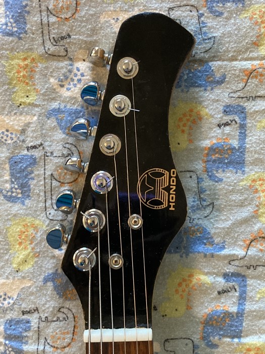

i also got the Kondor's headstock fairly well sorted. i stopped off at an auto parts store the other day and got some finishing products i've used in the past for DIY guitar stuff. i went over the face of the headstock with liquid polishing compound. i'd forgotten how much compound, force, and time are required for a result, but in a reasonable amount of time it was looking almost frighteningly glossy. i found a California condor sticker on Etsy that barely fits on the headstock, but i rather like the bold effect.
kondor headstock.jpg (93.45 KiB) Viewed 4668 times
compare to February. the new tuner buttons are from Hipshot, and i was very happy to find a pearloid option for mini tuners that wasn't a Fender, Grover, or Schaller clone.
kondor head.jpg (142.56 KiB) Viewed 4668 times

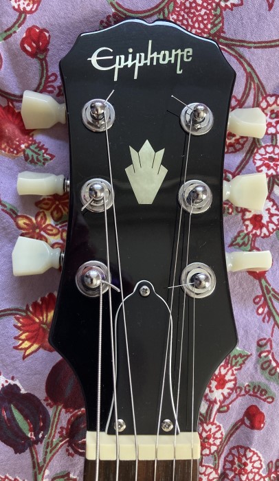

one tiny thing that's coming up will be installing pearloid Hipshot keystone tuner buttons on the SG's Grover tuners. i think they'll look more metaphysically right than the kidney-bean Grover buttons, and will be the last vintagizing thing i can do to its appearance short of throwing it down the stairs. i used the polishing compound on the truss rod cover which improved it a lot.

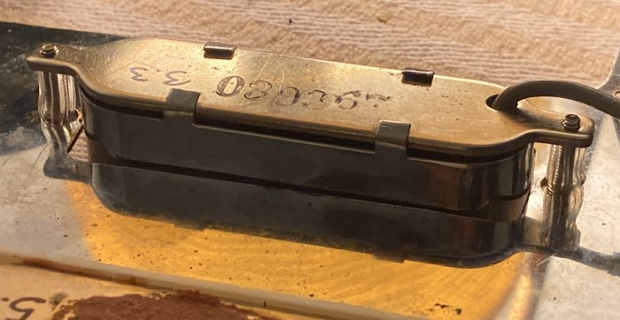

i also found a second Guyatone single-coil like the one in the Kondor's bridge position for surprisingly cheap. this opens up the idea of a guitar with two or three of those pickups, though i want to keep the first one in the Kondor. it seems like the COVID gear price bubble is starting to pop...i'm seeing parts much cheaper than a year ago, and just got a used Princeton Reverb reissue off Marketplace for $750, i.e. 3/4 of the going rate on ReverbBay.

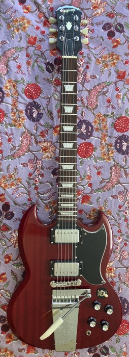

project momentum is picking up. starting with the small stuff, the Hipshot keystone tuner buttons for the SG arrived. they don't quite exactly match the vibrola knob, but close enough that i don't care. had to leave out the teflon spacer washer so the buttons didn't stick out too far from the headstock. i find it striking how much more balanced the design is with the original style of buttons and the other small changes. i'm really not trying to fool anyone into thinking it's anything it's not...my changes are on a subtler level, trying to making it look right. that "SG" on the truss rod cover in particular always bugged me. i don't see anything left to do here, except maybe put in a US pickup selector switch because the import ones suck. people diss the Epiphone humbuckers, but they're fine if you adjust them carefully.
SG 7-8-24.jpg (89.82 KiB) Viewed 4463 times
SG headstock 7-8-24.jpg (99.91 KiB) Viewed 4463 times

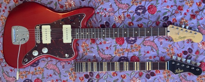

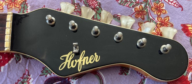

that Sunday project was working on the Höfner Galaxie neck that's been on the Hopf Twisty body; since i got the correct Twisty neck the Galaxie neck is looking for a home. it's the same scale as Fender bodies, so i ordered a Fiesta Red Jazzmaster body from GFS. i'll need to modify the neck pocket because the Galaxie neck has a squared-off heel like a Telecaster and is one fret longer than a JM neck. i spent a fair while polishing the headstock. i started with polishing compound, but had to go back and sand out some scratches with 1200->2000->wet sand w/2000 and then polish, polish, polish until it looked good. to do this i had to take off the tuners, so i disassembled them, cleaned them, and shot some dry lube on the works before reassembling them. i had hoped to be able to get the worm gears out because a couple of the key posts are slightly bent, but they're brazed into place so i'll live with it. if it really bothered me new replacements in that style are available. i found a laser-cut metal foil Höfner logo on eBay to replace the missing one. it was tricky to position because i couldn't find an exact example of another one with the string tree in this position. it's a bit too close to the edge, but it'll do.
Hofner neck 7-8-24.jpg (46.83 KiB) Viewed 4463 times
the M-75T wants to be this shiny.
Hofner headstock 7-8-24.jpg (66.29 KiB) Viewed 4463 times
note difference in fingerboard length.
Hofner and JM necks 7-8-24.jpg (94.3 KiB) Viewed 4463 times

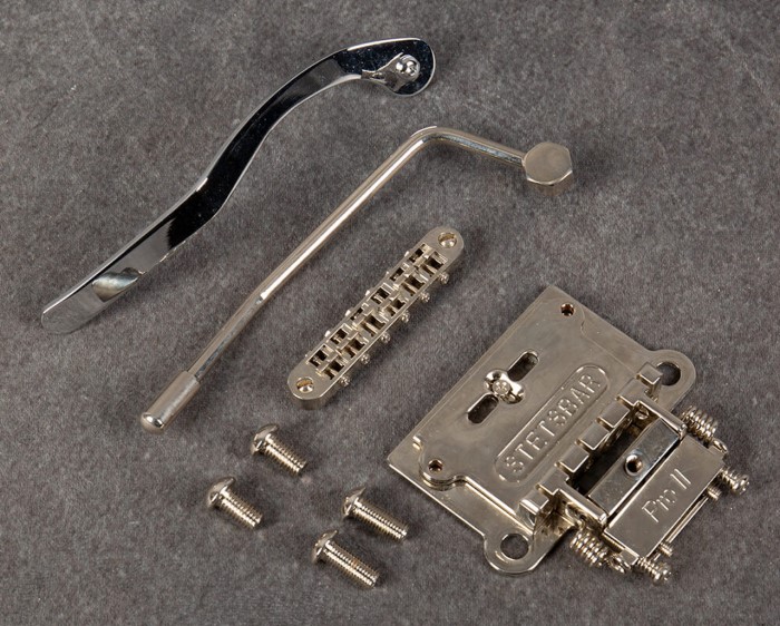

but i thought you were going to use the Hagstrom tremolo on the Jetstar? yeah, but i found something even better. allow me to introduce the Stetsbar tremolo bridge/tailpiece...it's a surface-mount that uses standard Gibson-spaced stop tailpiece mounts and is based on a plate that pivots with the tunomatic-style bridge attached to it. apparently you can dive-bomb with it and everything, which isn't really part of my aesthetic but adds another possibility. a nice bonus is that i won't have to do anything to the Jetstar other than pull the bridge studs and screw it on, which i like because it's already going to be more work than any of the other projects. and it has a cool chrome industrial look.
Stetsbar tremolo demo video

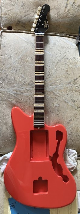

the body's here. i got it out of the box and laid it out on the sofa with the neck.
GM neck and body.jpg (57.95 KiB) Viewed 4186 times

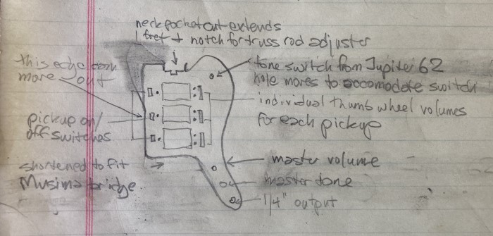

as noted i'll have to essentially bung out the back of the neck pocket to make room for the extra fret, though arguably i could just square out the corners and leave it because there's nothing drilled for the bridge so i could have it be 1/2" closer to the neck. i'll think about that. the pocket will have to be shimmed on the sides because the heel is narrower than Fender spec. i'll have the pickguard cut to cover the shims which i'll trim down to the height of the top.
the color is odd...it's more orange-pink than any Fiesta Red i've ever seen. i don't love it, but i can live with it. i reminds me of the dish i learned from my first wife, mashing up and melting cream cheese in tomato soup and blending it. it's particularly curdled-looking in the dim sunlight from the overcast skies and looks several shades lighter than the photo. i'll definitely have to sand and buff it out...the paint job is decent but a bit orange-peely. i might skip the final fine polishing though...i'm not sure this shade needs to be brighter.
the Hagstrom tremolo is way too small to cover the tremolo rout, so it's back to the drawing board there. i'd like to find something more interesting than a bog-standard JM trem, but that form factor seems to be what will work. i could get a 60s Schaller trem like the one on the Twisty, but i'd prefer not to spend $200 if i can help it.
so now i have to establish how much space there is for pickups and electronics, and figure out how i'm going to lay out the controls. i'm glad i chose a JM body rather than a Strat which was the other option. i think it goes with the Galaxie DNA better.
in other news, i spotted one of the metal-cased Guyatone pickups like the bridge unit in the Kondor that has a heftier 5kOhm output that the two i have (including the one in use) at 3.3 and 2.98 respectively, so i may swap that into the Kondor and then have a pair that's relatively matched which i reckon i'd put in a Duo Sonic.

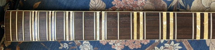

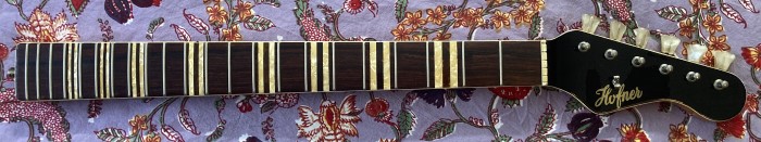

speaking of sanding, i decided to try evening out the fingerboard inlays on the Höfner neck, which are made up of pearloid binding strips on either side of a tortoiseshell binding strip. since the celluloid shrank at different rates, this made some of the strips thicker resulting in an uneven, horizontally-ridged (i.e. parallel to the frets) surface. first i tried using a small file to reduce the worst offenders at the high end of the neck which were tortoise strips, but i wound up doing the whole inlay areas because i noticed that as i took off surface area the pearl became less yellowed to the point that one strip particularly stood out. and since i wanted it to look balanced, that meant going in and totally flattening all the inlay areas with files and sandpaper. it loses some of the antique effect, but i think it looks better. it's also a much better surface to bend a string on because there were surface irregularities in the strips which are now smoothed. now i'll have to fix the wood parts of the board, too, or they'll be too rough compared to the inlays. dammit. here's how the highest four look compared to the un-sanded ones to the left.
hofner markers half sanded.JPG (45.45 KiB) Viewed 3883 times

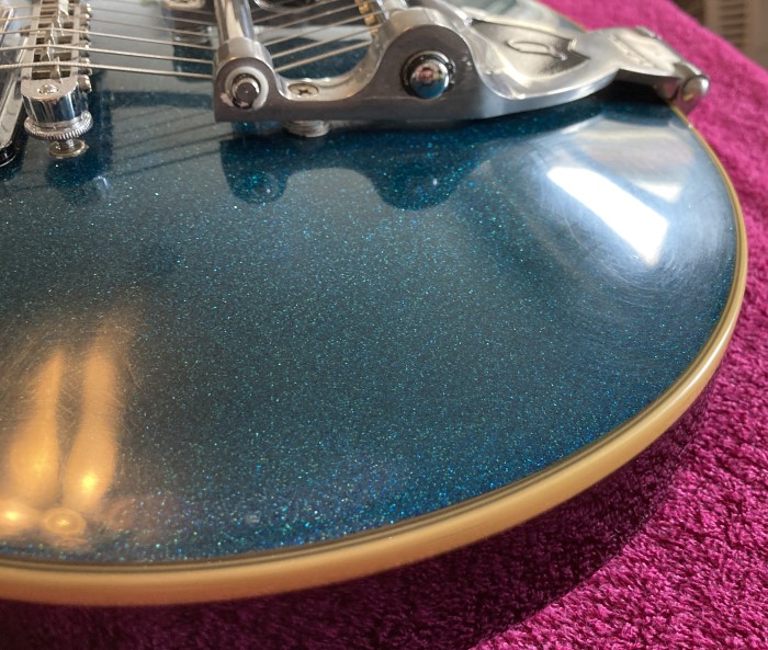

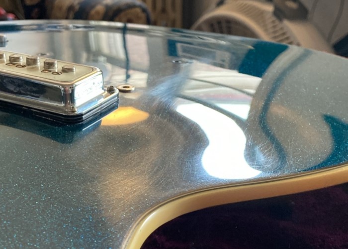

here's a couple of examples of the improvement in the M-75T's top after polishing. compare the reflective area in the middle to the heavily swirled areas around it.
dearmond blues 1.jpg (136.19 KiB) Viewed 3883 times
dearmond blues 2.jpg (83.8 KiB) Viewed 3883 times

the Jetstar is coming along. i'll take pictures presently. i'm still figuring out how to get the Stetsbar tremolo to the range and resistance i want, but it's generally useable now even though the neck repair needs sanded down and painted. i had to sand the fingerboard at the 3d fret and the adjacent areas because it was scratched up from the accident where the neck was broken, but after the requisite lemon oil treatment it looks fine. in another example of my negativity proving excessive the stock Fender-style tuners are fine, not the best but not bad so i'll leave them. i have plenty of things to spend and work on that will make bigger differences on other guitars.
