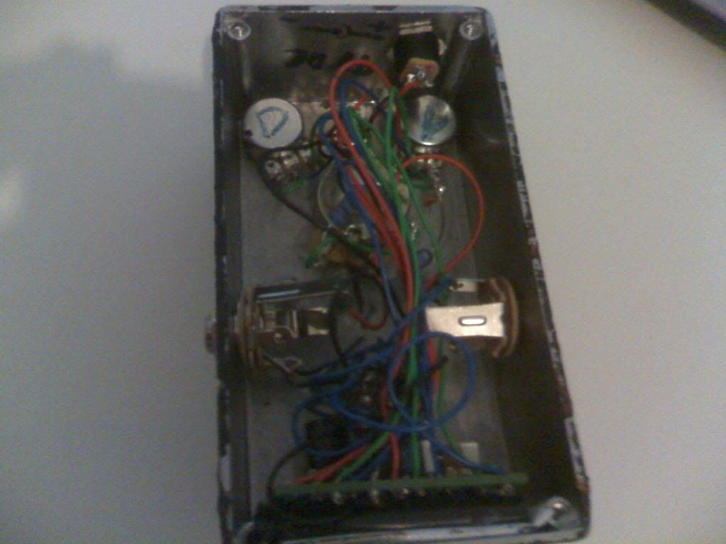

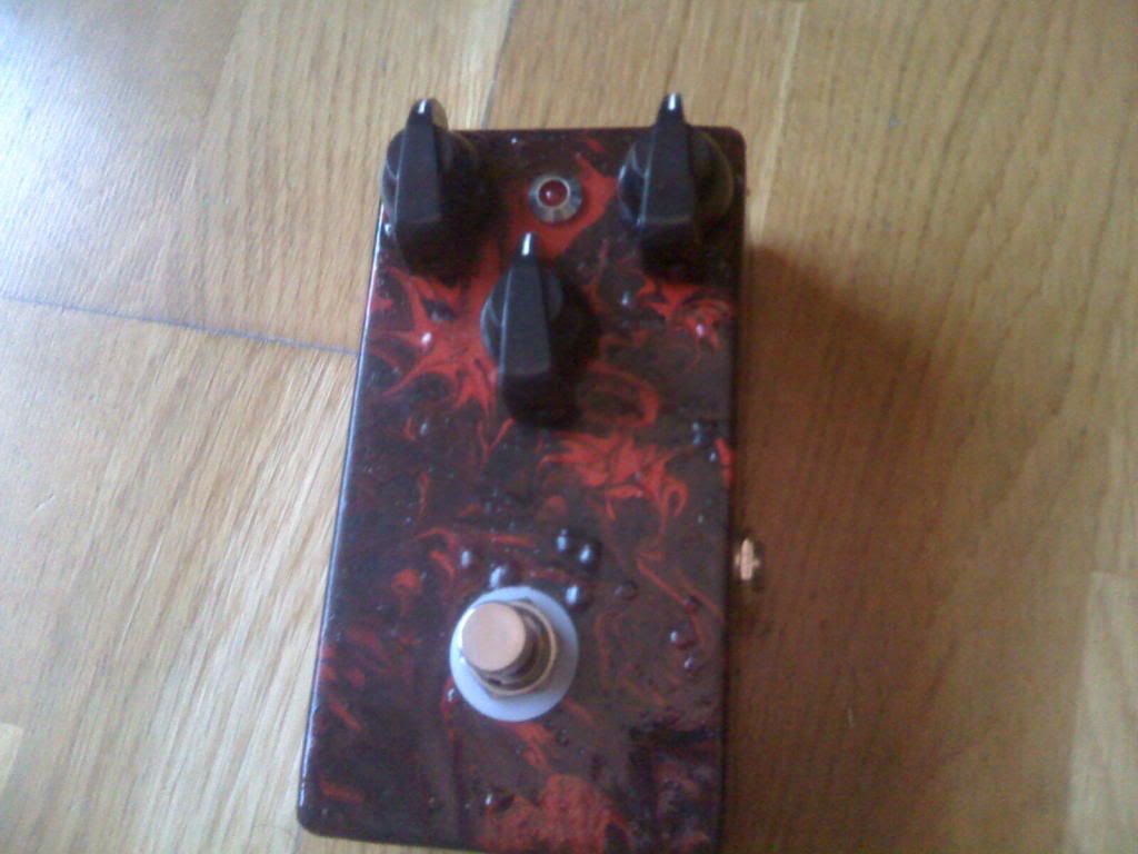

I´ve been waiting for someone to post a bad-looking pedal so the contrast isn´t too bad, but looks like it´s not going to happen.
Red Llama Clone
It´s my first build, so I´m pleased that it at least works.
Red Llama Clone

Pollinator95 wrote:Red Llama Clone
glad you got it working. you might want to put the board closer to the pots next time if you have 3 pots and they all go directly to the board. there is a trick too if you have a vol pot at the end of the circuit for example. you could run 3 wires from the board to the pot and the output from the board to the switch. thats 4 wires. or you could just take the lug 3 from the board and wire it to the vol pot. the other lugs of the vol pot go to the switch and lug 1 to ground. thats 3 wires instead of 4 but only 1 wire that connects to the board. MUuuuuch cleaner in most cases.
