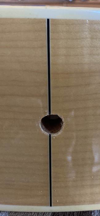

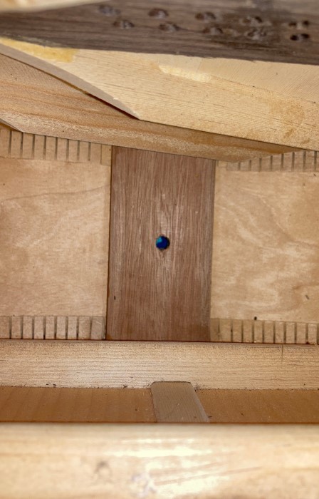

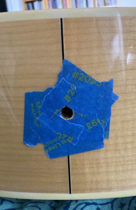

now the worrisome bit started. i'm not a big fan of drilling into guitars because something often goes wrong. in this case i didn't have an intermediate bit to ease through between the 1/2" drill bit and the next smallest one and as a result the hole walked off a little right of center. i taped all around the drilling area to help prevent chipping of the finish.
oops.
oops.
Posts: 14854
it'll be OK when it's installed. a decorative washer covers a multitude of sins. the hole is bunged out to the right but is the same height so i can shove the jack over to the original path and bolt it down.

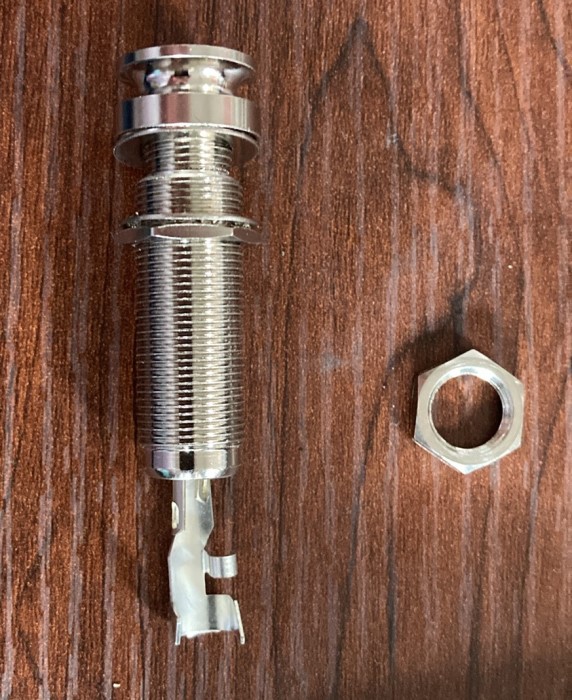

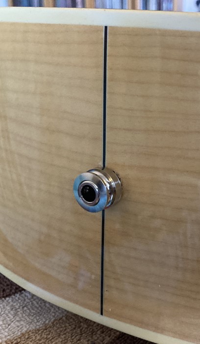

the endpin jack is a neat little device. it can fit entirely through the hole in the end block when disassembled. i figured out that with this i can solder the jack onto the end of the pickup cable, pass it out through the hole in the end block with a nut in place where it'll contact the end block as seen in the photo, screw the washer, nut, and strap button on the outside end and voila. i'll pass a cable through the hole from outside, plug it into the jack, and winkle it out like an ice fisherman.
the strap button is really clever...it's larger than the retaining nut and has a groove hollowed out around the underside so it screws right down on the jack, rendering the nut invisible.
a very well-thought-out device.

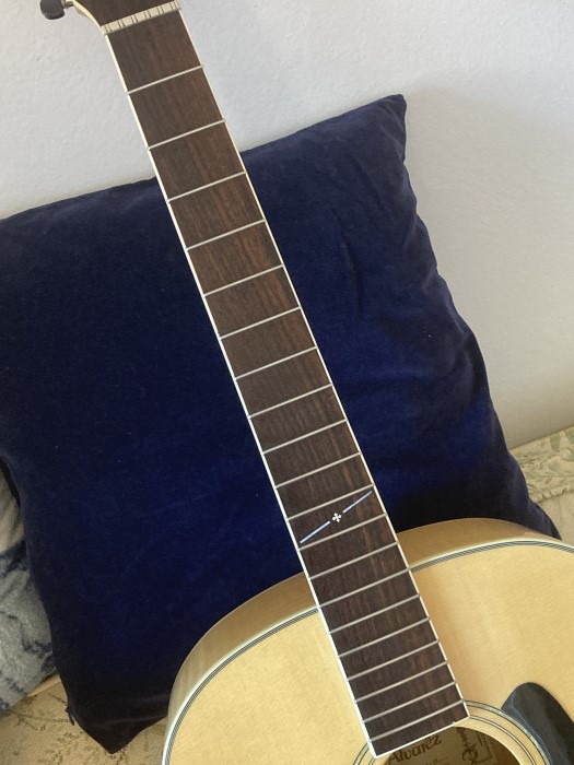

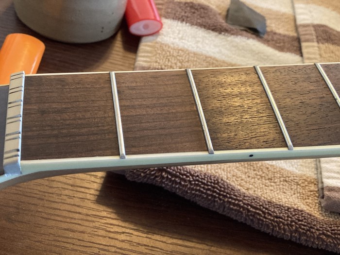

while i was working i noticed how rough the fingerboard was compared to my nicer guitars. the last time i worked on this guitar i sanded/polished the bridge so it looks good, but didn't feel up to tackling the fretboard because i knew from doing the Musima neck that it's a long, exacting process. but i have the strings off so i can install the pickup so they aren't in the way, and i figure this is the last time i'll work on this guitar in my lifetime because there's nothing left to do so i might as well make it as pleasant as possible to play and look at. i'm using the same process as before, 800 grit followed by 1200. i could go to 2000 but that seems pointless when there'll be strings scraping on it. one hangup was being able to keep things even near the frets, where the wood ends up less smooth. solution: wrap a bit of sandpaper around the blade of a butter knife with a straight top edge. once i saw the difference i knew doing the sanding was the right choice.
i work each space until i can't feel any irregularities when i run my finger across it. yet another project thing where i tell lazy me that the end result will be worth the effort.

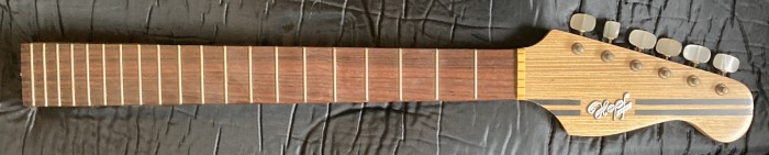

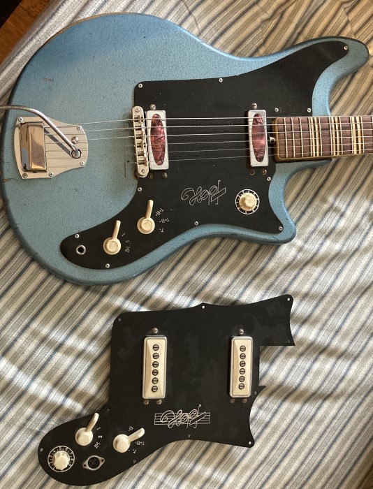

I unpacked the Hopf parts this morning when i got home. the neck is in really good condition; it has a bit of fret wear which must have happened in storage because the neck's never been drilled for its mounting bolts. the fingerboard is smooth and will probably be perfect after a round or 2 of lemon oil. tuners are stiff and have a bit of play but should be OK. i really like this style of West German neck made up of 2 mm strips of (assumedly) maple laminated lengthwise. one assumes it'll be as solid as a Bavarian rock.
the pickguard/pickups are a bit more complicated. the new pickups are larger than the old ones, and the 3-screw mounting bracket pattern is also broader. i'll file the apertures out and drill new holes. i think i'm just going to swap the pickups...the electronics on the Telstar guard are laid out differently than the Twisty so the can isn't compatible with the body routing and it still has the multi-pin German connector. the switch paddles and knob are in much better condition so i'll move those over too.
i'm still amazed not only that i found a correct neck, but that i found it years ago--what was that, 2020?--and it was still available when i looked in February, and has the tuners and logo and everything. i'm gonna assume that Musikkeller doesn't let Google bots crawl the site. i'm going to let it sit for awhile until i sort the Alvy and the Kondor; maybe i'll flip a coin to decide whether to do the Hopf or the Gretsch first. both have pickups i love and haven't had before. i played the Double Jet a bit before i disassembled it and the TV Jones Filtertrons are as good as people say they are.

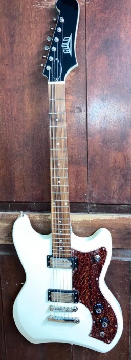

you might recall that one of my long-term project wants was a guitar in the configuration of a Guild Aristocrat (smallish, mostly hollow) with Guild mini-humbuckers and a Guildsby. backstory: in the earlier Buffalo Springfield Stephen Stills played a Guild DE-400 Duane Eddy signature model with these pickups, and i believe they're a big part of their sound. you can see Stills playing the big blond Guild in the TV clip from Hollywood Palace. they have a unique kind of compressed POP to the pick attack that makes you sound like you're pumping a tube compressor. naturally the original Duane Eddy guitars are $5000 worth of rare, so the Aristocrat idea was a way to get that general sound in an affordable setup. i really didn't like the idea of chopping up an Aristocrat, though...they're really nice guitars, and deserve more respect than that. i won't even put a Bigsby on my Aristocrat...it wouldn't be dignified.
so i was browsing DeArmond guitars on Reverb hoping for a sighting of the extremely rare DeArmond DE-400 type when i came across this little guy. it's a DeArmond M-75T that came stock with the little-loved DeArmond 2K pickups, which tried more to look like Dynasonics than sound like them. i was taken by the extremely cool blue sparkle finish, which i've never seen on one of these before. but what's that huge plastic backplate concealing?

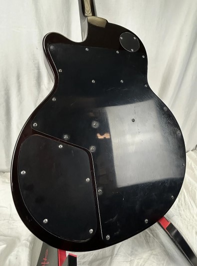

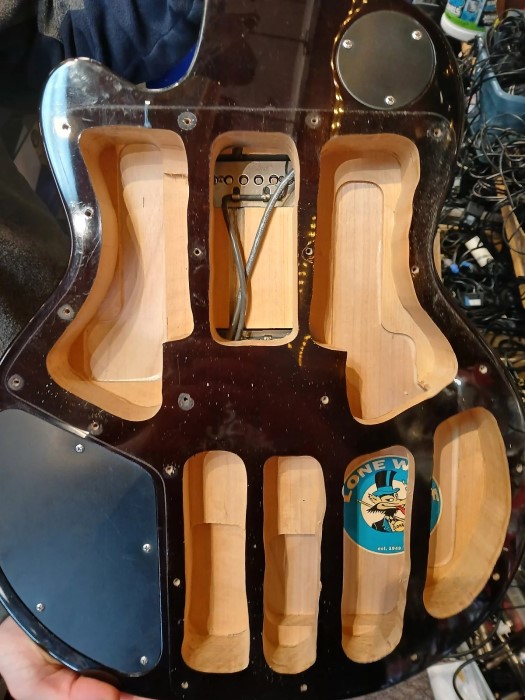

The DeArmond M-series guitars are notorious boat anchors, the sort of thing that makes 2000s Les Pauls seem light in comparison. so some intrepid madman with a home routing setup chambered huge areas out of the back of the body "for weight relief." i'm sure it helped; it certainly couldn't have made things worse. there may be enough resonating space in there to give it some acoustic qualities. i'm going to see how it feels, and may go even farther by removing the interstitial spaces in the lower bout so everything from the waist to the control cavity is one hollow chamber. that's how Aristocrats and Gretsch Duo Jets are traditionally built, a mahogany center slab that's mostly routed away except for a thicker piece that supports the pickup assemblies and bridge. Duo Jets rout the slab and then add a maple top; Aristocrats have a body rim with a thin mahogany sheet back perhaps twice the thickness of an acoustic guitar back.

so what about the pickups? original 60s Guild HB-1s--aka Anti-Hums, not to be confused with later HB-1 full-sized 'buckers--are sickeningly dear; like $600 a set and up. Guild was selling the modern version, the LB-1 "Little Bucker," on the parts page of their website as well as the B3/B5-style Guildsby i wanted for the Aristocrat conversion but stopped and now only sell the pickups and tailpieces appropriate for the later double-cutaway Starfires. OK. how about used pickups? not found. OK, they put these on the Jetstar, which is one of their low-end solidbodies...what does a used Jetstar go for? so i plonked around and found this on eBay for the princely sum of $315. LB-1s present and accounted for, a rather groovy MOTS pickguard, and some truly peculiar figuring in the fingerboard.

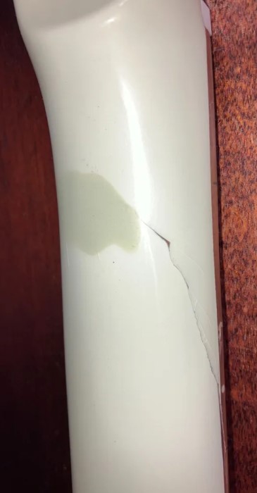

well, mahogany necks do mahogany neck things, especially when the scarf joint gets hit just right. the seller is a Guild warranty repair shop, and swears the neck repair is solid. maybe. we'll see. but given that the modern LB-1s were going for over $200 a set from Guild, i figure i bought two pickups and what either may be a neat little death weapon or a $125 piece of firewood. the LB-1s definitely will go in the M-75T. if the Jetstar neck is sound i'll sand, fill if necessary, and repaint it. i have a Hagstrom-style tremolo from the failed Musima project in the parts box which is period-correct for funny-shaped Guild solidbodies and will only require a little Dremeling. the easiest thing would be using the DeArmond 2Ks, but as surface-mounts they're not really suited for the routs. on the other hand, Firebird pickups, which i love and don't have, would probably pretty much drop in. once i get that going i'll think about odd wiring ideas. if it works well, the JetFireStarBird could be every bit as utile, and every bit as dangerous, as the M-75T.

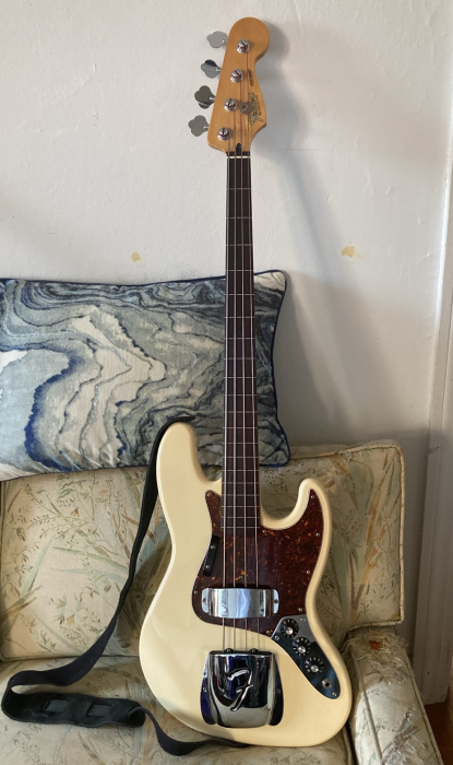

remember the fretless Jazz Bass with the neck whose truss rod was maxed out and still was only barely playable? i thought i would have to get the neck steamed and pressed to make it playable but couldn't see a way then, so i put low-tension flats on it and put it away for a year. i got it out yesterday to see what was up and it's improved significantly. after twiddling the string height it now has almost as low action (~3 mm/12th fret) as the CV Mustang Bass which of course has frets. it's not super-slick, but IMO that's appropriate for a fretless JB which really wants to sound like a stand-up with Big Ugly Teeth. i'm incredibly happy that it apparently healed itself. it's not the right bass for a lot of what i do bass-wise--which is why i got the Mustang--but it's fabulous for faux upright and can edge into Rickenbacker territory with the bridge pickup emphasized and a flatpick.

when i got it it was a bog-standard Mexican fretless JB with a white pickguard and no covers. i added the tortoiseshell pickguard, covers, and thumbrest so it would be as much like the vintage fretless Jazz Bass i learned to play real bass on in the Jazz Improvisation ensemble at City College of San Francisco as possible because that's what i was used to, but it turns out that like most Fender ideas there's a bit of genius behind those covers. they cut EMF interference drastically without affecting the tone at all. they also make it so there's no rough, scratchy, or square-cornered surfaces for your picking arm/hand to encounter, which must have been particularly nice back when jazz musicians invariably wore suits. the Fender amp knobs were inspired by Muddy Waters' Telecaster, and are more practical because you can see the settings without a magnifying glass. not to mention seeing settings at all LOL. the first volume knob broke off of my old silverface Fender Twin in the 1980s, so it's a little connection to my olden days. someday i might go whole hog and get a 3-color sunburst body to make almost a perfect clone, but i'm not quite that vain.

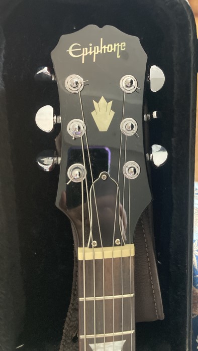

i am, however, vain enough to sand the "SG" lettering off the truss rod cover of the Epiphone SG, which i did yesterday. wet sanding with 2000 grit, buffed in crafts-person tradition with forehead oil and a soft rag. it always bugged me because who needs to be told the damn thing's an SG?

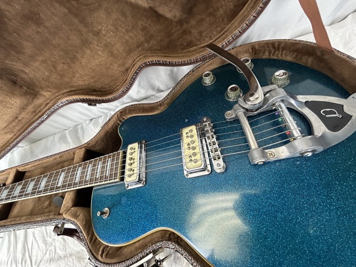

the Guild Jetstar arrived yesterday. i'm not going to do much with it for a little while because refinishing the neck will be a new level of thing for me. the DeArmond M-75T arrives today. i may pull the pickups from the Jetstar and put them in if i have time, but i'm trying to rest up for a vacation next weekend so i don't want to beat myself up too badly and i burn out quick on projects any more.

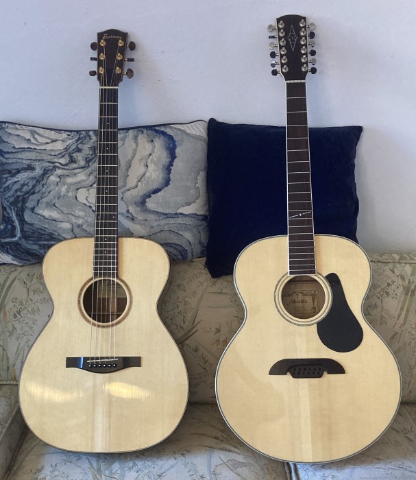

as part of the finishing-old-projects vibe i finished sanding the fingerboard of the Alvarez 12-string. it came out really nice, especially after it and the bridge got a lemon oil treatment. while i was about dealing with acoustic guitars i got out the Eastman OM, which desperately needed new strings, and gave it a dose of lemon oil and a general cleaning. i also polished the rosewood truss rod cover with 800/1200 per standard Bob practice. i love that little guitar.
eastman and alvy 6-21-24.jpg (96.59 KiB) Viewed 4092 times
i'm really happy with how it came out.

i did delve into the Jetstar enough to answer a couple of necessary questions for my plans. Firebird pickups should be fine...the mounting rings are slightly smaller, but within a 1 to 2 mm range so the Firebird rings should cover the LB-1 rings' mounting holes. and the Musima/Hagstrom tremolo will just barely fit. it's 4 mm shallower than the body (34 mm/38 mm), and a modern Jetstar with a Hag trem was storyboarded in the late 10s but never appeared. i only have to sink a cylindrical hole big enough for the spring mechanism to fit, and i can do it if i'm careful. so the next things for the Jetstar will be refinishing the neck and deciding what pickups to get. for aftermarket shit i lean towards Duncan Antiquity, but that'd push that project $280 down the road. i have a feeling the JetFireStarBird is going to kill. the neck is a really comfortable shape, and i'll probably fine-tune it when i sand the neck which is necessary because there's big cracks in the finish that weren't filled and smoothed when it was repaired. it seems quite solid, though.

I spent a bunch of time over the weekend working with the M-75-T. I decided to give it a chance to make a case for itself as it is before starting to tear things up. it’s clear that the owner who did the work on it loved it a lot--you can see where the clear coat is worn away on the left upper bout where his forearm rubbed against the finish, and you don't do that kind of routing work 'cause you're bored of a weekend--so i thought if someone else thought that well of it i should give it a fair chance. after a great deal of the sort of endless fine-adjustments of pole pieces, pickup heights, etc. that’s both an incredible pain in the ass and the base of my sound (i always, always adjust the pickups in a very specific sequence starting from the high E on the bridge pickup and work till both pickups are optimized for string-to-pole interaction, the output is balanced across the pickup, and both pickups' output volume is roughly equal) I decided that I rather like the DeArmond 2K pickups. They’re surface-mounts designed by FMIC (Fender Musical Instrument Corporation) for the 1990s DeArmond guitars as a substitute for the vintage-era Dynasonics design FMIC, who produced the DeArmond and Gretsch brands then as well as Guild, was reserving for the high-end Gretsches. They were roundly despised when introduced, especially by vintage Guild enthusiasts, because they don’t sound much like Dynasonics at all. The design is different, purportedly more like a P-90 than a real Dyna, but I haven’t dissected one to verify. However, when dialed in precisely with my bat-like ears the 2Ks sound quite good. They’re odd…there’s a sort of hollow quality to the midrange and the bridge pickup’s bass notes CRACK more than BOOM. They don't sound much like Dynas, or the DeArmond 2000 surface-mount Dyna substitutes they used on some 00s-10s Gretsches (and sound much more like Dynas than the 2Ks), or like the P-90s they were derisively compared to (who insults a pickup by saying it sounds like a P-90? that's like complaining because a girl has nice hips). But they’re a valid voice and make me play different things than my standard shit, which is one thing I look for in pickups (and guitars). they have a kind of mutant cowboy sound, sort of like if Duane Eddy was Jon Langford. They also complement the LB-1/vintage HB-1/Anti-Hum mini-humbuckers in the Jetstar. and there's something Guild-ish about the 2K's sound in some way i can't quite put my finger on. they seem to fit in with the Dynas, weird single-coil pickups, Franz P-90s, and Anti-Hums i think of when i think of Guild. they should be good in spaghetti Western/gybe! territory.
So my archaeology in the M-75 will be limited to potentially doing more routing in the back…it’s lighter than a typical out-of-the-box M-series De Armond, but I don’t believe my scale when it says 8.5 pounds. I also need to crank it up and see what the resonance is like. I ordered a clear pickguard from Pickguardian…the factory ones were black, but I don’t want to cover the finish. there's some odd and interesting features of this and the Jetstar that i'll document as i go along.
I’m going to vintage-ize the Jetstar…the original 60’s versions had a Hagstrom tremolo and bridge. I have a Hagstrom-style tremolo that came from the failed East German junk guitars project from 2012-13 back when all this began, and though the vintage Hag bridges are dear GFS has a similar piece for, well, GFS prices. I’ll pull the stop tailpiece studs and dowel the holes. The trem disassembles by hand so I can do mounting templates by running it through the copier printing on card stock and be able to precisely place the screw holes and the rout for the spring post. The Fender/Kluson-style tuners are kind of crap--the posts are noticeably wobbly--so I may put reissue Kluson Firebird tuners in. they won’t be any worse than the stock tuners, and will be weird and different which I like. You may have noticed.
The work on this one will be patching dings, preparing the neck, and filling/sanding/painting stuff. I don’t have sufficient confidence in my spray painting skills to shoot a whole guitar (no confidence in my skills at all really) but figure I can mask off the neck only and do well enough that it’ll sand and polish out. The dings will get painted by hand using the rattlecan paint from the neck. i may not have spray can chops, but i can sure as hell sand things smooth and polish them.

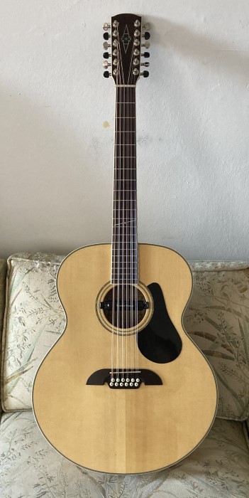

i finished up the 12-string yesterday evening. once i got the jack soldered the rest was fairly simple. i took a guitar cable with plugs the same diameter as the endpin jack, ran it up the guitar's arsehole, and plugged it into the pickup; i was then able to reel the jack through the endpin. getting the final depth placement was a bit tricky, and took 3 or 4 iterations of moving the retaining nut that stays inside the guitar slightly until the bottom of the bit with the smaller-diameter threads that the button screws onto was flush with the outer surface of the body. then i screwed on the outer retaining nut and washer, and the button over that.
it sounds really wonderful. i was almost late leaving the house this morning because i was playing it through the Princeton Reverb with the 'verb and tremolo on and started getting lost in the waves. this is going to really be fun with the pedalboards. but the bestest thing is being able to tune it using an electronic tuner. this alone makes it easily 400% more likely that i'll play the thing. tuning a 12-string acoustically is just horrible.
all told, i'm very happy with how the Alvy turned out. it's going to give me some great functionalities i didn't have before, and the wood work makes it look more like a $700-800 guitar than its actual cost of ~$215 remaindered. if the neck's scarf joint wasn't so obvious it'd be hard to tell.
i think the alternating-tuner-buttons thing is my best guitar idea ever. it really works to help differentiate the strings when tuning, which used to drive me crazy.
alvy done 6-25-24.jpg (60.78 KiB) Viewed 3909 times
