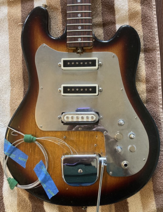

so i decided to open up the Kondor and was immediately confronted with a couple of problems related to installing the Varitone. the control layout was configured thus:
top to bottom: rotary pickup selector, volume, tone
the only way to fit the Varitone and the rotary pickup selector, which are approximately the same diameter, in the pickguard's hole pattern was to move the tone control to the outside bottom. but even after doing that there really isn't enough room for the two rotaries and two standard-sized pots to coexist:

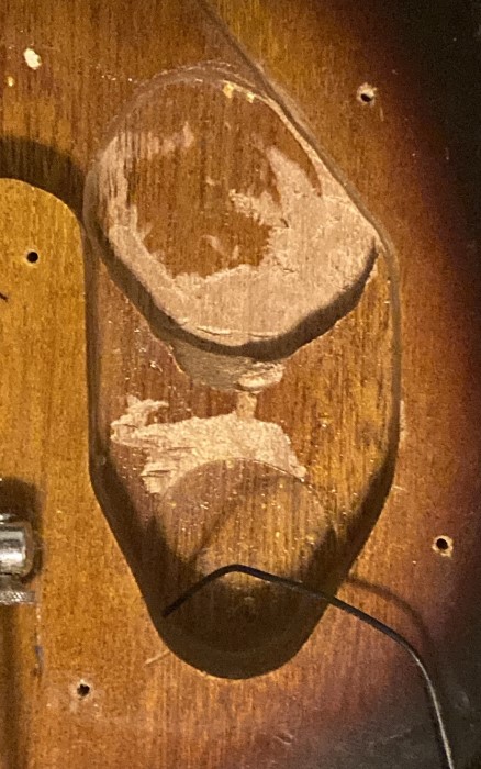

and since the depth of the control cavity isn't consistent, but rather shallow other than the original location of the pickup switch and jack, it's not deep enough for the Varitone which needs the same depth as the switch area.

thus, i'm going to have to order mini pots and carve out at least part of the control cavity so it's deep enough that the Varitone will fit. i'm still concerned about where the inductor for the Varitone is going to go, and it's made with a super-tall shaft length so it's possible it may not work here at all. i'm not going to fuck with trying to cut down the Varitone's shaft and threaded collar, and i can't have the knob sitting 20mm higher than the rest of the controls. if if it just can't fit i'll save it for some upcoming project...it'd probably lend itself well to the Starcaster with real WRHBs or 70s Strat projects i have storyboarded though i don't think it'd work in the Ubertele, and a Varitone plus the tone switch in the Double Jet would just be too many choices. the Hopf already has a Schaller tone switch.

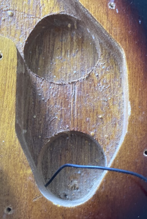

i didn't feel like going out and shopping for hand carving tools last night so i decided to go ahead and attack the control cavity problem with the Dremel and a metal high-speed cutting bit i bought sometime after i stopped working on stuff last time. starting from the cavity photo above, this was after about 15 minutes of work:
i was pleased and surprised at how easy it was physically and how quickly it went. i used my vacuum cleaner's hand hose to periodically suck up the remarkable amount of mahogany dust i generated because otherwise the cavity would have been half-full of detritus. it took about 45 minutes to get to a good stopping point.
i'll be damned, it worked.
the whole cavity is now slightly deeper than the deep parts were when i started. there's still about 6mm-8mm of solid wood left. if i'd had a way to hold it steady i could have routed the cavity with a perfectly flat bottom, but you can only do so much with 2 hands on the Dremel. i checked and there's now enough room for the Varitone to fit. so now i wait till next week for the pots, Bigsby aluminum saddle, and tuner buttons to arrive. that stuff's all coming in one package so there'll be minimum delay.

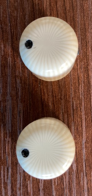

the acoustic pickup was delayed, so i started working on the Köndor. the first thing it needed was indicator dots on the ivoroid Tele-style control knobs i bought because they had a small enough outside diameter to fit the guard. i couldn't use the Dremel because the bit jumped around on the smooth surface, so i took a drill bit and used it to hand-drill concavities in the knobs which i filled with black enamel paint.

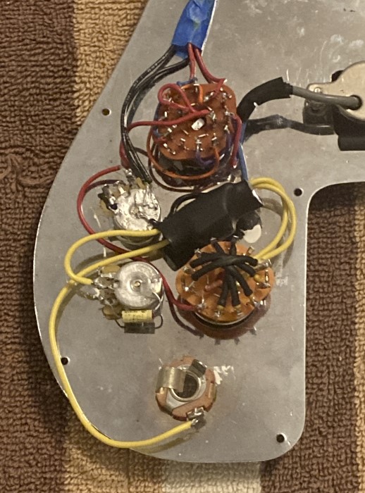

and so it was time to work on the wiring. there's a number of weird anomalies about setting up a guitar with selector, volume, tone, and the Varitone. the first time i tried it didn't pass signal when i hooked it up; i researched an alternative circuit diagram, but with this one the volume and tone controls don't work and the Varitone effect is very muted compared to demos. naturally i discovered this after putting everything back together. at least i didn't put new strings on as i'd intended.

i have an alternative circuit diagram that should work. i literally worked on wiring for 14 hours yesterday, and am well sick of soldering so i'm letting it sit for a bit. since the selectors work i can play it in the meantime. the Bigsby bridge is as i expected a great improvement over the Teisco steel bridge, so i'm pleased about that. one of the cool pointer knobs' set screw socket stripped out so i ordered two replacement knobs so there's a spare. the thing that irks is that it's improving continually and becoming more useable, but it's so fucking slow. i may not get back to it until late in the week...i'll be at Becky's tomorrow night and seeing This Is The Kit on Thursday so i need to cool it. i don't want to burn myself out like i did with my first go at the Double Jet which is in the queue.

upon further examination the only thing that's not functioning is the volume knob. the tone control needs a bigger capacitor; the .022 that's in there isn't nearly enough high cut. happily i have a bunch of different caps in the parts box so that won't be a problem. it probably wouldn't hurt to go higher than the typical .047 value. the Varitone works fine, it's just more subtle than anticipated. i presume the rather quiet, woody pickups may contribute to that since they're very upper mids/treble-heavy and don't have a load of bass content that stands out when the treble is cut. i think i know what else to do to get everything working properly...i played with it last night and it was wonderful even though i need a screwdriver to turn the pickup selector switch. i'm hoping the rewiring will make both tone cuts more apparent. i think there's some kind of weird feedback thing happening where the way something's grounded counteracts the tone cuts.
