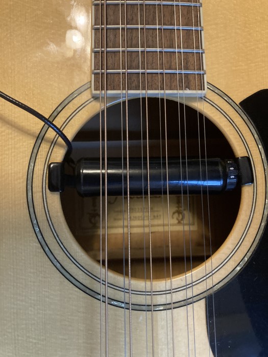

i got the Tube working, but it was tricky. because it's a magnetic pickup without a preamp translating bronze-wound strings which aren't very magnetically active, you have to get it right up against the strings to pick up much signal. i thought it was DOA until i plugged it into a fuzzbox and got a subdued but present signal. it's good for an acoustic pickup, without any of the annoying aspects pickups usually have. it doesn't quack, and it's not that metallic. it could pass more bass for my taste, but that's what amplifier knobs are for and amplified acoustics are notorious for emitting bass-range feedback so it's better to have the bass attenuated like that. i have to run it through at least two effects boxes before it's not obviously an acoustic guitar. but when you hit it with fuzz and chorus it's instant Ride. so i'm calling that a success and will look into a 1/4" endpin jack. if i start playing acoustic outside the house again i'll get 2 more for the other 2 acoustics. for now i'll just let the cord flop...no sense in taping it to the top if it won't be there long. perhaps a Rangemaster or similar device would be good.

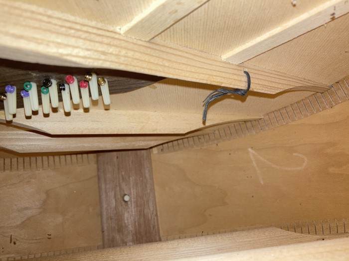

stuck my phone down the soundhole of the 12-string to see what the endpin jack situation might look like. happily it looks like the end block is less than 3/4" deep so all i'll need to do is tap the endpin out from inside, drill out the hole, and run the pickup cable out to solder the leads. i was worried the end block would be like an inch and a half deep...this guitar has been rock-solid since i got it in the mid-00s and has been tuned to concert pitch the entire time so i kind of expected it'd look like the Maginot Line in there. only 12-string i've ever seen that shrugs off that 1600 lbs. of tension or whatever it is like nothing. i think i've adjusted the truss rod once. bog-standard light-gauge acoustic strings. the endpin jacks are made with a flange on the outside so it shouldn't require more than a nut and washer inside to secure it. i have no idea why there's a hole drilled in the brace with what looks like a piece of string looped through it, but it'll be handy for securing the cable inside the body so it doesn't rattle around. perhaps that's the intention.
the site won't let me do more then 3 attachments a post, so see below for Kondor progress, such as it is.

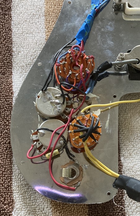

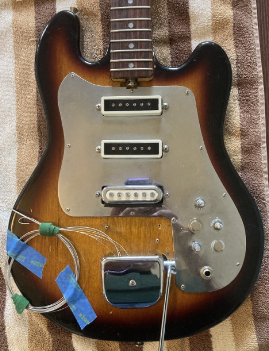

so i decided to open up the Kondor and was immediately confronted with a couple of problems related to installing the Varitone. the control layout was configured thus:
the only way to fit the Varitone and the rotary pickup selector, which are approximately the same diameter, in the pickguard's hole pattern was to move the tone control to the outside bottom. but even after doing that there really isn't enough room for the two rotaries and two standard-sized pots to coexist:
and since the depth of the control cavity isn't consistent, but rather shallow other than the original location of the pickup switch and jack, it's not deep enough for the Varitone which needs the same depth as the switch area.
thus, i'm going to have to order mini pots and carve out at least part of the control cavity so it's deep enough that the Varitone will fit. i'm still concerned about where the inductor for the Varitone is going to go, and it's made with a super-tall shaft length so it's possible it may not work here at all. i'm not going to fuck with trying to cut down the Varitone's shaft and threaded collar, and i can't have the knob sitting 20mm higher than the rest of the controls. if if it just can't fit i'll save it for some upcoming project...it'd probably lend itself well to the Starcaster with real WRHBs or 70s Strat projects i have storyboarded though i don't think it'd work in the Ubertele, and a Varitone plus the tone switch in the Double Jet would just be too many choices. the Hopf already has a Schaller tone switch.

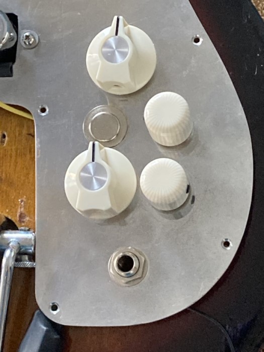

this is the proposed control layout with the Varitone in the bottom left spot and the volume and tone controls to the outside. the Varitone and tone knob are rather crammed together, but i think the tone knob would still be useable since its most likely use case would be to lop off the high end altogether rather than for subtle adjustments. it would make a certain amount of sense to remove the tone control and just use the Varitone like the way the Hopf (like many other Schaller-equipped German guitars of the time) is set up, but i really like being able to kill the high end with the knob when the fuzz gets unruly--the Tone Bender MKIII is particularly fizzy--and i'm not a fan of removing possible functions unless i have to. i'll have to think about this a bit more.

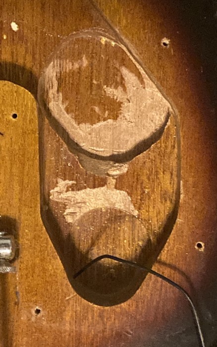

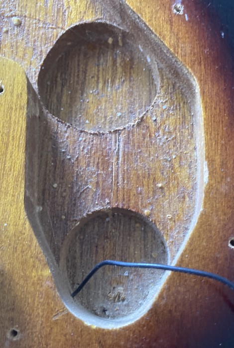

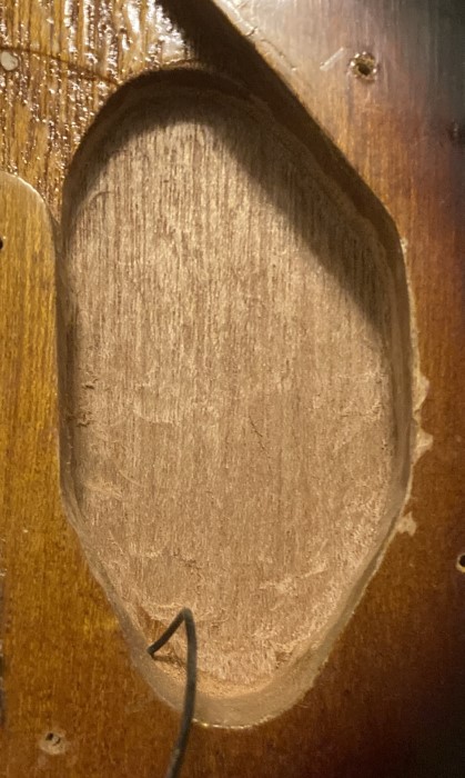

i didn't feel like going out and shopping for hand carving tools last night so i decided to go ahead and attack the control cavity problem with the Dremel and a metal high-speed cutting bit i bought sometime after i stopped working on stuff last time. starting from the cavity photo above, this was after about 15 minutes of work:
i was pleased and surprised at how easy it was physically and how quickly it went. i used my vacuum cleaner's hand hose to periodically suck up the remarkable amount of mahogany dust i generated because otherwise the cavity would have been half-full of detritus. it took about 45 minutes to get to a good stopping point.
the whole cavity is now slightly deeper than the deep parts were when i started. there's still about 6mm-8mm of solid wood left. if i'd had a way to hold it steady i could have routed the cavity with a perfectly flat bottom, but you can only do so much with 2 hands on the Dremel. i checked and there's now enough room for the Varitone to fit. so now i wait till next week for the pots, Bigsby aluminum saddle, and tuner buttons to arrive. that stuff's all coming in one package so there'll be minimum delay.
i'm extremely happy that the Dremel works so well. i feel much better about working on the Duo Sonic now, and will probably extend the neck pickup cavity on the Double Jet as well...due to the design of the mini-Gretschbuckers installing a Filtertron in that rout requires notching the pickup ring about 3mm to clear the end of the fingerboard. i was going to just live with it, but since the Dremel works so well i think it'll be fine and will definitely look correct when it's all done. if i wasn't so tired i'd go after the DS today, but i really don't feel like spending another couple of hours hunched over the coffee table. i'd rather test the Hammond AO-35 amp with the Yellowjacket solid-state rectifier i got in with some of the Kondor parts. when i go to order something for a project i always check the website/listings for other utility bits i may need. i haven't even switched it on yet. assuming i get through the Duo Sonic before the Kondor and Alvy parts arrive i'm going to go over the bass setup, re-adjusting the Mustang Bass which currently is set up really stiff because i tend to overplay with my right hand and make things rattle on the fretboard, and that's only exascerbated by the short scale. the Jazz Bass takes pounding much better. there's also more effects testing to do...i have a BEZ FX Street Sweeper foot-controlled phaser i haven't used in ages which i need to evaluate for possible use, and i'm probably getting a Seppuku Memory Loss to feed my jones for weird distorted delays. i'm thinking about some sort of stand or rack that would let me get certain pedals, particularly the SMMH, up off the floor where i can reach them because i tweak with the SMMH a lot. problem is, that makes it hard to use the SMMH's loop function which is really fun to combine with layers of reverse echo. i also need to evaluate the Snazzy FX suite to see if any of them are able to be integrated into the setup and decide if i'm keeping the Alesis MidiVerb II, but those tests require more space and hassle than i feel like dealing with at the moment. i don't want to cover the coffee table with modules or get out/deal with/pull apart the FX rack which hasn't been touched since 2015.

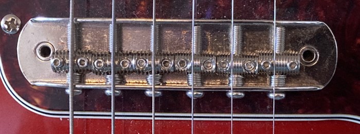

i got the Hopf with the Höfner Galaxie neck and my Jazzmaster out to do some preliminary measurements to see whether the Galaxie neck would be compatible with a JM body. turns out the scale length is 25.5 in both cases and the heel width and depth are quite close. i'll have to cut a notch for the neck's heel-mounted truss rod nut which sticks out 9mm from the fingerboard but otherwise things look good. there's a black anodized aluminum Thurston Moore JM pickguard on Reverb that has the separate control plate, but i'm not sure how hard it'd be to place the pickups in there. might be more efficient to make a separate plate, probably plastic for simplicity's sake, that covers the usual JM routs which i could cut to fit the 511s. i'll look for other JM pickguard options, but the black anodized would be nice because it's quite common on old German-adjacent guitars. i should also look into a custom guard though that gets kind of out of my parts guitar wheelhouse. i'd forgotten how light the Hopf is...it's probably the lightest electric guitar i own and can't be over 6 pounds. it'll be nice to have it in its intended trim with the Hopf 62-style Schaller single-coils which are quite zippy.

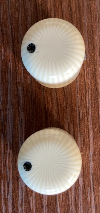

the acoustic pickup was delayed, so i started working on the Köndor. the first thing it needed was indicator dots on the ivoroid Tele-style control knobs i bought because they had a small enough outside diameter to fit the guard. i couldn't use the Dremel because the bit jumped around on the smooth surface, so i took a drill bit and used it to hand-drill concavities in the knobs which i filled with black enamel paint.

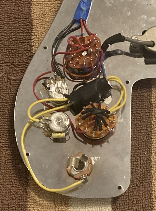

and so it was time to work on the wiring. there's a number of weird anomalies about setting up a guitar with selector, volume, tone, and the Varitone. the first time i tried it didn't pass signal when i hooked it up; i researched an alternative circuit diagram, but with this one the volume and tone controls don't work and the Varitone effect is very muted compared to demos. naturally i discovered this after putting everything back together. at least i didn't put new strings on as i'd intended.
i have an alternative circuit diagram that should work. i literally worked on wiring for 14 hours yesterday, and am well sick of soldering so i'm letting it sit for a bit. since the selectors work i can play it in the meantime. the Bigsby bridge is as i expected a great improvement over the Teisco steel bridge, so i'm pleased about that. one of the cool pointer knobs' set screw socket stripped out so i ordered two replacement knobs so there's a spare. the thing that irks is that it's improving continually and becoming more useable, but it's so fucking slow. i may not get back to it until late in the week...i'll be at Becky's tomorrow night and seeing This Is The Kit on Thursday so i need to cool it. i don't want to burn myself out like i did with my first go at the Double Jet which is in the queue.
soldering still sucks, but the temperature-controlled unit i have now is way better...i only cooked one capacitor, and i had 3 spares. it's still uncomfortable no matter where i set up or what kind of seating i use, and i can't afford one of those Mr. Hands devices that holds the work for you. poor vision doesn't help.

upon further examination the only thing that's not functioning is the volume knob. the tone control needs a bigger capacitor; the .022 that's in there isn't nearly enough high cut. happily i have a bunch of different caps in the parts box so that won't be a problem. it probably wouldn't hurt to go higher than the typical .047 value. the Varitone works fine, it's just more subtle than anticipated. i presume the rather quiet, woody pickups may contribute to that since they're very upper mids/treble-heavy and don't have a load of bass content that stands out when the treble is cut. i think i know what else to do to get everything working properly...i played with it last night and it was wonderful even though i need a screwdriver to turn the pickup selector switch. i'm hoping the rewiring will make both tone cuts more apparent. i think there's some kind of weird feedback thing happening where the way something's grounded counteracts the tone cuts.
