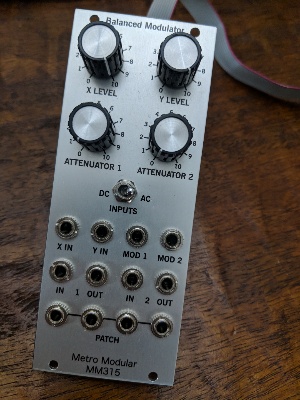

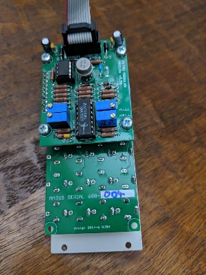

Metro Modular MM315 Balanced Modulator.
Features:
  • -MC1595L based balanced modulation
    -No internal carrier
    -10hp Doepfer 3U Eurorack format
    -Input Level for both Carrier and Modulator
    -AC and DC offset levels
    -4 jack multipule, 2 extra attenuators
    -Well balanced, elegant, and simple
[youtube]http://www.youtube.com/watch?v=gNt0OqxSc5Y[/youtube]
∆AC coupled sounds:
  • -Tremolo drum sounds throughout (more at beginning and end).
    -Balanced mod against phased signals from same oscillator (approx. 2:13 start)
    -Audio rate modulation of audio sample (scattered around the middle)
    -Some additional non-ring mod sounds scattered to fill space
[youtube]http://ww.youtube.com/watch?v=QeaG8d8uT64[/youtube]
∆Audio rate sounds:
  • -Balanced Modulation of two oscillators
    -Oscillator vs. Radio
    -Radio ring mod stuff got layered over
    -Feedback sounds are oscillator balanced modulated against itself with the same waveform
    -All Sounds from mm315 (with a boss re-20 tacked on)
[youtube]http://www.youtube.com/watch?v=57ei6DTF5TQ[/youtube]
∆DC offset sounds:
  • -Complex cv modulation by combining several different LFOs and envelopes via balanced modulation to control amplitude, harmonics, phase and other stuff
    -More of a utility thing than fun
Maybe guitar video?
